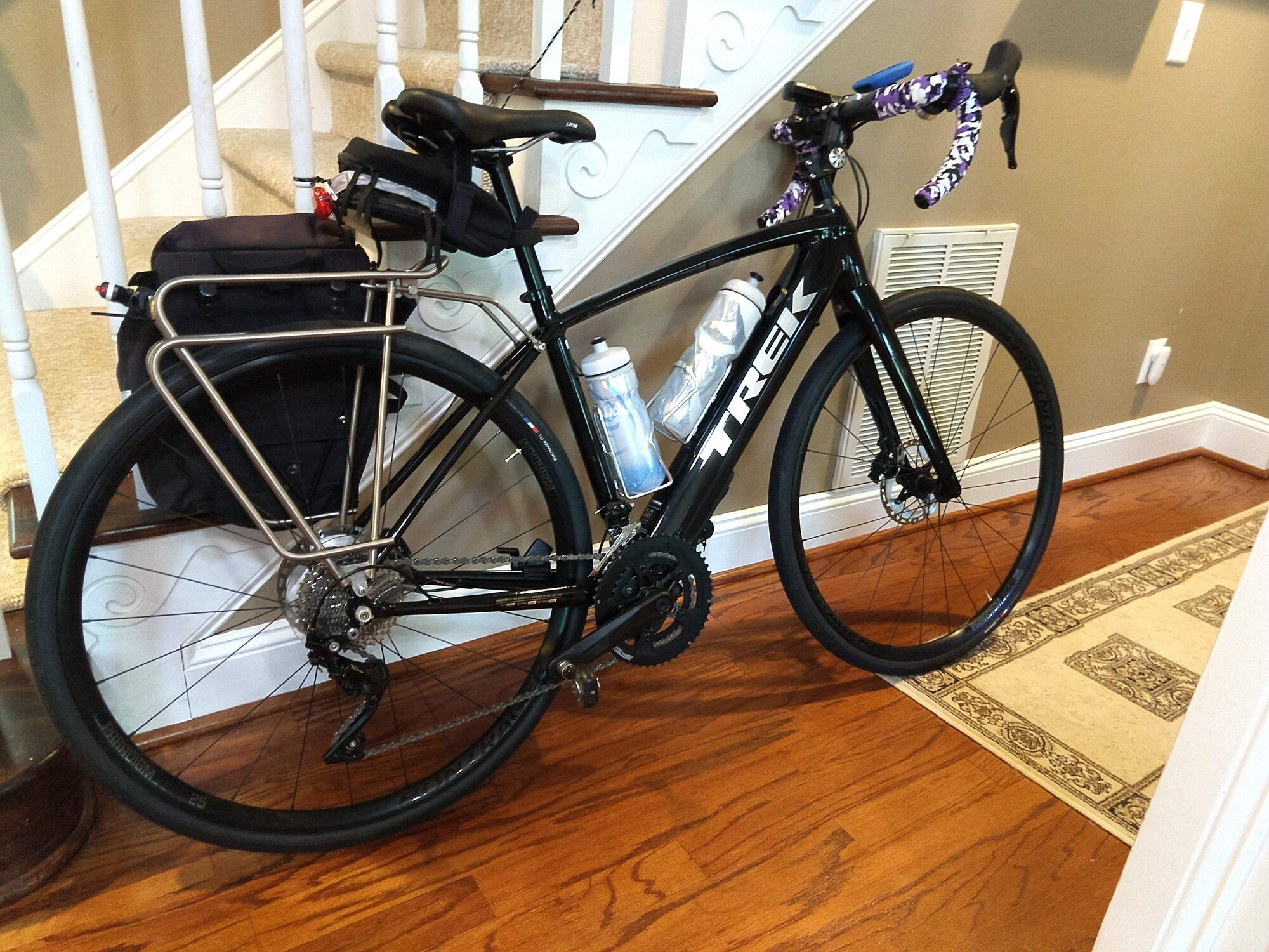

I swapped the 40mm handlebars for 36mm bars - my shoulders are a bit narrow.
I have installed a titanium rear rack, adjustable stem, and purple stem cap.
I bought a trainer axle from The Robert Axle project so that I can put this thru-axle bike on a trainer.

@Deacon Blues I got the titanium rear rack from bikeman.com - they are a distributor for Carver Bikes, the manufacturer of the rack. http://carverbikes.com/parts/accessories/ti-raq-rear-rack/ My wonderful husband did bend the titanium stays with a bench vise for me. I used poster paper and a protractor to mark where to do the bend on the stays and measure the angle needed. You can see in 1st picture that I haven't cleaned off the sharpie marks yet.
I used instructions for a similar-looking Tubus rack to install and used their torque recommendation. I used 2 M5 10mm bolts and 2 M5 16mm bolts (stainless), and a collection of lock washers and washers. I needed more washers on the non-drive side bottom connection point, to clear the bike frame.
