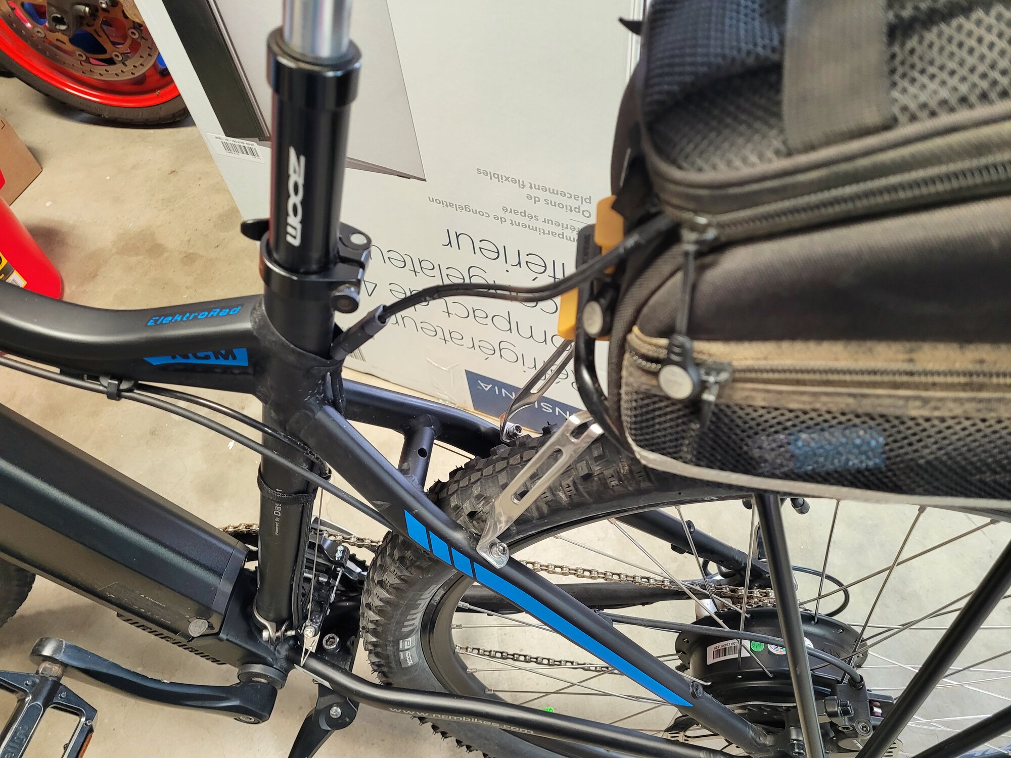

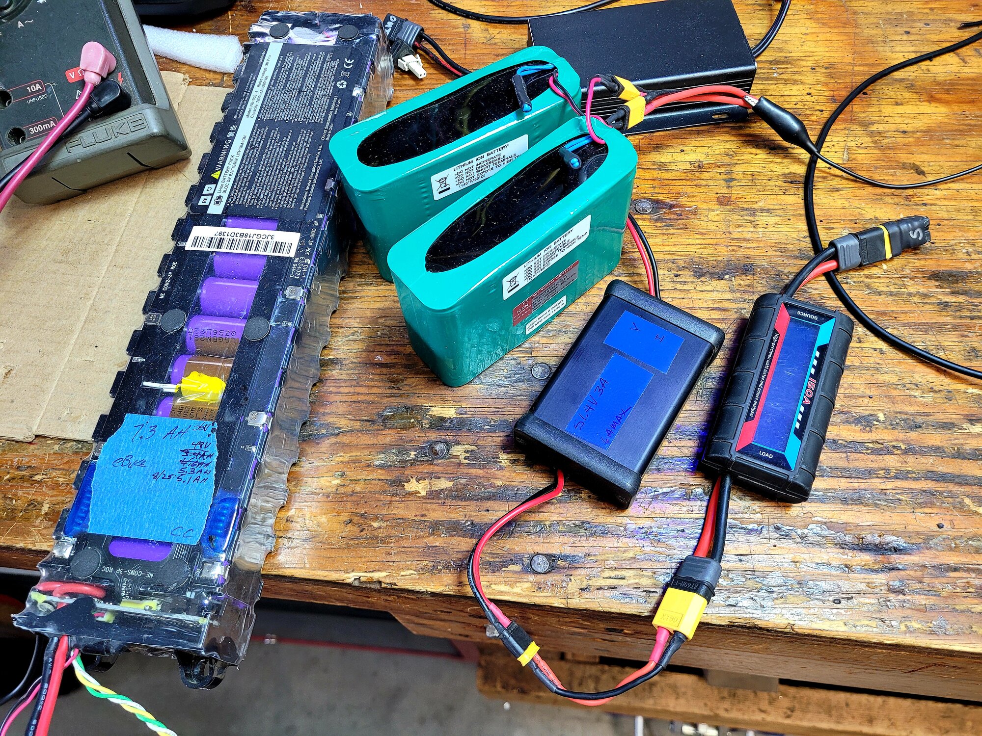

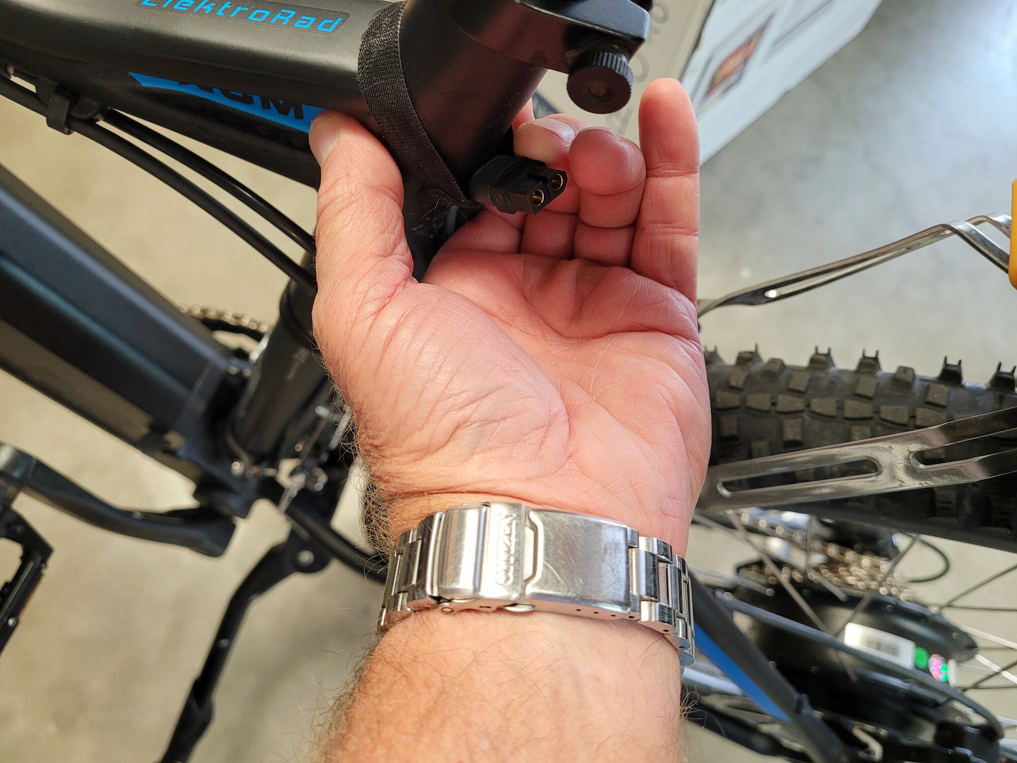

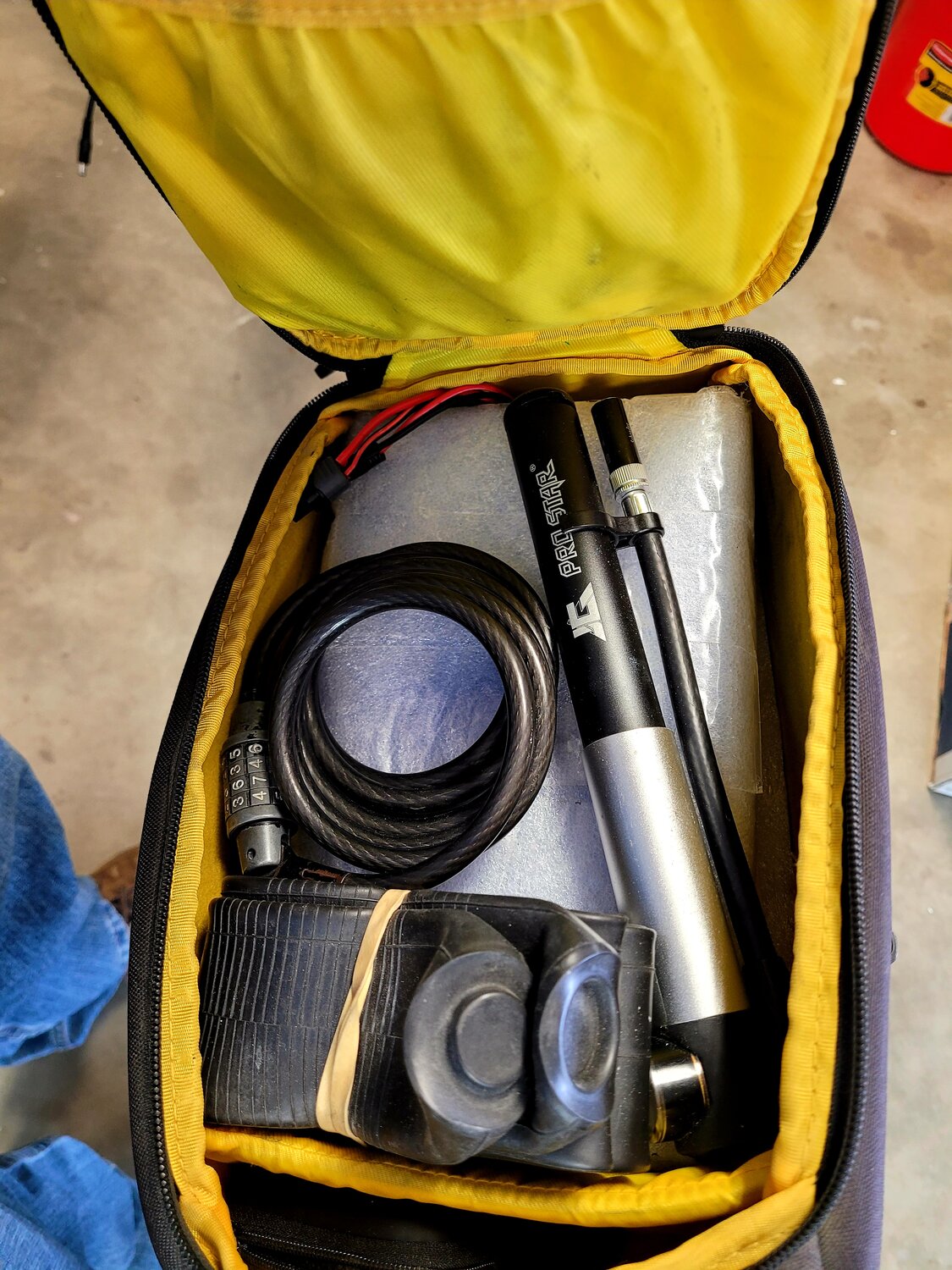

Some of my longer (40-60 mile) on/off road rides that include 3K+ elevation change consume 20 - 40 AH of battery. Although not as elegant as the built-in battery, I add what capacity I think I need each ride in my rear rack pack and parallel to the main battery. I can also run with the main pack removed on some of my bigger packs. Other smaller packs that add 5-10 AH extra capacity charge the main battery as I ride through the XT-60 port I hard wired into the main battery harness using a DC-DC converter. You need to know what you're connecting but no major issues after 9 months of use.
