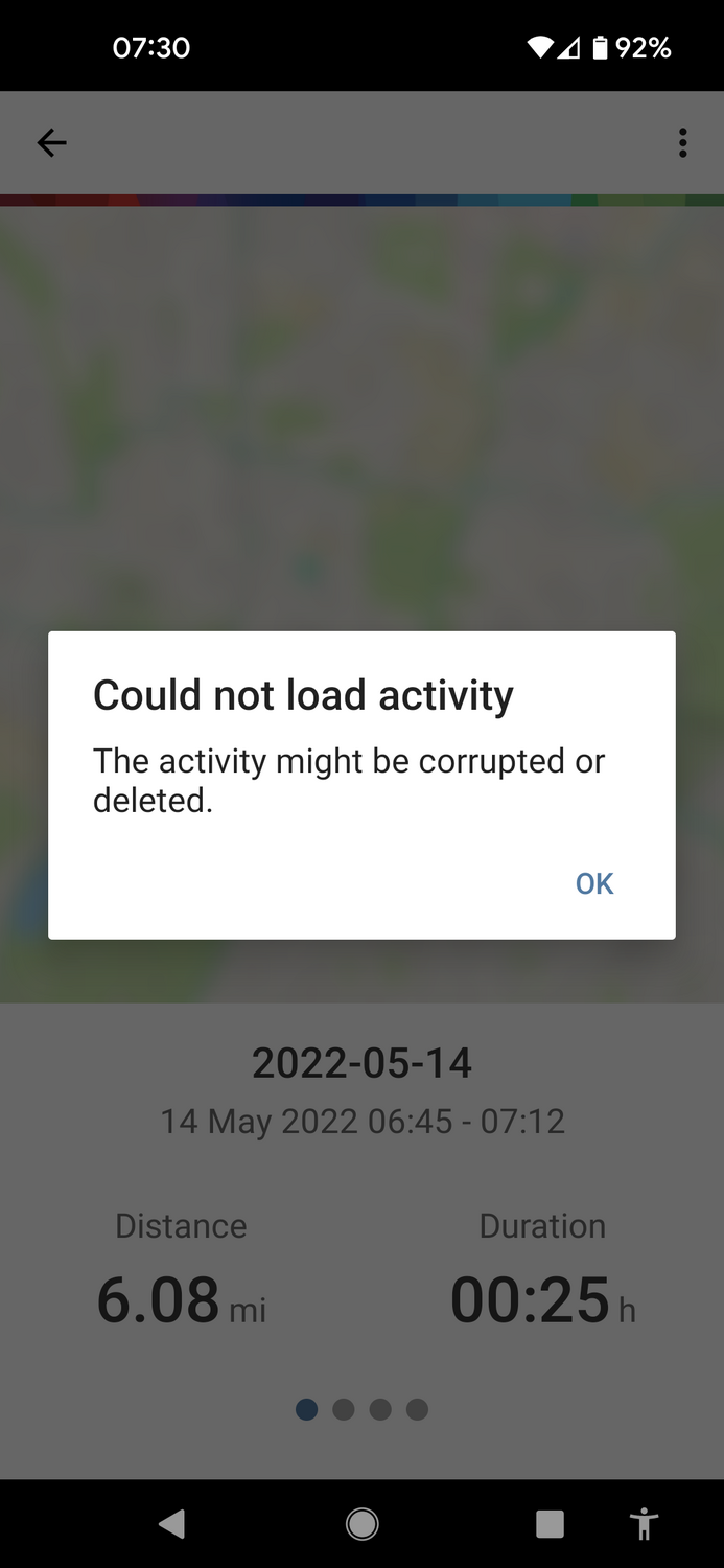

Looks like it's continued to be a disaster zone, the ebike connect service has fallen over, it's still offline 15 hours on, my android app got corrupted as a result and I need to uninstall and reinstall, just to stop it crashing repeatedly on launch, and all rides are shown as corrupted.
1/10 Bosch...
