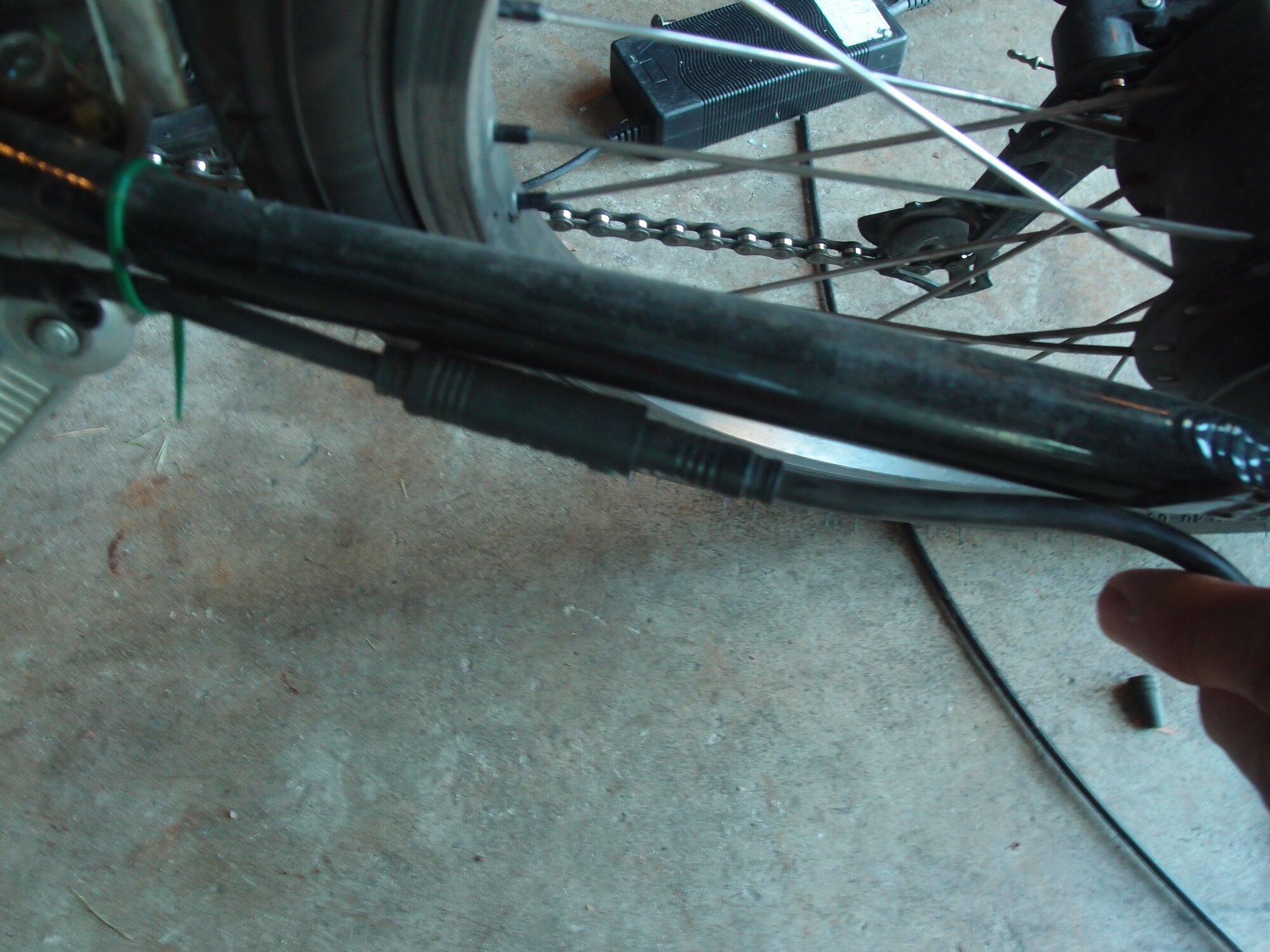

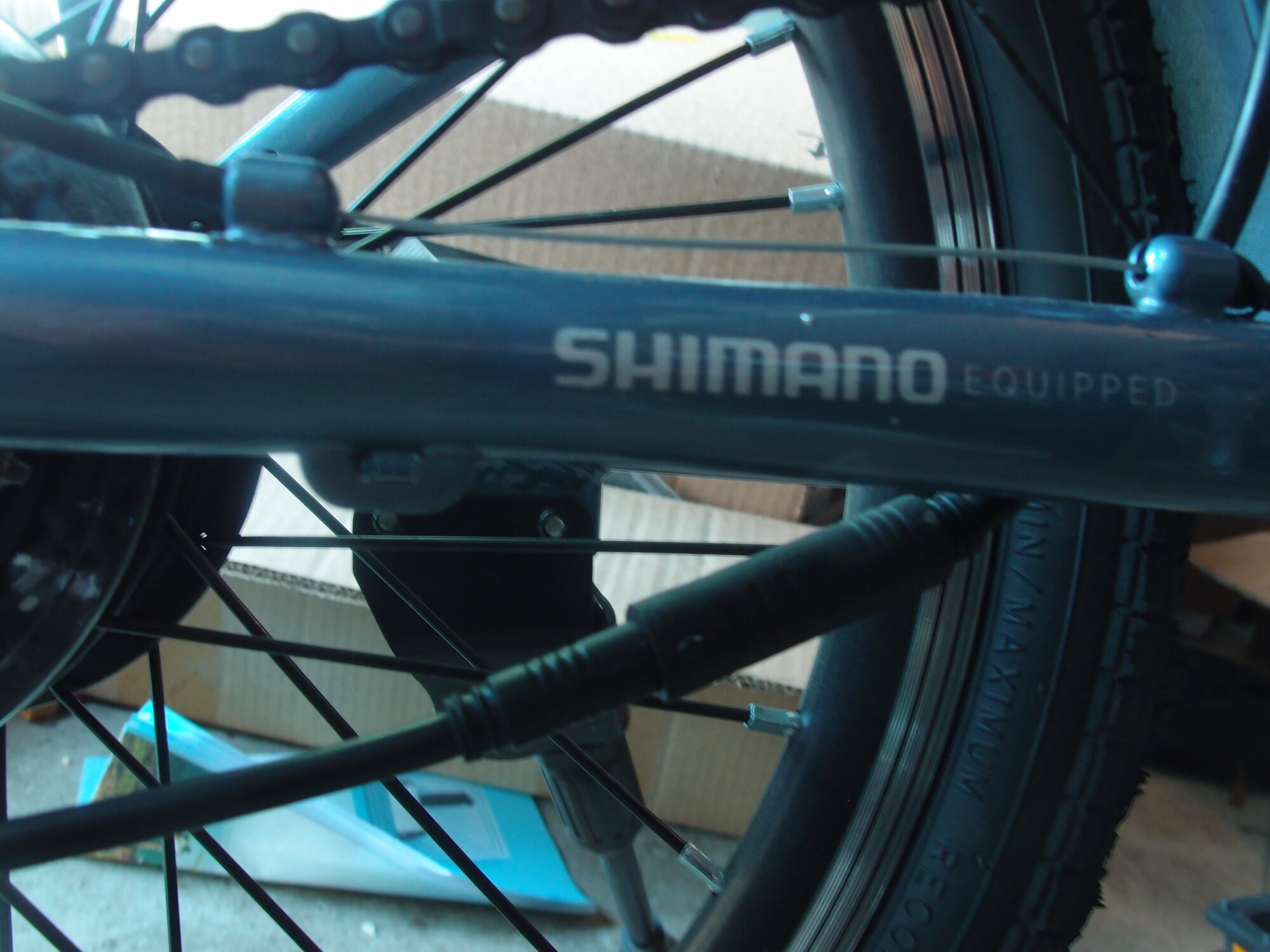

Most new hub motor ebikes now use a connector on the motor cable to facilitate wheel removal for flat tires, etc. It's an extremely tight connector, which means it's often not fully inserted. It has two arrows for alignment. I don't suggest opening it, but maybe give both ends a push. Ancheer may be cheap and not use one, but take a look.
The other thought is did you charge up the battery? They're shipped at partial charge, and if you tried to ride it like that, the bike controller may be shutting down the motor.
One other thing - it DOES deliver power to the wheels in Push Assistance mode. That's the only way it does.

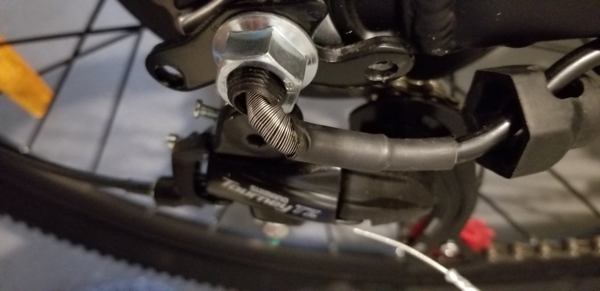

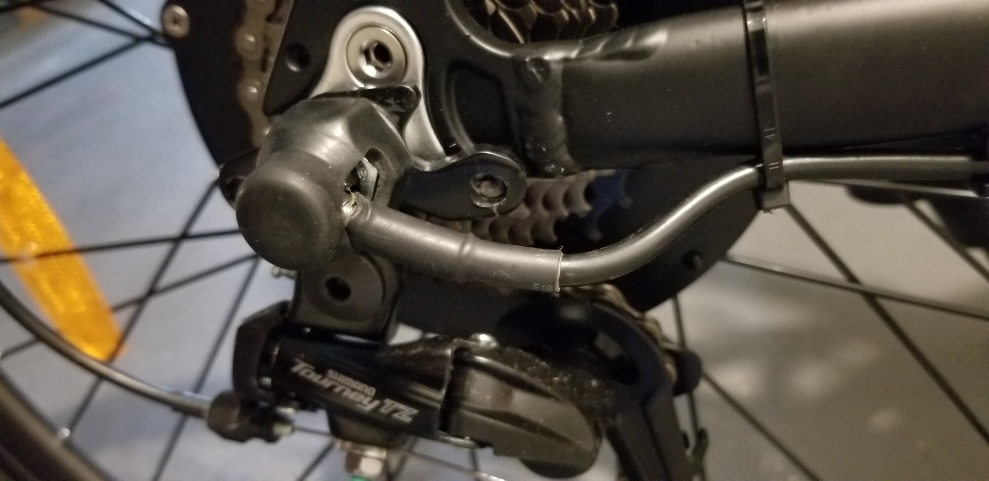

Thanks, harryS. I did fully charge it before its first use, so that's not the cause. It does NOT have that handy connector on the motor cable as per your photo, so that rules that out. I did notice a possible concern where the cable enters the hub, but on close inspection it looks to me like just the rubber housing is a little short there (see photos).

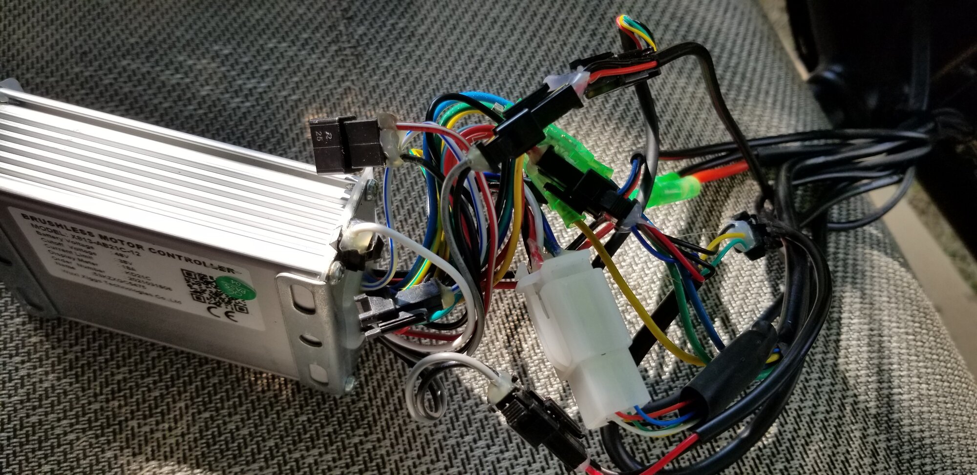

It's not exactly that model. The picture here shows it has all the wires connected in a separate box attached to the seat tube. I opened the box to see if there was anything obviously disconnected, but it looked okay, though I wouldn't know what to do with all that. I bought it on Amazon, from a Chinese reseller that doesn't give much info. So if I have to return it, hopefully Amazon will go to bat for me. No connector on the display screen cable.

Then you have the rats nest I was talking about. An ebike tech would plug and unplug every connector one at a time, so as not to get lost. The bullet connectors to the motor (three - usually yellow, blue, green) could be left alone, Ditto for the red and white power wires on bullets.

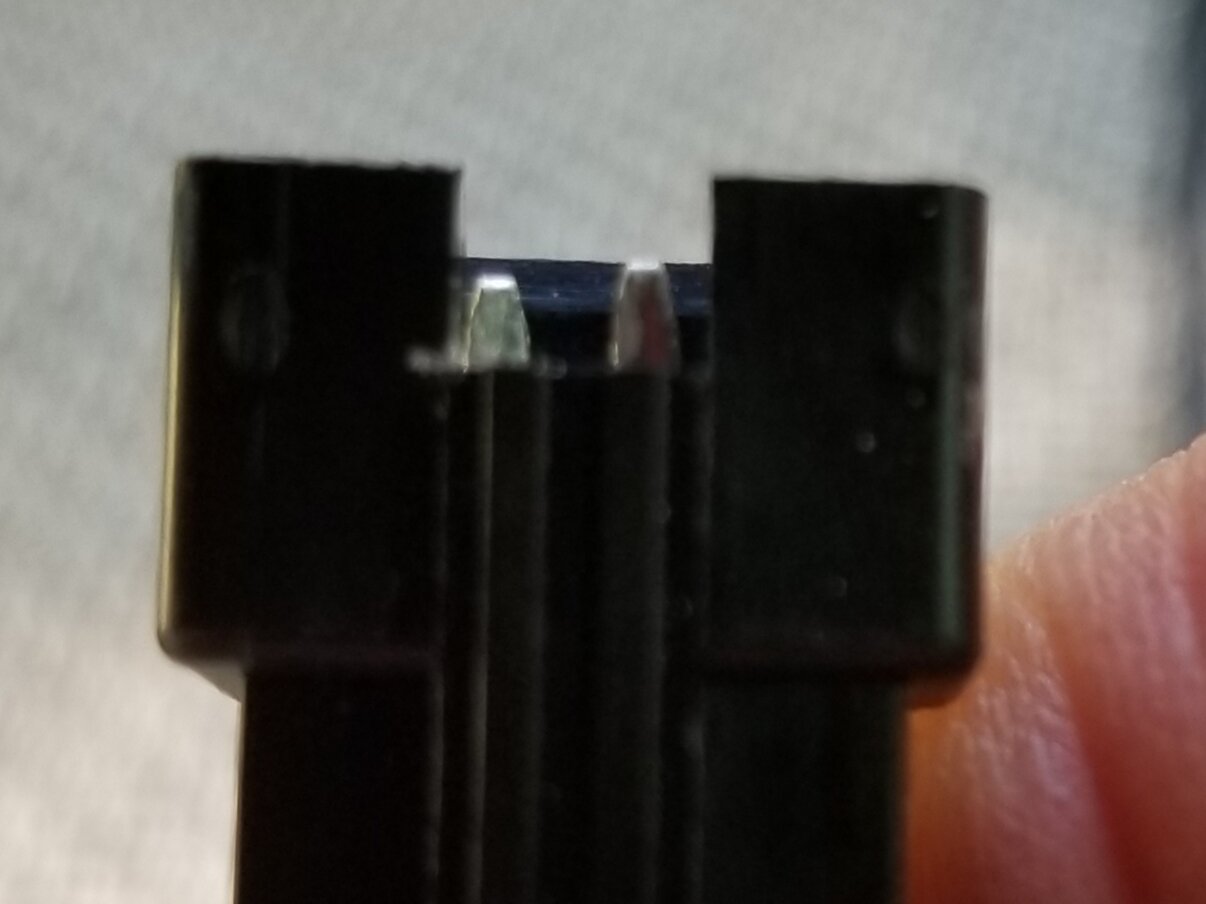

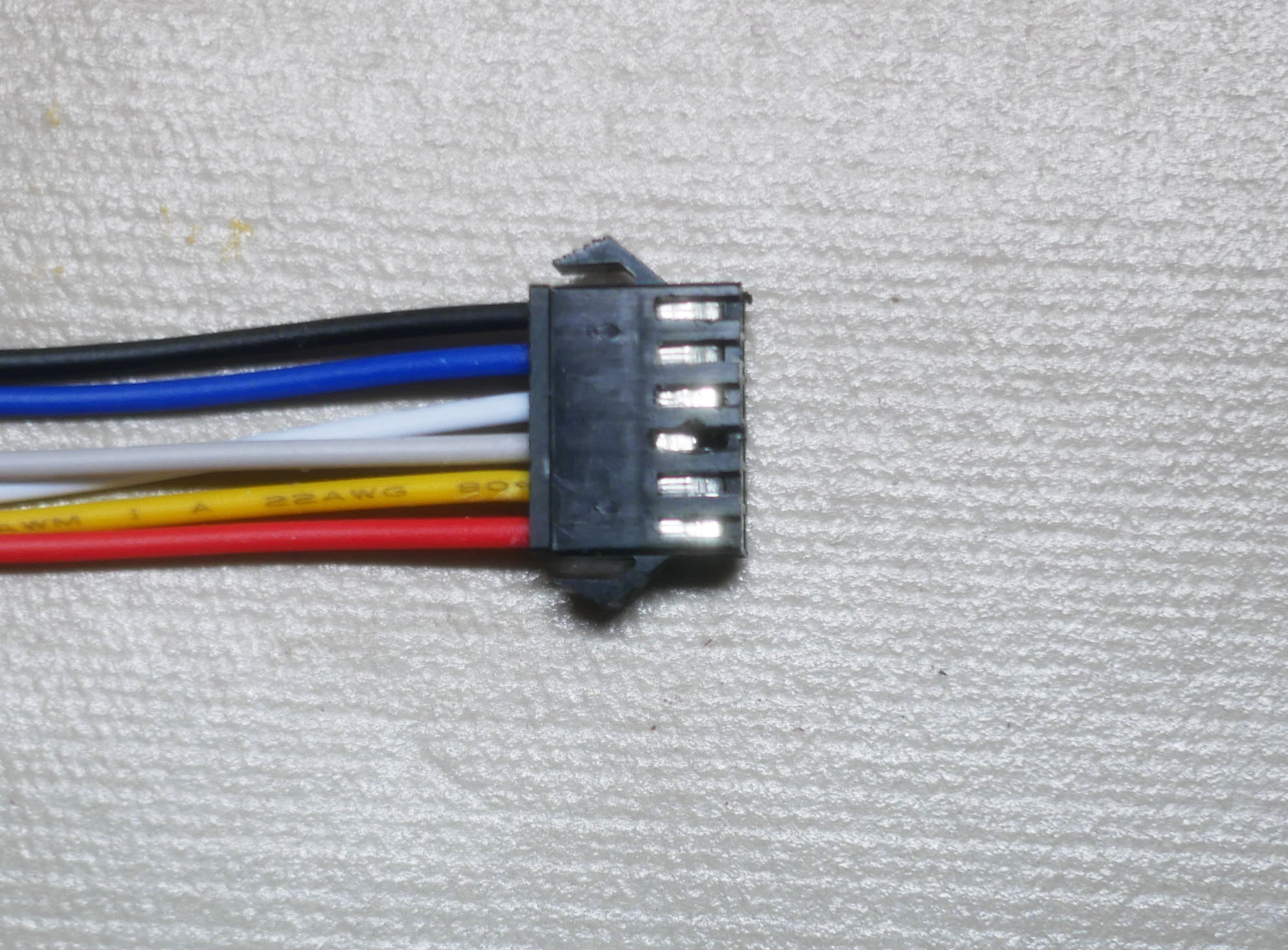

You might look for something like this too when the connectors are apart. Those metal fingers sometimes get loose, and don't make contact. .

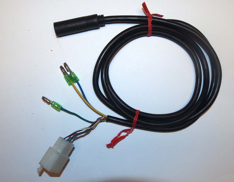

Is there is a big white 2x3 plastic connector, five or six wires on it? Goes to motor cable, and its pins also can get loose. It's on the bottom of this picture which shows a proper ebike motor cable, with the quick disconnect socket I mentioned.

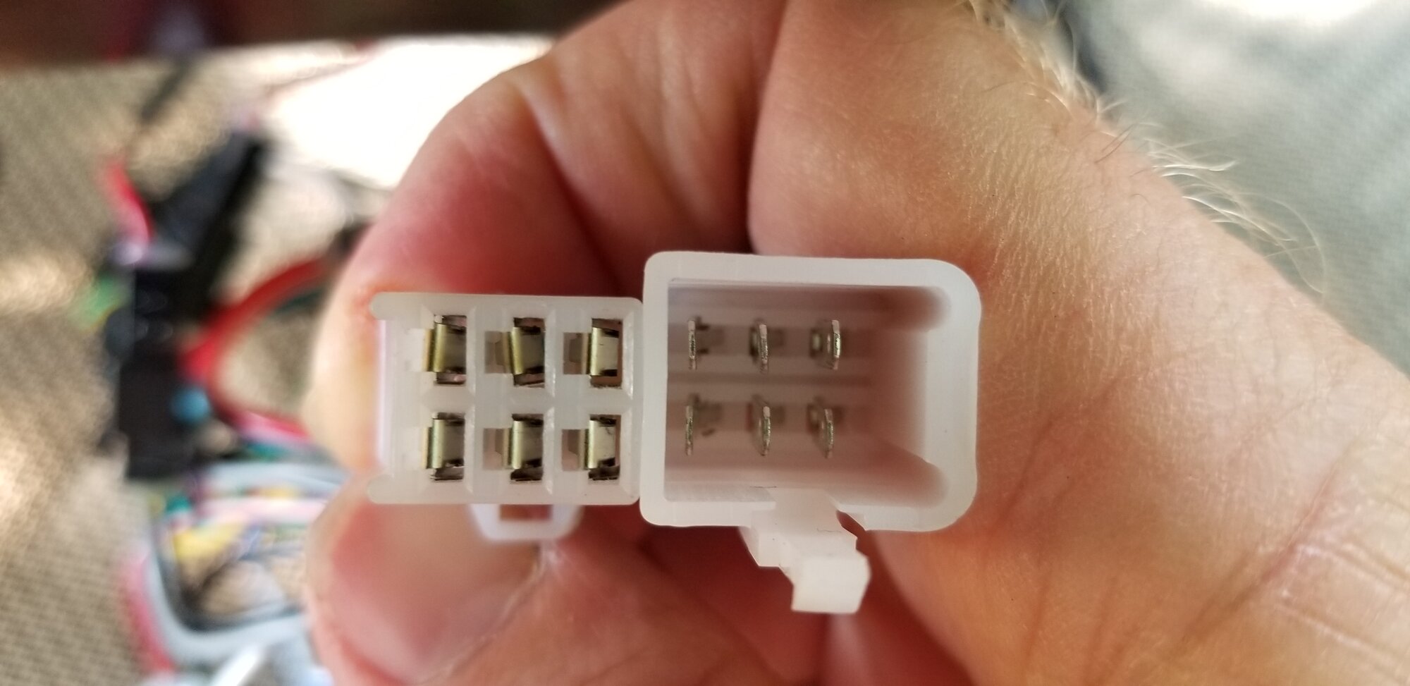

Thanks. It has all the cables you've described. I opened, then reconnected, all the connectors (6 of them), plus the big white 2x3 plastic connector, but not the bullet connectors. I then rode it, and it delivered power assist for about 15 seconds. Then it cut out, and it's back to how it was before - the walking power function works, but no power while riding. Photos here show a connector that's a little crooked, and one finger that's a tiny bit shorter than the others. Those are the only problems I saw. Significant? In any case, that briefly restored power indicates that maybe something I did strengthened a loose connection but it remains too fragile to stay connected for long? I went through the whole disconnect/reconnect sequence a second time, but did not get power back after that. Is it time to learn how to use a multimeter? Replace the stuff in the pictures?
