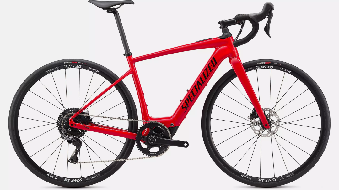

Guys,
I had a chance to straddle that beauty on last Saturday:
It is in size M, the aluminium version. Despite of my earlier fears (caused by wrong geometry listing at the Specialized website for the E5 version), it was very easy for me to straddle the Creo top tube (with ample space between my crotch and the top tube), and it was also very easy for me to dismount the e-bike (perhaps even easier than it is for my Vado SL size M). Regarding the weight, Creo E5 felt of similar weight as my Vado SL.
When I touched the hoods, I felt like a real roadie, and moreover 30 years younger! :)
Decidedly, a candidate for a demo ride for Saturday 20th of November! Questions:
  1. It is a road bike configuration (tyres!) Would anything wrong happen if I took the e-bike for a gravel/off-road ride? Any chance for damaging anything such as tyres or wheels? Should I rather stay on-road?
  2. What are the negative points that owners of Turbo Creo SL Comp E5 could report?
  3. Could the e-bike be later upgraded to more gravel-like configuration? What would that take?
Discuss!

On a DEMO ride, I would not take it on gravel unless you mean DEMOlition!!!! When I demo-ed the Creo (that I ultimately purchased), I mentioned where I would test ride it and they asked me not to go that route since it would probably spray the bike with dirt and grit even though it was a paved alley (but messy). Of course, this last week, riding on rather damp/wet roads after rain, my same bike was really messed up with all kinds of crap - leaf debris, grit, sand.
It is heavier than a carbon version! The shop had a gravel version and I think it is the same bike but outfitted differently - heavier tires (not tyres!) and a dropper seat post. Maybe fenders????

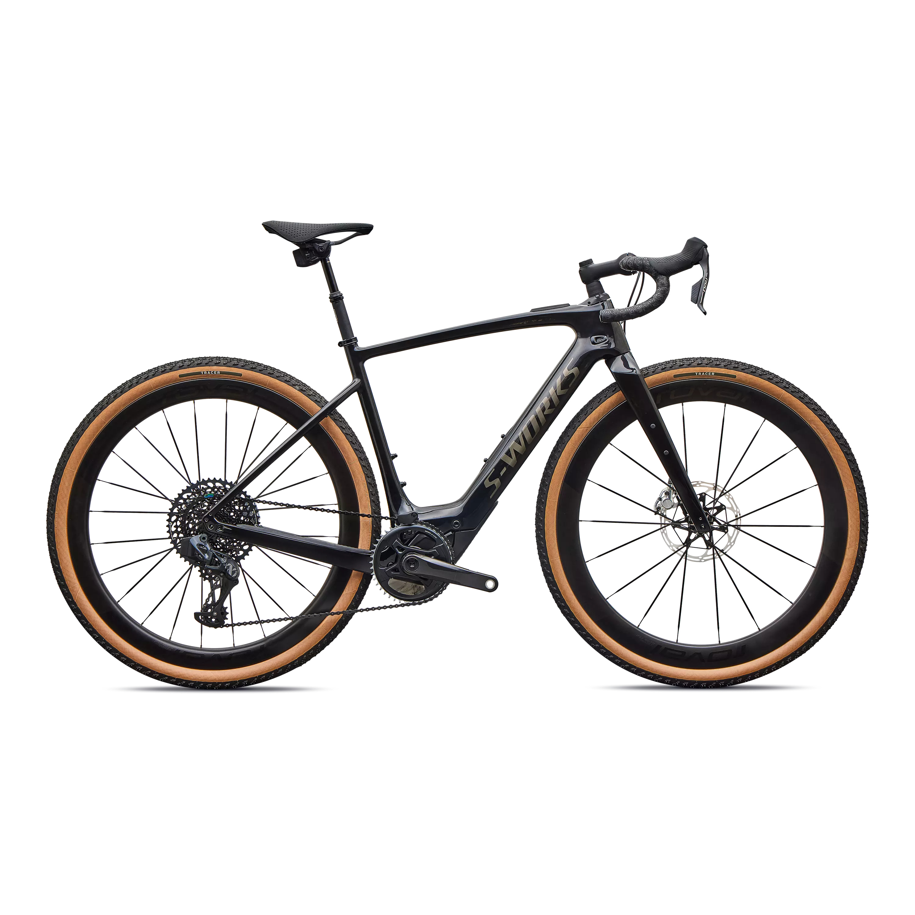

Ah, here's the link where I selected GRAVEL
Thank you so much kahn! No doubt you spared me from a serious trouble!
(not tyres!)
Speak English please :D
I'm aware of it. I'm a humble person and know I couldn't afford the carbon version unless I suddenly sold a large contract at work :) Anyway, I'm not buying a Creo before the Winter ends.
The Turbo Creo SL Comp Carbon EVO could be a candidate if I sold the aforementioned large contract :)
I am not really sure of the affect/effect of spelling TIRES wrong.
I went with aluminum for two reasons. One was price but I probably could have afforded more. The second reason might have been wrong as I really still don't know "new" carbon frames and strength. I have a Carbon Trek Madone. It was strictly limited to how much weight could be placed on any rack - like about 10 pounds (weight, not English money ;) ). I did not want that type of weight limit on this most recent purchase. I wanted a rack and panniers as I prefer less weight on my back with a backpack. Therefore, I opted for the aluminum frame.
Again, it is possible that these new Specialized carbons could have accommodated a rack and 25 or 30 pounds of panniers loaded with STUFF. I guess I never really asked or investigated.
Actually, the only reason not to try it on gravel would be messing or getting the bike dirty. But you could ask the shop. My shop was clear that they did not want it coming back in a messy state.
Hmm. Since the GRAVEL versions are CARBON, I wonder if the aluminum frames are not as durable and should not be ridden on Gravel. Although, frankly, some of the "paved" roads around here are washboard and potholed and rough on a bike (and rider).
