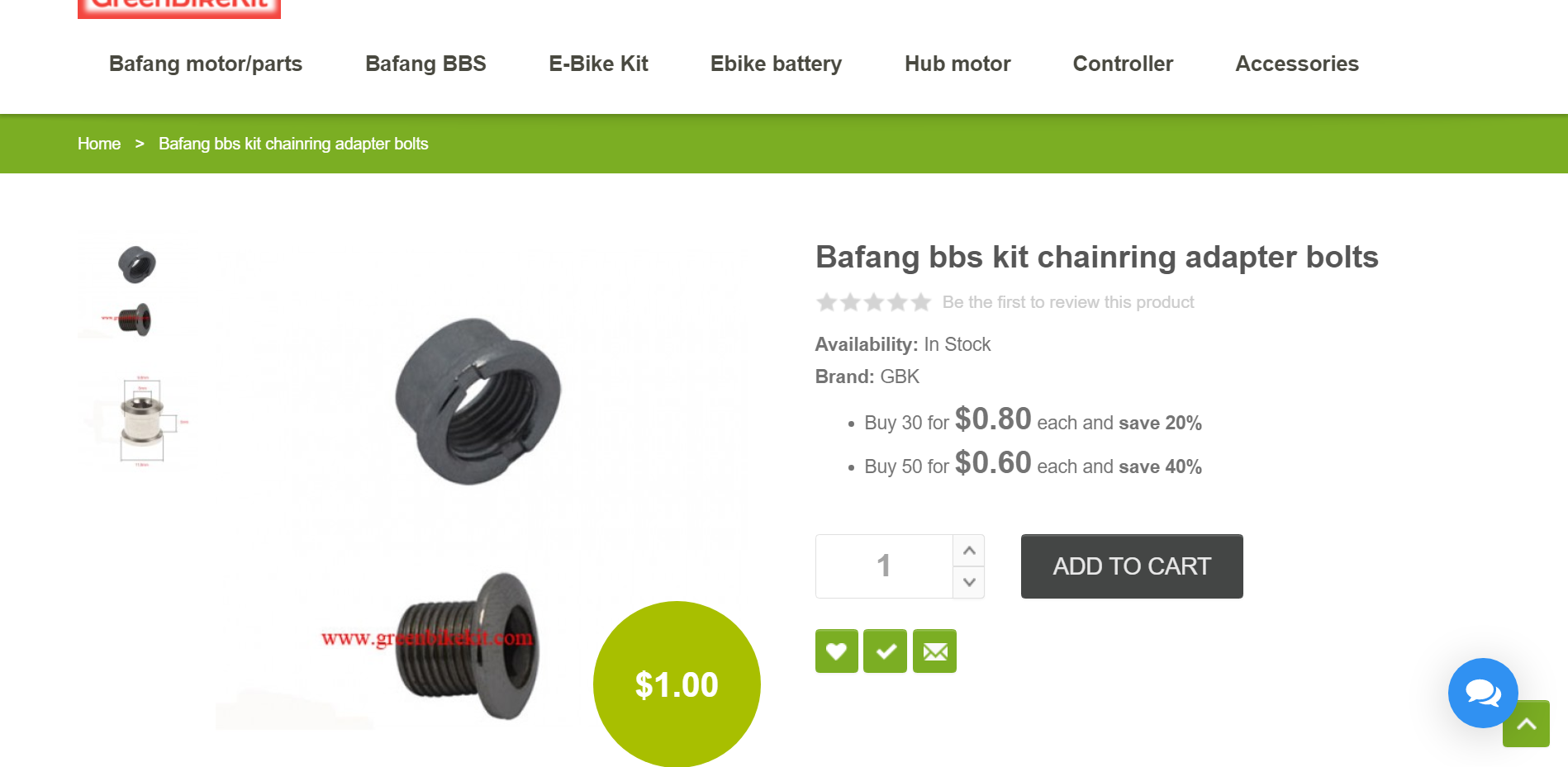

And I made the mistake of, after the bolts were out, moving the bike up onto my work stand. While doing so I lost one of the nuts that hold the bolt to the spider.
Do you think I could find it? :mad:
If not, you can get a replacement nylstop locknut at your hardware store. take the bolt and find the match. It probably is a Metric thread.

I also found them on Amazon.ca. I even found some that are slightly longer, for double chainrings.
I imagine they're all the same diameter?
