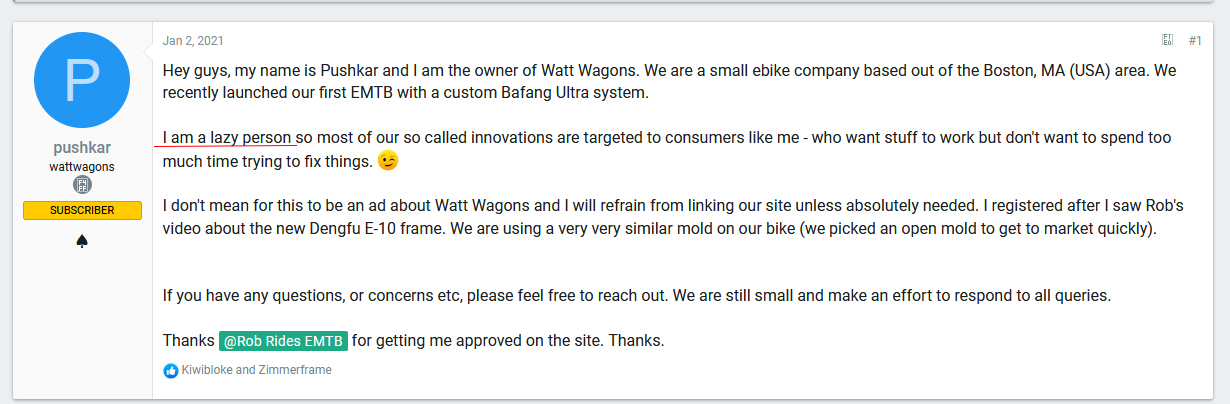

I have to address the elephant in this room:
Why/How the hell does an expensive bike like this pass QC and then be sent to the customer???
R&M prices with barely Walmart quality/operation.
Ironic intro really considering where quite a few people are at the mo. Fixing things....
