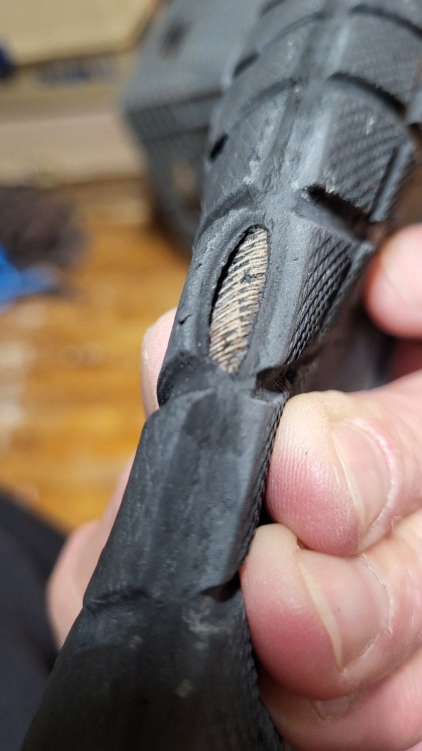

My Tire's Are Rotting !!??@$

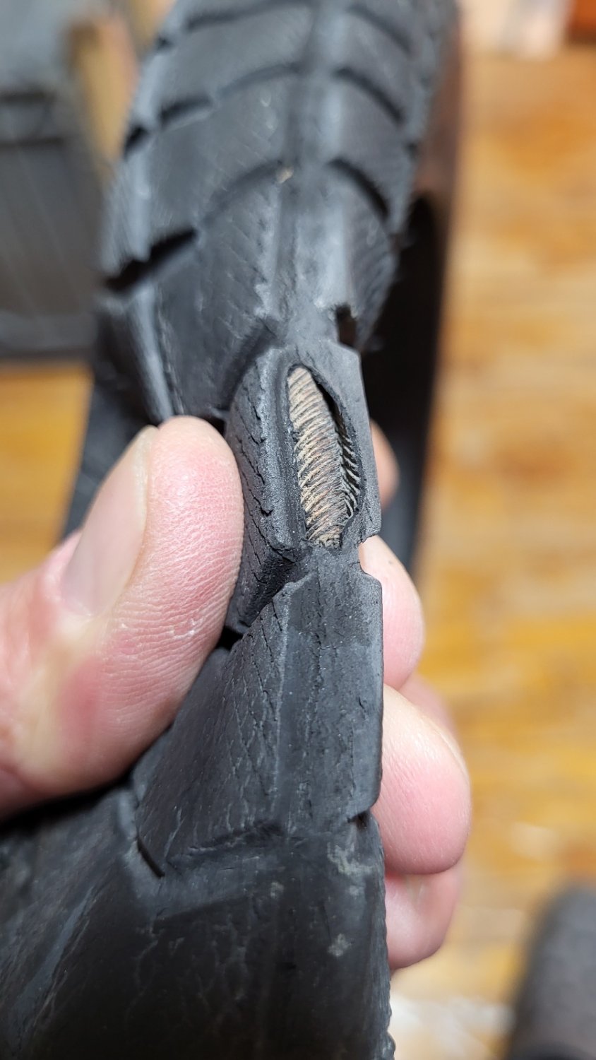

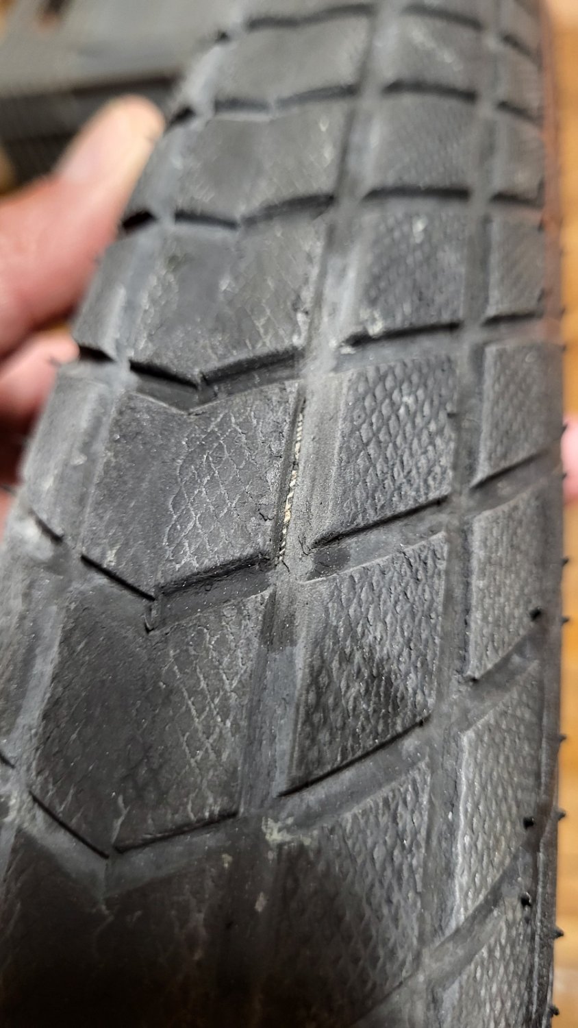

First thing I thought when I saw the pics was maybe over inflation? My tires are always just under the max recommendation, but that's just what I like to do.

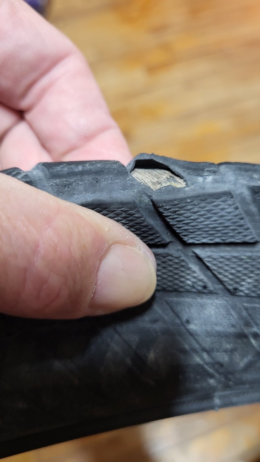

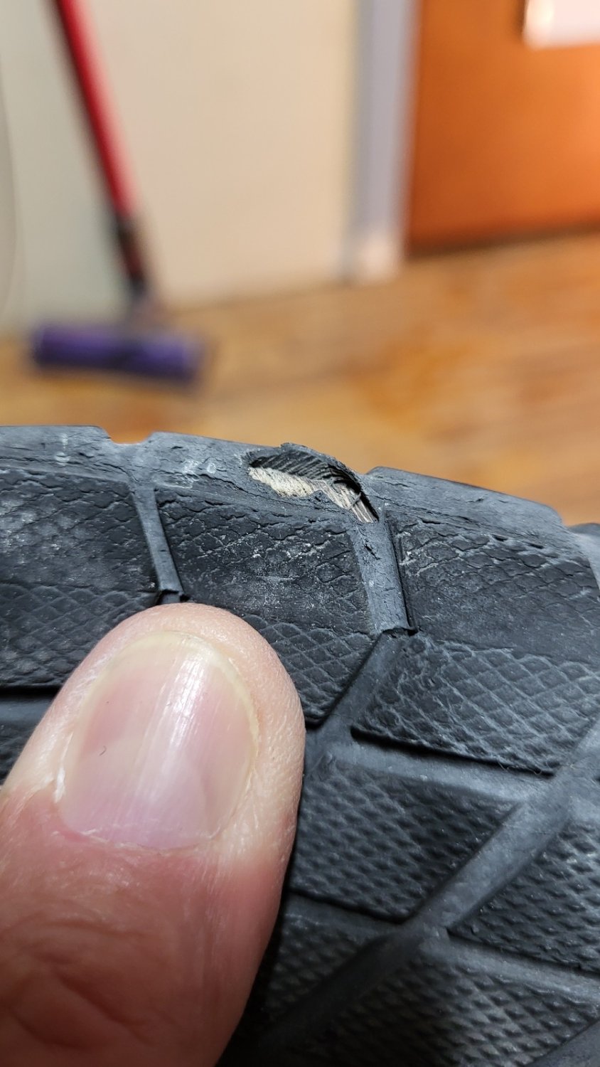

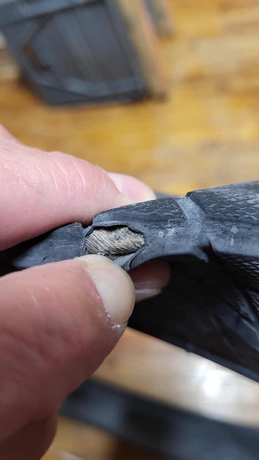

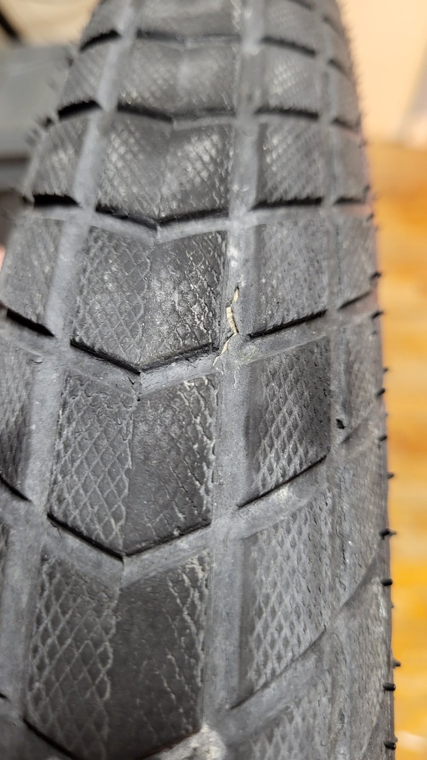

Too much pressure stretching the carcass? I noticed on my wired warrior airing it up to 30 psi the tire just kept getting bigger and bigger. I have a predator now and aired the tires up to 18 psi and they didn't get near as big. Some people are complaining about tire to fender clearance and I think that is what is happening. Like a race car tire, if you don't like the circumference, over pressurize it and set it out in the sun.
I'm just guessing??
I had assumed that a lower pressure (25 PSI vs. 42 PSI in my case) would have the tire flexing more between the lugs causing the inner casing to show through earlier.
But it was the over pressure that made the inner casing show through earlier.
The tread has almost no wear ??

I agree.. If you stayed within the pressure limits it shouldn't split like that before the tread wears.
That said I don't think you need max pressure to have max efficiency either. I find that middle of the range is a good place to start and often where I stay.
edit: I'll add I ride a lot of mixed terrain often during the same ride so that's another reason middle of the range works for me.

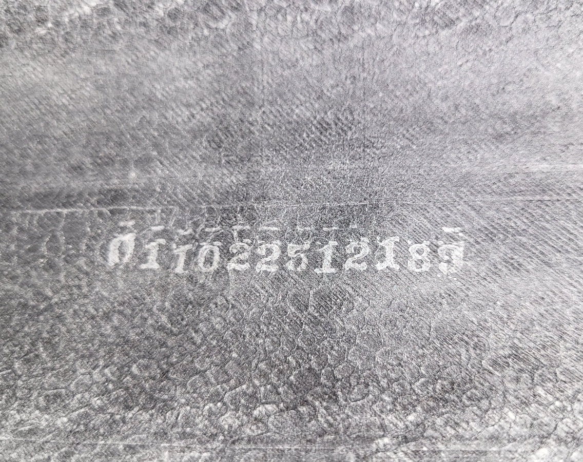

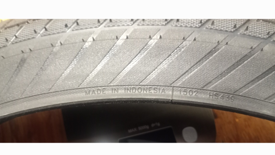

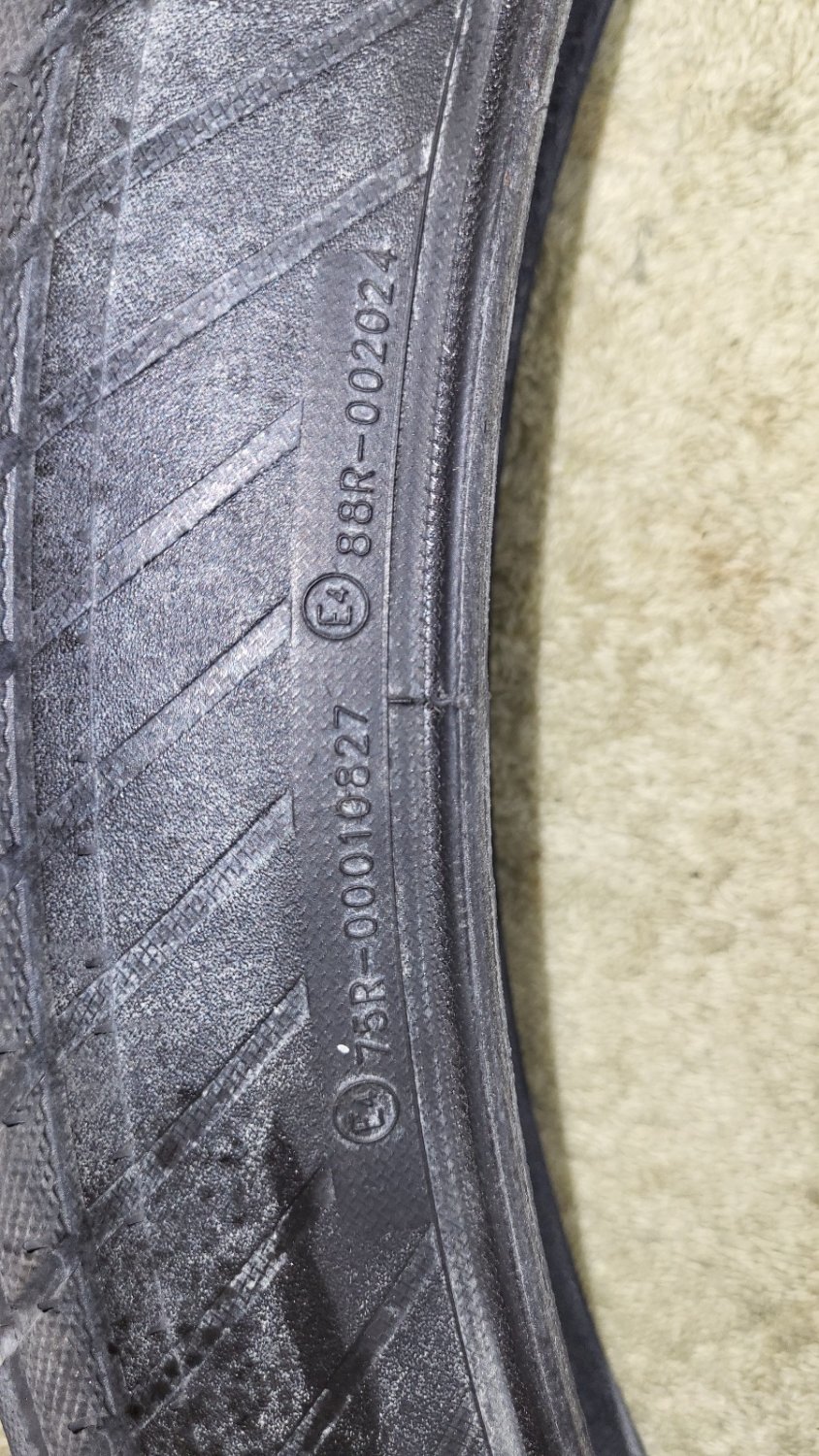

Looks like about an 10-15 yr old tire. Give you one question, you get it right and you win the grand prize. Where was it made?

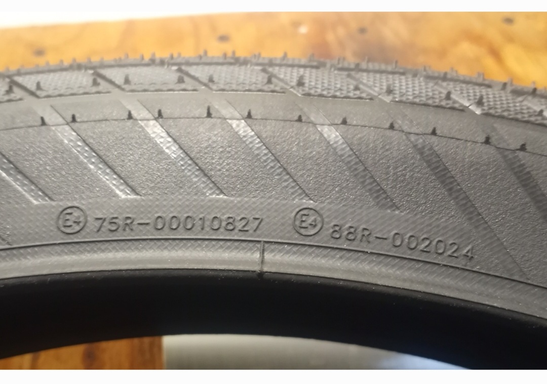

Is the date code on the sidewall in your first group of pictures 2024? If so they aren’t old.
I hadn't removed the old tire yet, and the first pictures were of the new tire that is now on the bike.

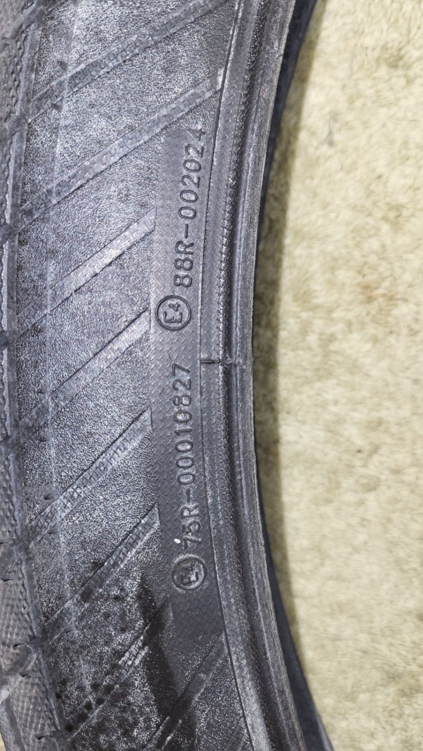

The old tire has this date code,..
Oops,..
I got the date code mixed up with the serial number.
So I guess my tire was made in January 2024.
I bought the tires on March 11th 2024
Was that a trick question?
The picture was in my first post. 😃
I concur...
I doubt very much that the date would be molded in.. and more than likely it's one of the printed on numbers

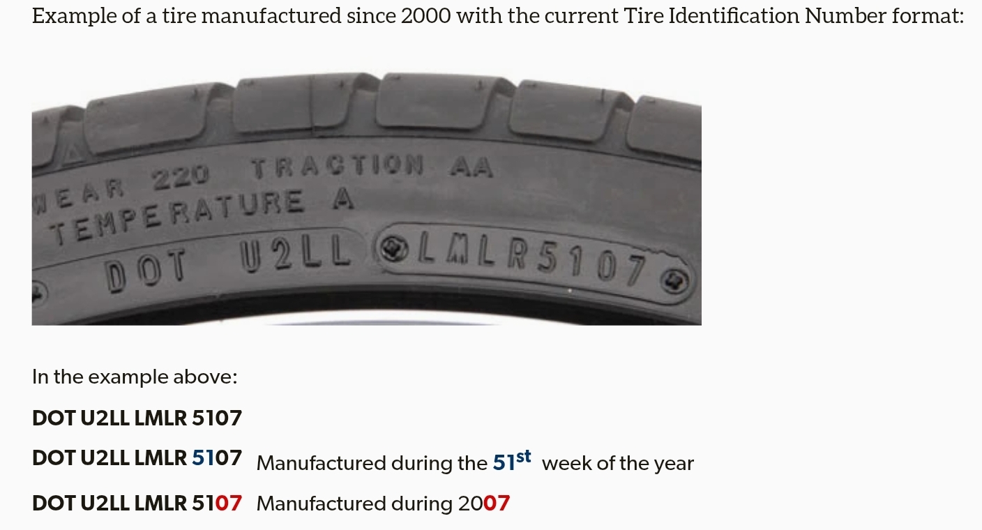

On car and truck tires the date is molded in but you have to know how to read it. It sounds like the 2024 isn’t the date they were made.
I'd of thought that would be cost prohibitive or at least the more expensive option.
Quick Google says it was implemented in 2000 and looks to be a changeable plate of the mold showing 2 digit week and 2 digit year.
@PCeBiker.... Since your tires are moped rated, they might have a similar DOT code on them.
Not sure if required on a "bicycle" tire
