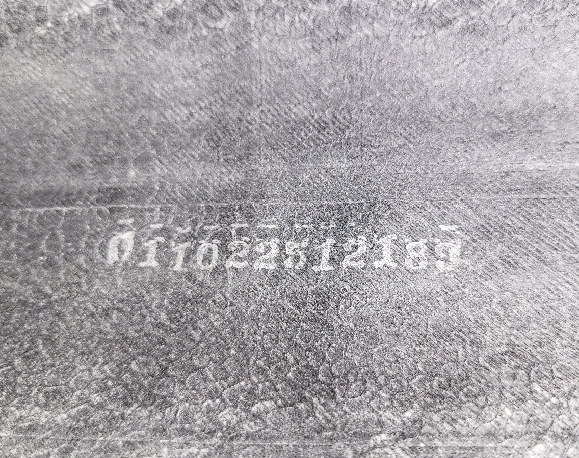

,.. Since your tires are moped rated, they might have a similar DOT code on them.
Not sure if required on a "bicycle" tire
I couldn't find any DOT type code, just the codes shown in the picture above.
This is the stamped code inside the tire that Schwalbe wanted a picture of,..
I'm sure that it includes the exact date and time and even what machine made the tire as well as who was operating it on that day.
It's probably part of the quality control measures, and there probably aren't too many people that know how to read the code?
It's probably privileged information that helps Schwalbe prevent counterfeit tires?

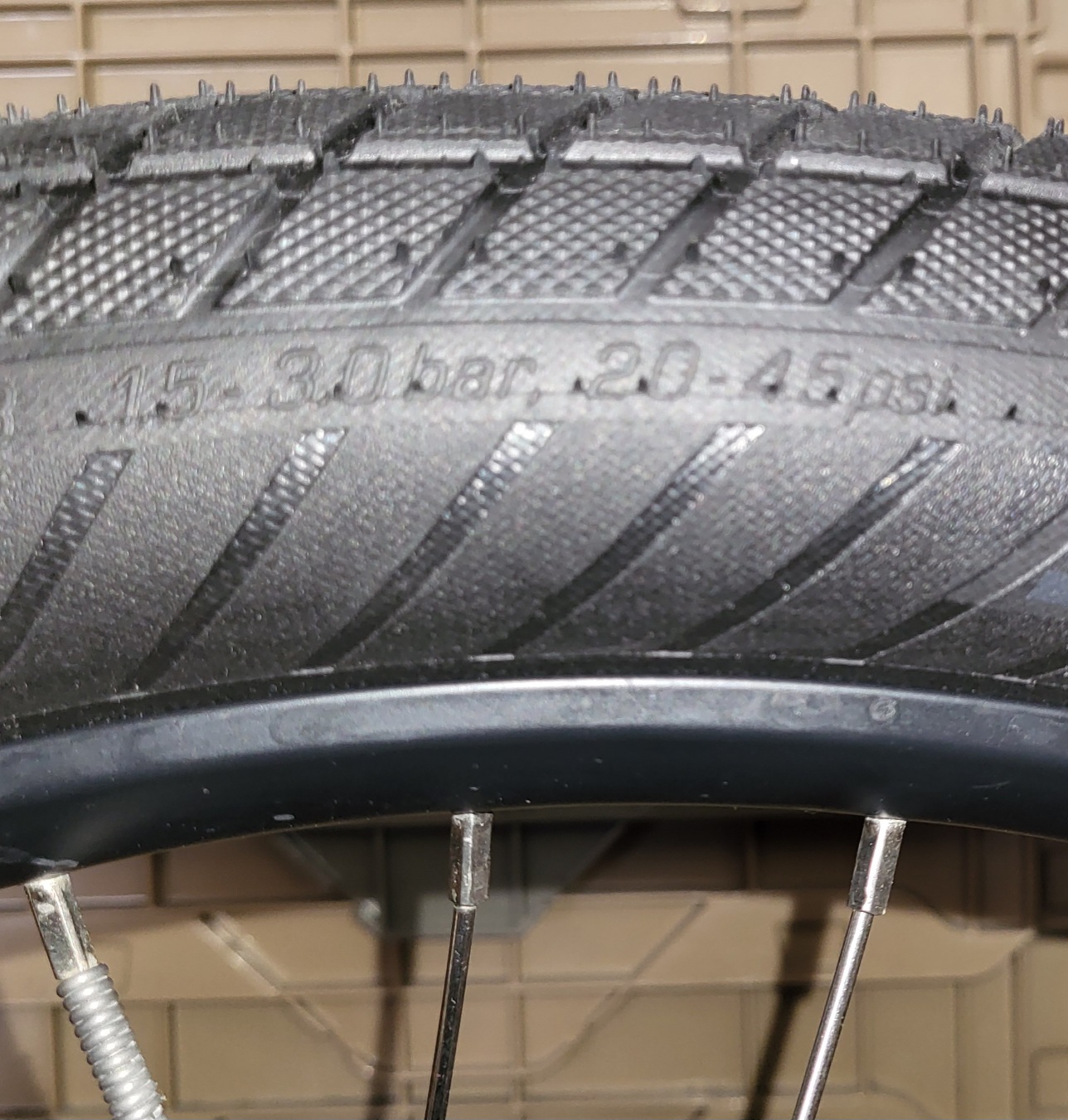

I had always been running ~42 PSI up until about 2 months ago after I rolled my ebike into the edge of the cement step on my back porch.
The corner of the step squashed my tire half way to the rim, and that was with me rolling my ebike at 3 mph!!??
I'd always wanted the most efficient, so I decided to inflate to the maximum pressure (45 PSI), figuring less chance of a pinch flat and the most efficient.
I've also got my full suspension with tons of travel and set to Extra smushy, to help keep my tires in contact with the road, so I wouldn't need the tire itself to flex as much to maintain contact.
I'm pretty sure that the threads started showing in the last couple of months since I increased the pressure?
(Unless I just didn't notice the cracks earlier?)

Honestly the more I think about it... Schwalbe was probably bs'ing you a bit. No reason for that damage within its stated psi rating.
Like I said I'm around 36psi now and that's where I also started. But for a while I did ride around 45psi when I had some long paved rides planned. I really didn't find much benefit and if anything the ride was harsher. Currently with 4600 miles on them and they way they look right now I'd expect to get 3x that.

Higher pressure is not always more efficient. The little bumps add up. You want to have just enough pressure to float over them.
Higher pressure is now always more efficient.
Is it possible for my tire to do what it did because I was running them at 42 psi?
I don't need to care about efficiency.
I got a motor and two batteries. 😁
For a good share of my life I too thought higher pressure was more efficient until I read that testing proved that not to be accurate.
I meant "not".
Ahh, OK
I remember reading where that was tested, and the tires were more efficient when they weren't at maximum pressure. There was a sweet spot where the efficiency was at maximum.
42psi is in the range, so that should have not been a problem.
With that being said, I'm at 34 PSI now with my new tire and I'm going to keep it at that pressure.
