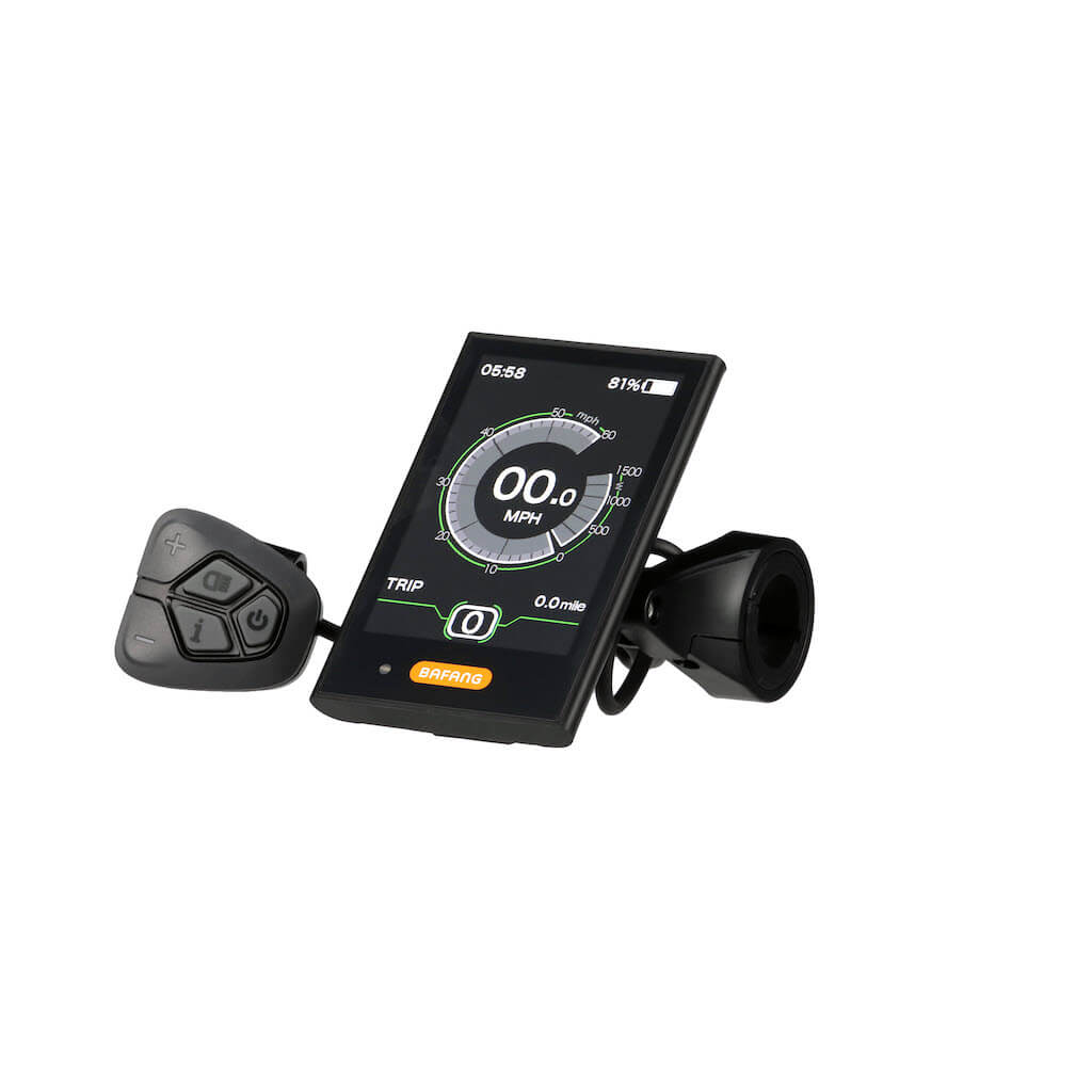

Does anyone have a clue on if it would be possible to switch out the current Sport display for the dpc 18 from Bafang?
Bafang's website: "The Bafang DPC-18 LCD Display is compatible with Bafang mid-drive motors (BBS01/BBS02/BBSHD)."
