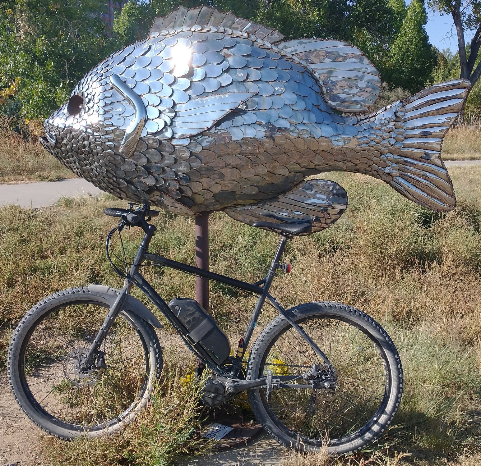

BC-BBSHD update (new build, replaced the GMAC).
The Surly Bridge Club(BC) is now running a BBSHD.
Pretty much all the same parts as on the Troll-BBSHD except this build is using lighter asymmetrical rims and 32 spokes per wheel instead of 36.
The BBSHD is from EM3EV (delivered in 2 weeks). Pretty much stock EM3eV settings except keep current changed from 90 to 100.
Front Hub - 32H Shimano XT 100mm QR hub
Front Spokes - DT champion 2.0mm
Front Rim - WTB HTZ i30 (Ebike specific rims)
Rear Hub - 32H DT Swiss 350 hybrid 148mm boost hub (with QR endcaps that make it 141mm). The BC rear spacing is 138mm to accommodate 135mm and 141mm hubs
Rear Spokes - SAPIM E-leader 2.34mm spokes
Rear Rim - WTB HTZ i30 (Ebike specific rims)
Definately noticed a difference when building the wheels in more even spoke tension.
Roughly speaking off the top of my head, the spoke tension on a normal rear rim was about 130kg on the drive side and 90-100 on the disc side. With the asymmetrical rims, its roughly 130kg on the drive side and 120 on the disc side. The front wheel spoke tensions are about equal at 130kg.
The Bridge Club is just as accommodating as the Troll/Ogre for BBSHD installation. The Troll/Ogre list a max 1x chainring 42T, The BC is listed as 34T.
The Troll required a 1mm spacer on the drive side for the BBSHD housing to clear the chainstay. Im assuming the Ogre would require the same (I will verify at some point in the future). The BC stock requires a 2mm spacer. A few hard whacks with a deadblow hammer on the BC chainstay got it down to 1.5mm. Pretty sure I could take a dremel to the BBSHD housing and get it to 1mm buts its only 0.5mm so a 1.5mm spacer it is for now.
A 42T lekkie bling ring is about as large as I would want to go on the BC with the 1.5mm spacer. The Troll/Ogre could go larger
While the rear 135mm QR seems to have enough threads engaged to be safe, I am going to order a 141mmm rear QR skewer.
Need to clean up the wiring enclosed in a grin velcro sleeve. Will do that in the next week.
Definately feels lighter than the Troll Build (probaby 1# in the frame and 3# in the wheels/tires)
The bottom line: The Surly Bridge Club makes a great BBSHD conversion

Took it out for a ride today and did a 37 mile 'fast fitness ride' no problems (average speed 18.8mph, 1537 vertical, 570wh used, 15.45wh/mile, 130 avg heart rate). Im pretty impressed with the wh/mile vs avg speed but I have really improved my fitness this summer riding my BBSHD bikes. A 52V 17ah battery has 884wh so at 80%, thats 707wh so at 15wh/mile (my typical average), thats 47 miles range...lets just round it up to 50 miles 👍
A pic from todays ride
