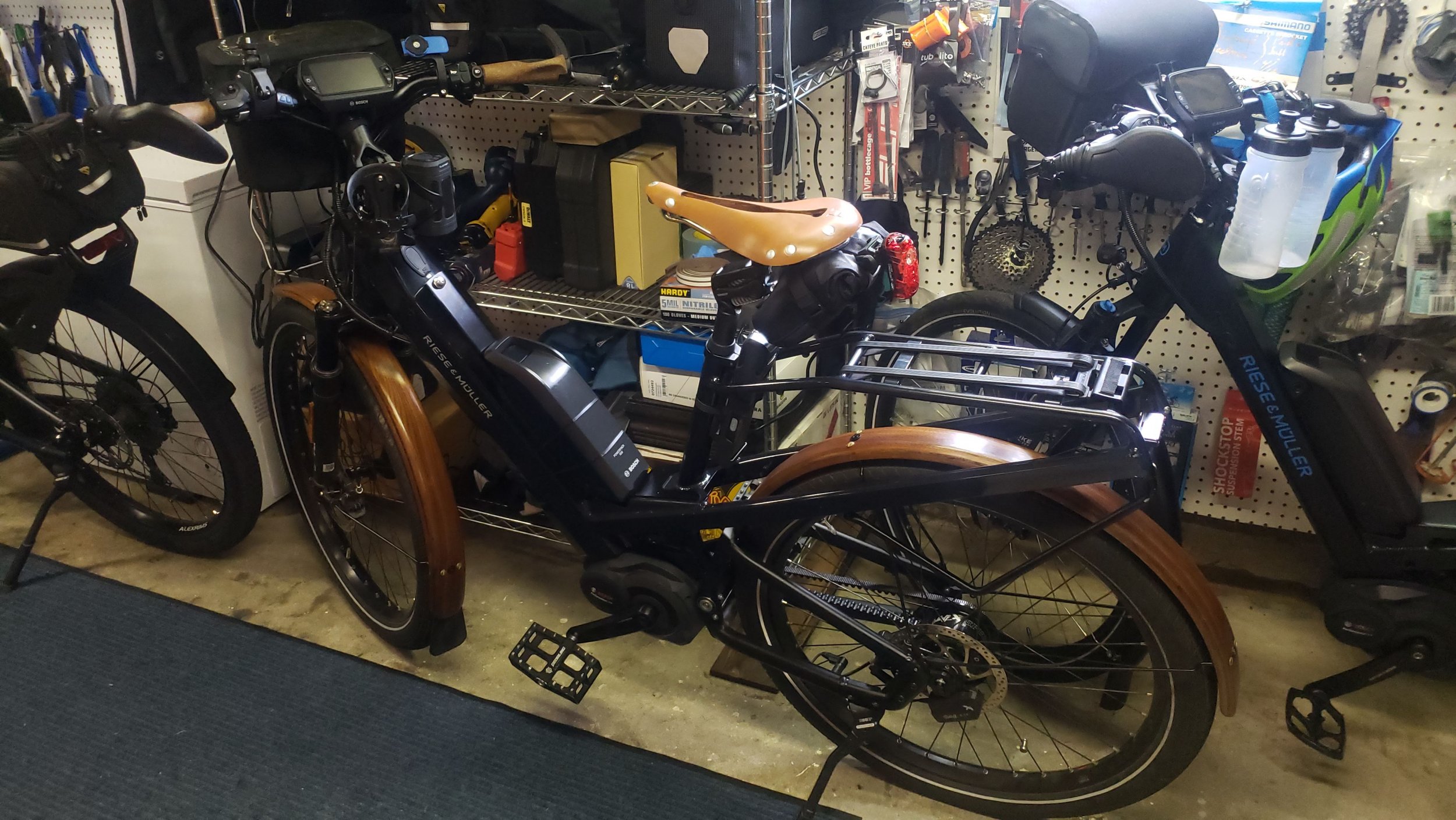

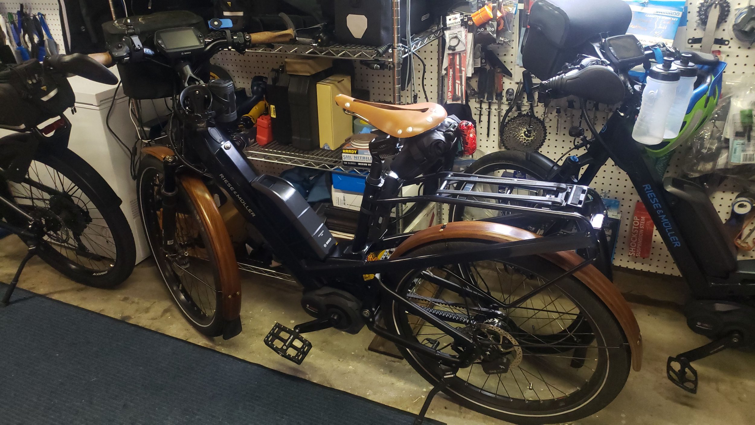

I ride a Riese & Muller Homage which is more of a city or touring bike that has a full (front and rear) suspension. It is a low step through frame, great if your ability to swing your leg up and over the saddle is diminishing. The suspension is tuned to provide a more sure footed ride on uneven road surfaces to allow for longer more comfortable rides. The front fork is ebike specific with a 100mm travel, far to short for a proper mountain bike. The full suspension keeps the tires on the road making for shorter stopping distances and more sure footed cornering. My bike is a class 3 28mph version and has the optional second battery as well as a belt driven Rohloff hub. It came with SKS polycarbonate fenders which I replaced with custom wood fender made in Bend, Oregon. I also added the Kinekt seat post to help with high frequency flaws in the road surfaces. It is a great all around bike. The only down side is that it is quite pricey. something that fades in memory over time and overshadowed by the sheer fun and quality of the riding experience.
Nice ride... love the wood fenders!
