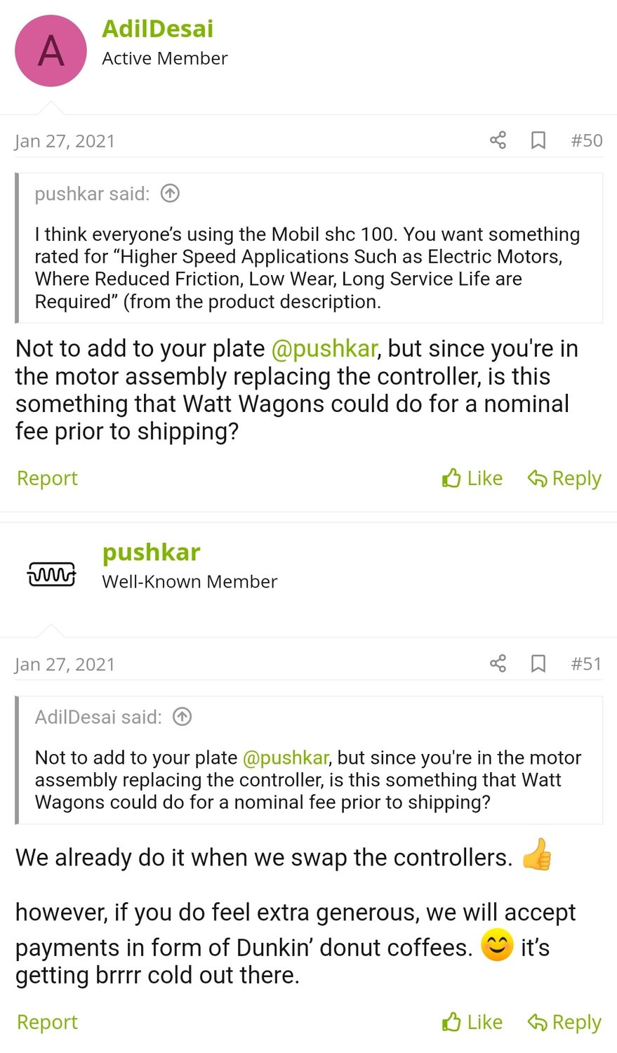

What about Mobilgrease 28? Do they have that in stock?
That one is still in stock on Amazon, but it was apparently superseded by Mobilith SHC 100 which is why I tried to get the most modern thing I could. Mobilgrease 28 carries a military spec (MIL-PRF-81322) so if you want some you better get on it before it's all bought up! I recall it being used on several assemblies at my previous job.

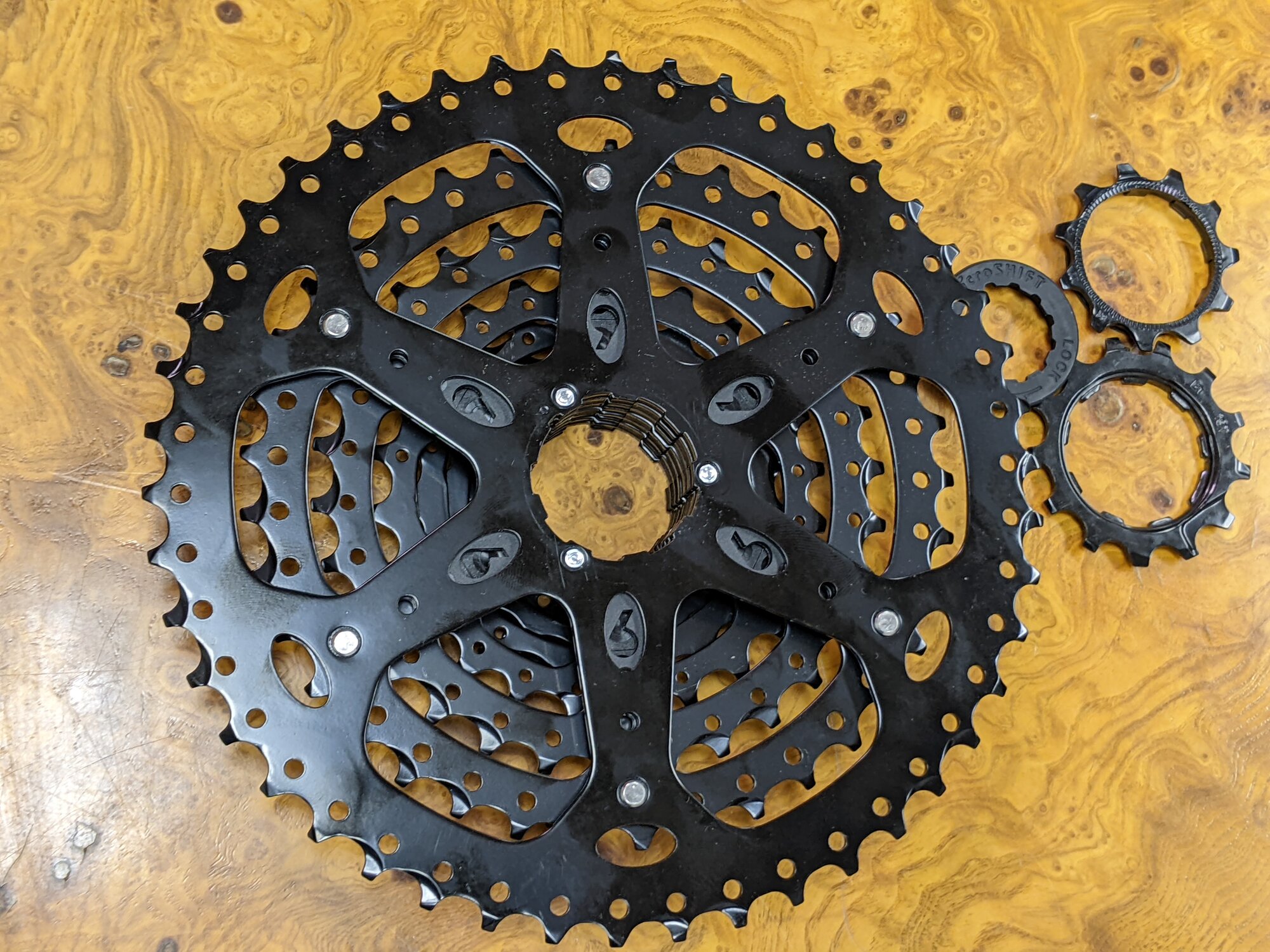

High gear skipping is most often due to cassette wear and will require replacing either the cassette or, if available the two smallest cogs. The problem is that the smallest cogs (highest gears) on the cassette only hold the chain with a few teeth, and thus are subject to frictional wear more than the larger cogs. The "valleys" between the teeth get deeper and the teeth get thinner causing the chain to skip.
Replacement cogs are available for many of the higher end Shimano cassettes which enables one to get more life out of as cassette without having to replace the whole assembly.

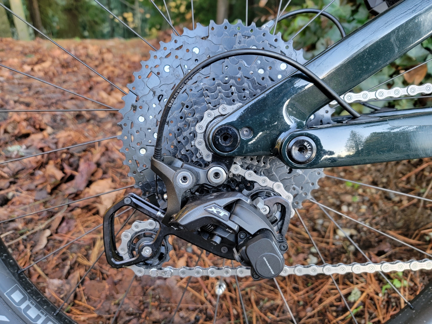

The Wolf Tooth Goat Link may offer you a solution for putting wider range cassette on your 11 speed Shimano setup. it is a short extension of your derailleur hanger that allows it to accommodate a larger low gear cog.
Looks like the M8000 derailleur comes with something similar as standard (or the guys at WW added it), think it would replace that black horizontal link there?
I think everything you have there stays and the goat link goes between the derailleur hanger (black piece hanging off the axle socket) and the derailleur.
Here is Wolf Tooth's page with installation instructions - step by step instructions with lots of pictures.
Yeah I was looking at their installation page, I took a closer look and realized their earlier pictures had a black link similar to the one on my bike, and theirs looks like it is designed to replace that. Worth a shot at only $30 before my impatience with WW support gets ahold of me and I buy an M8130 lol.

If you can live with 46T, Microshift makes an 11-46T that is pinned-together hardened steel (1 piece cogs no spider) which is tailor-made to a hi power mid. The 1-piece steel cluster distributes the force of the mid across the entire cassette body and minimizes the digging-in that you get with a cassette with replaceable cogs. It runs $36 at Jenson USA. The same on Amazon.
