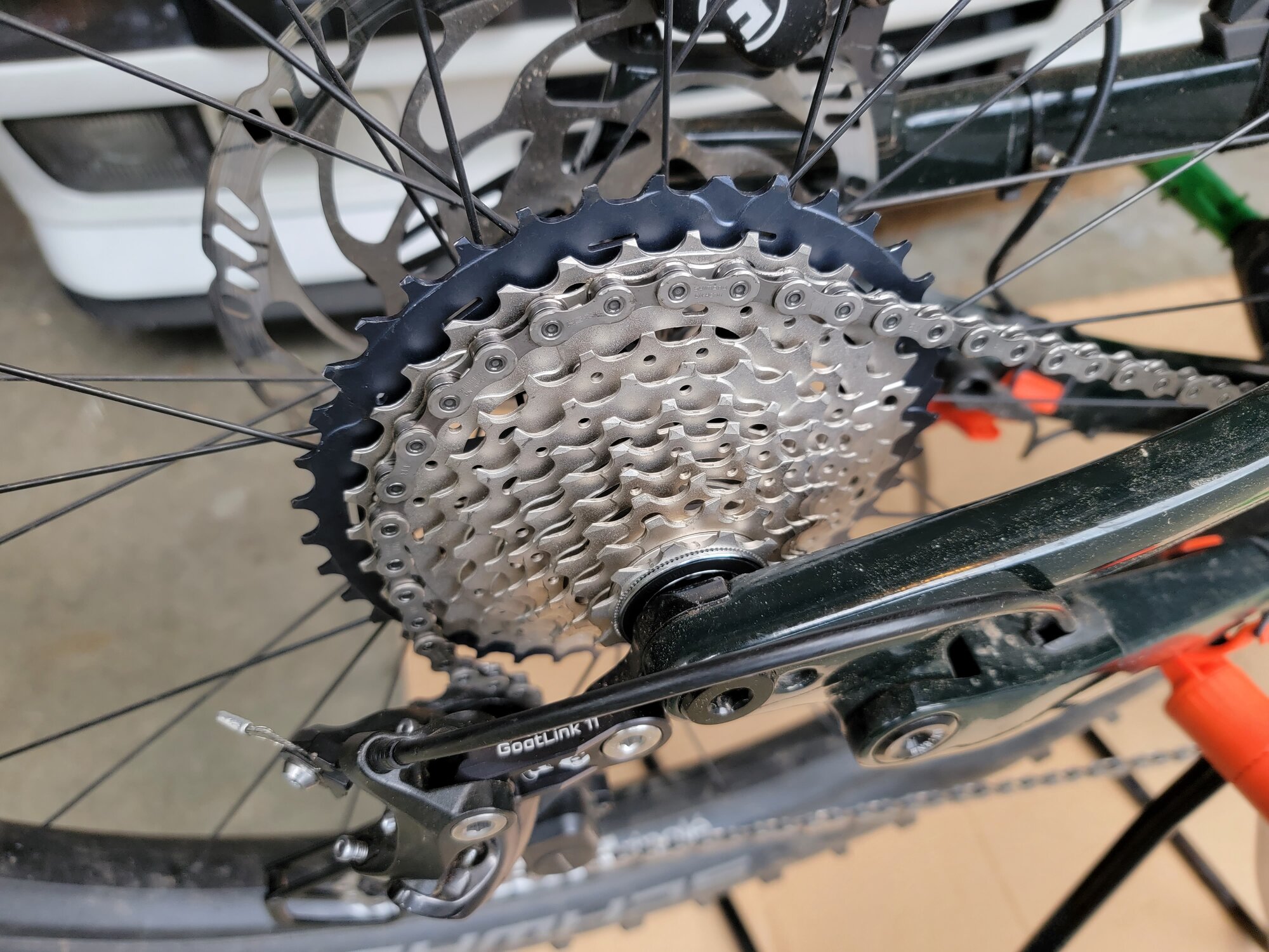

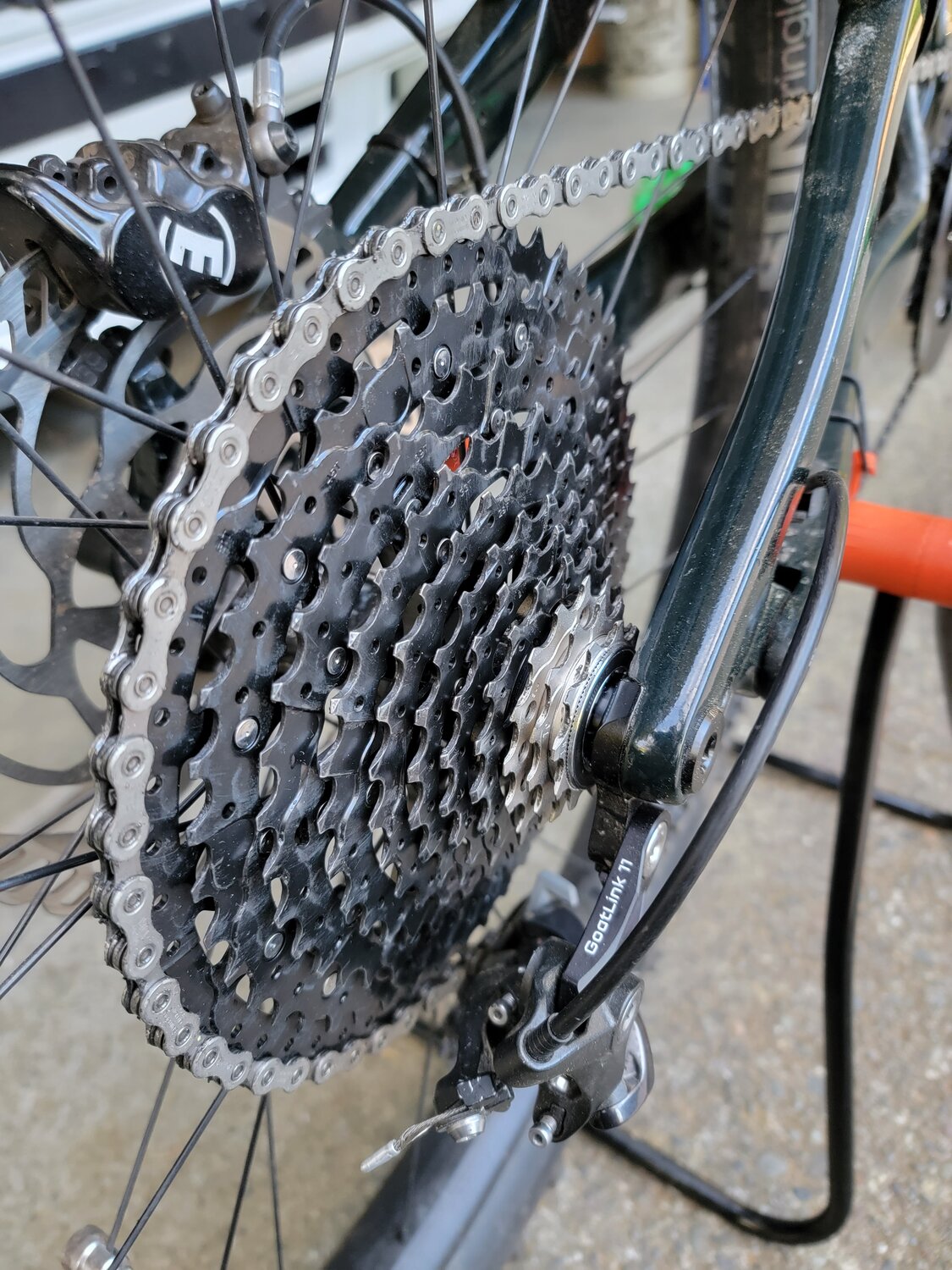

I installed the Goat Link, tried out Sport mode in the highest gear, and promptly felt/heard it slipping even in my level 1 which I have tuned to 1000 watts. I took a look at the cog itself and the tips of the teeth were shiny as if they had been freshly fractured, so I guess this cassette is toast.

Is issues only with smallest cogs on chainring?
I use 750-1250watts a bunch offroad climbing, but that's not with smallest cogs. And on street I generally always am using 1000 watts.. but I have 15-21mph speed limit.. so again not in smallest cogs. -- Motor helps get me up to speed from a stop, but then I do majority of work to maintain speed on street.
Also replacing chain right now, its lasted 1100 miles.. which seems reasonble to me. I did order a CN-E8000-11 to see if it lasts any longer.
Anyways point is doesn't seem like power is the problem.. its like power with smallest cogs that causes issues? Wonder if its best just to try to avoid that. Maybe like instead of a 9 speed 11-46T better would be a 11 speed 11-51T with a bigger chainring and just don't use the 2 smallest cogs, pretend its a 15-51T. Though probably couldn't get a big enough chainring for it to really be equivalent.
Yeah only with the smallest 11T cog, the other smallest ones generally seem to be okay after installing the Garbaruk derailleur cage and spacing out the chainring. I tend to ride on the street with the 28mph or unlimited speed because I like to keep up with the 25mph speed limit on the lightly trafficked roads I'm riding on.
My chain and cassette are arriving early today so I'll be installing those as well as the Tannus armor I've had sitting around.
Power is definitely the problem with the smallest cogs, it's such a small amount of metal you're pumping 1000-2300 watts through on the 11T cog, it really helps to have the chain wrapped as tightly around that cog as possible in order to prevent issues. Anything bigger than the 11T cog really doesn't keep up with my pedal cadence with the 42T chainring, I looked into going with a bigger chainring but I already have issues high centering on logs and stuff lol.
Installed my Tannus armor that has been sitting around (what a pain) and my new cassette + chain this weekend! WW actually sent me a Shimano CSM7000 SLX 11-40T cassette which I'm not so sure on, I'll take it for a ride but 40T seems like it won't provide enough torque when climbing without assist. I am pretty sure I can just use the smaller cogs from the Shimano cassette with the rest from the Sunrace cassette, I may try that this week once my new fork arrives.

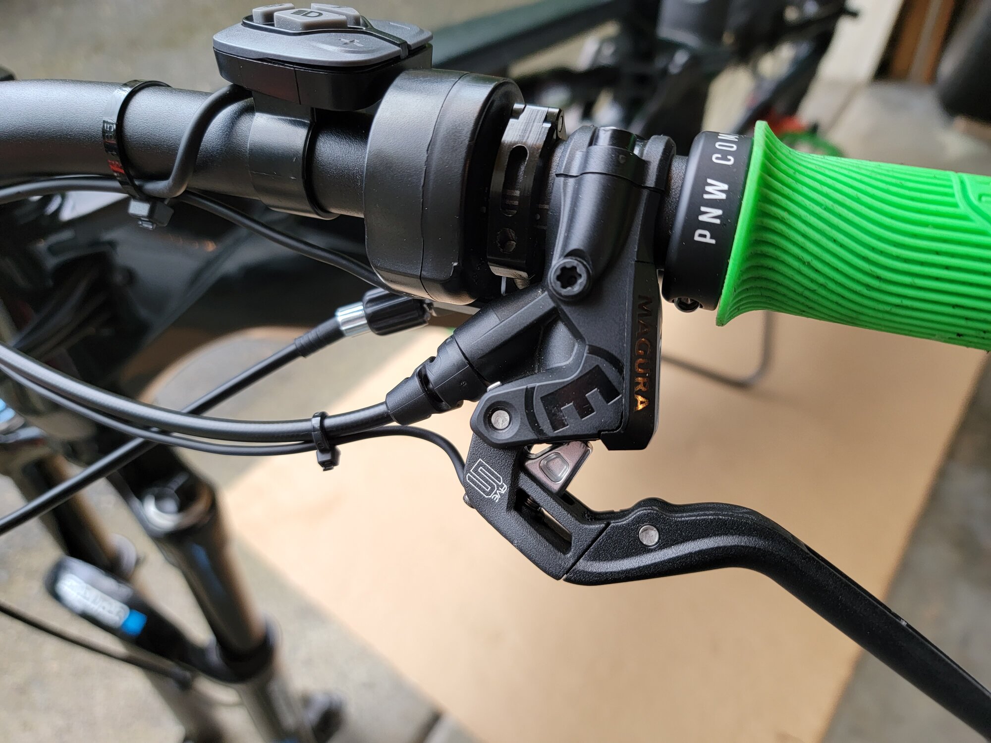

Also finally got my MT5e brake levers installed, the connectors were tucked away coiled up inside the frame above the upper battery cradle. I had to fish them out through the frame cable management holes using some copper wire and electrical tape, then I grabbed the connectors with a needle nose and pulled them through. I had to remove one of the aluminum cable guides that the dropper post ran through and cut a notch in the side using a coping saw, because the HIGO connectors are too big to fit through. This is what WW did on the other side. The brake levers worked right away which is awesome! Spent a bunch of time cable managing and everything looks pretty clean. Might wrap it in fabric or plastic wire wrap to clean it up a little more.
What levers did you have ?
I had the regular MT5 levers without ebike switches. I was told this was because of supply chain issues.

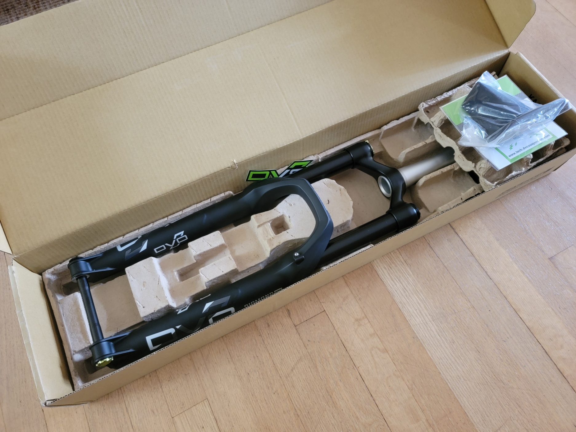

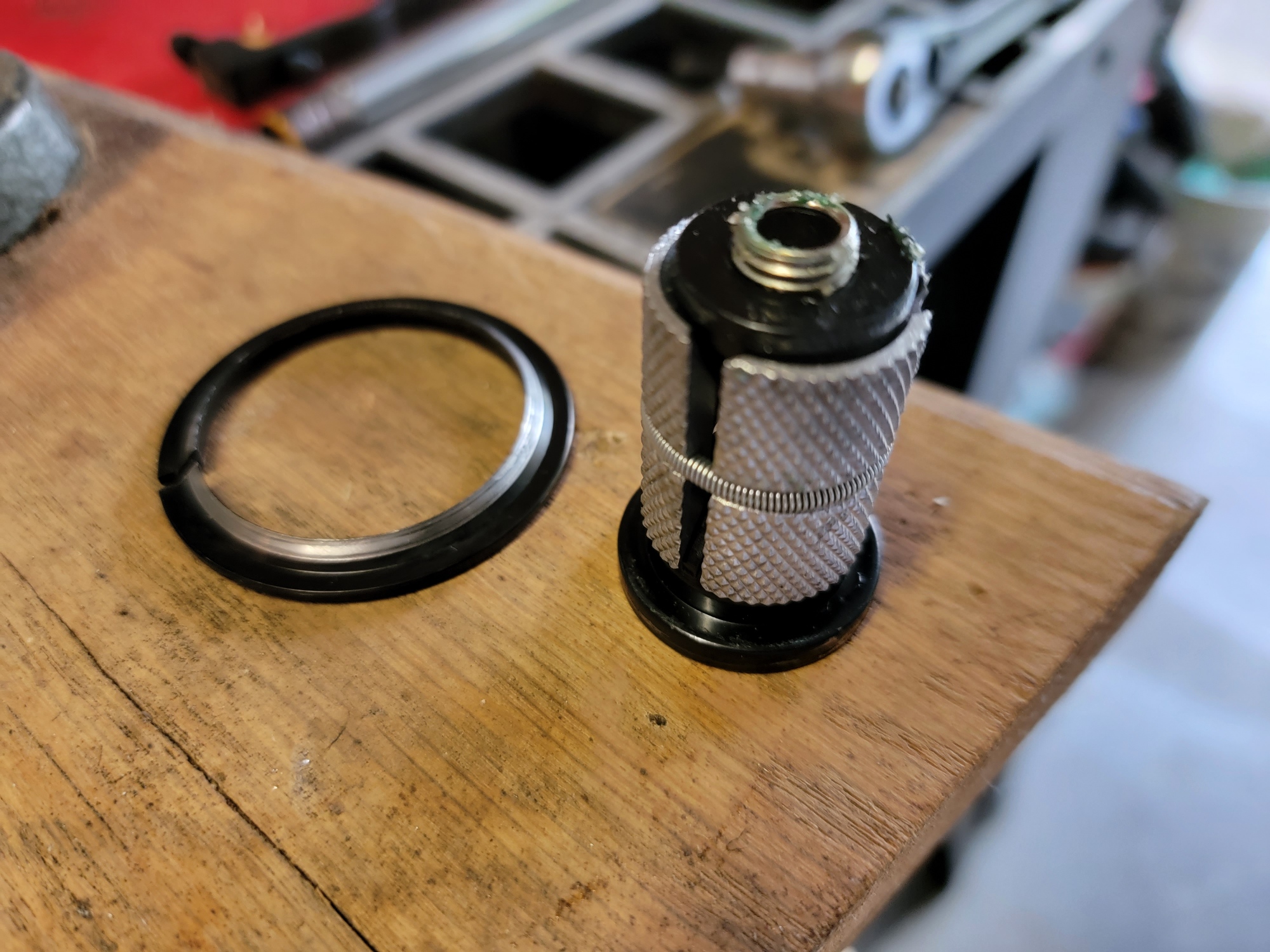

On Thursday night last week I disassembled the headset on my bike just to see what I would be dealing with. To my surprise, the folks at WW graciously installed a split crown race and an expanding mandrel headset nut, which saved me a HUGE amount of hassle. I was able to cancel my orders for the star nut and star nut tool.

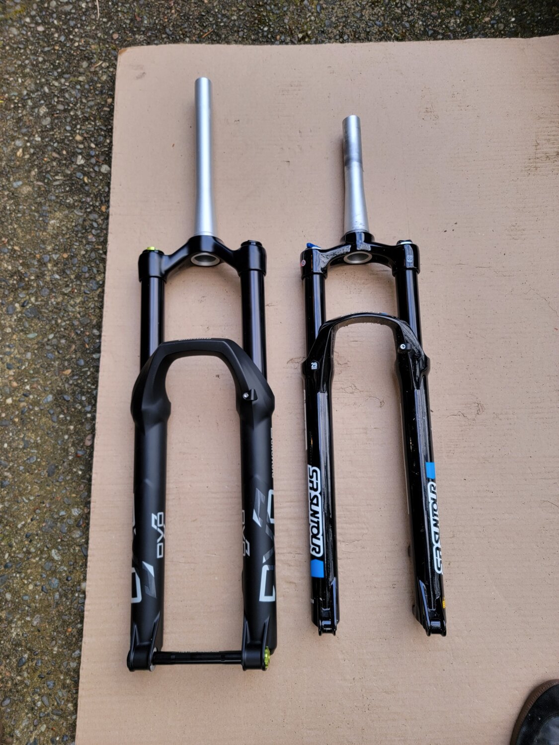

Here's a comparison shot between the DVO and the Suntour... you can tell how much beefier the DVO is which will suit this bike's weight and my riding style much better.

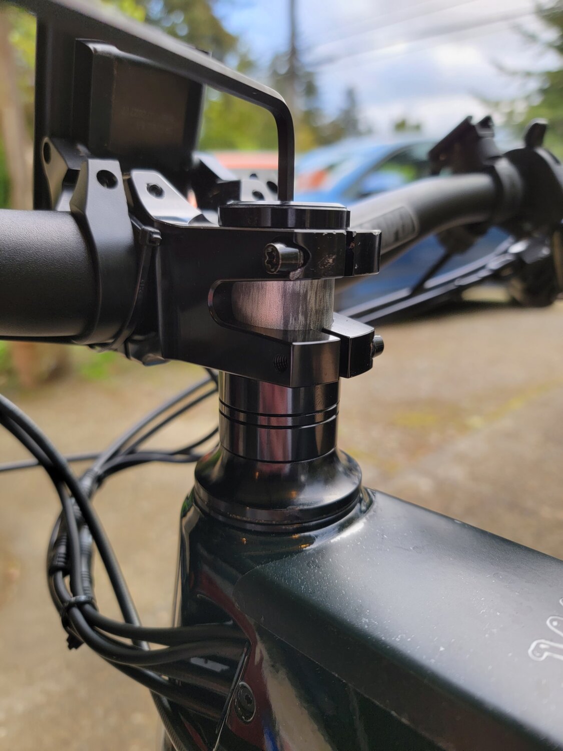

I decided to dive right in, I measured my old fork at almost exactly 200mm using some 12" Mitutoyo calipers that I semi-unintentionally permanently borrowed from my last job and marked the new fork. WW had cut the old fork a little bit long (basically no clearance at the top of the stem, all of the guides I've seen online say to cut 3-5mm shorter than the top of the stem), so I marked 2mm shorter to give myself some wiggle room. They also fitted a large stack of spacers so if I truly messed up, I could just remove a spacer.
I used some hose clamps to mark the cut line and clamped the hose clamp screws into my vise, with the fork still in its bag to avoid metal shavings getting on the stanchions. I used a brand new 32tpi hacksaw blade which went pretty quickly but unfortunately the blade drifted INTO the hose clamps so I flipped everything over and started from the other side.
I ended up having to file/sand about 1mm off of the end to get rid of the error from the drifting saw, which brought me to almost exactly 197mm which was perfect and gave me that 3mm recommended clearance from the top of the stem. The expanding headset nut does stick up about 5mm from the top, so the way they installed it from the factory was with another small spacer on top of the stem so that the topcap would fit. Before fitting everything back together I filed the edges of the steer tube and cleaned/greased all of the bearing surfaces with the same Unirex N2 I used in my motor. Here's the whole headset assembly:

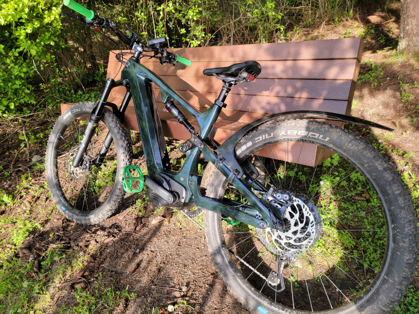

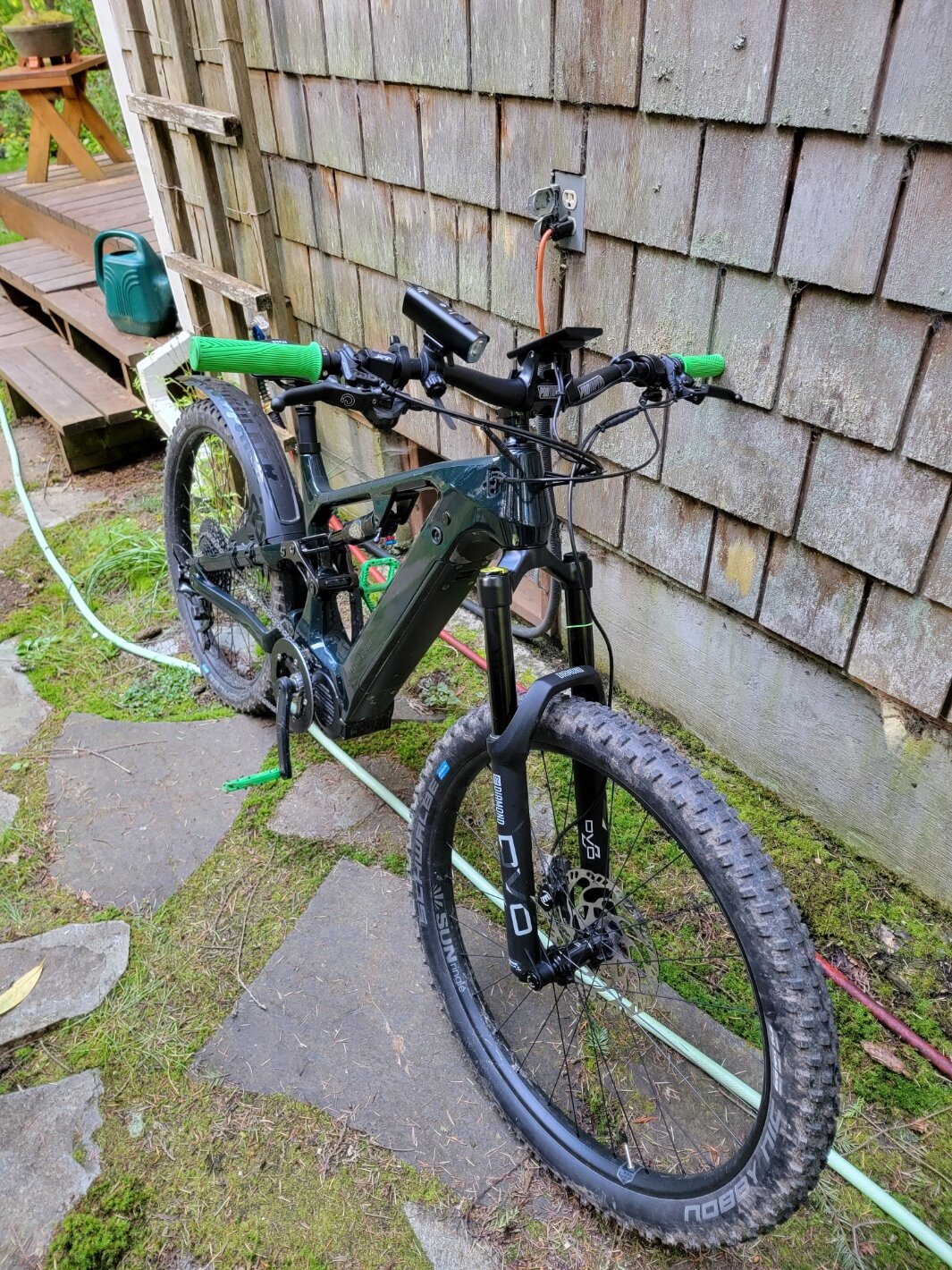

And the new fork installed! Very happy with the color matching the rest of my color scheme with the green grips, pedals, and paint.
Another angle in the sun:
First impressions on the DVO (street only): WAY MORE COMFORTABLE. Since I've increased my travel by 60mm I can run much softer than the Suntour, which is awesome for comfort. I'll be taking it to my go to bike park on Tuesday to try it out on the trail.

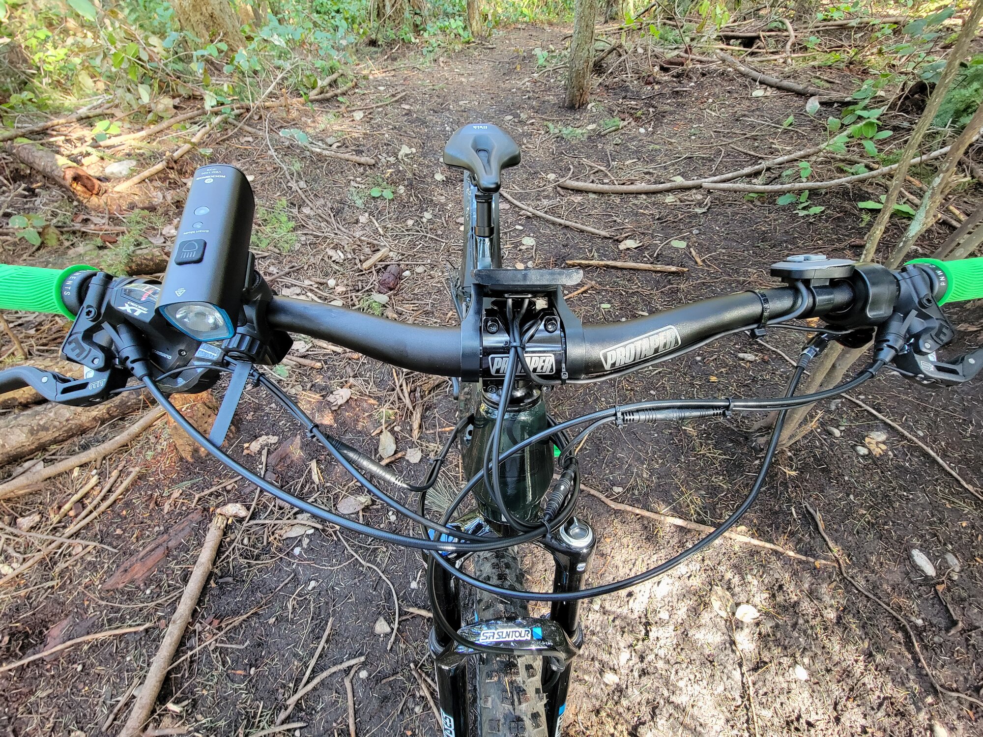

Oh and since I cut my steer tube a bit shorter, I can fit my custom Cascadian flag topcap now 😁
One of my brand new Magura e-stop levers stopped working after like 2 rides 😡
Confirmed this by swapping the M620 brake harness wires left to right, and the same issue persisted... so I know it's the switch itself in the lever.
Emailed Starbike (in Germany) where I ordered them from to get some warranty support. Ideally I'd like to order a few of the actual sensors themselves as spares, but I have no idea if that's possible.
Edit: they want me to SHIP THEM BACK to Germany. Unbelievable.
Double edit: Contacted Magura USA directly and they're shipping me a new lever for free which is awesome!
