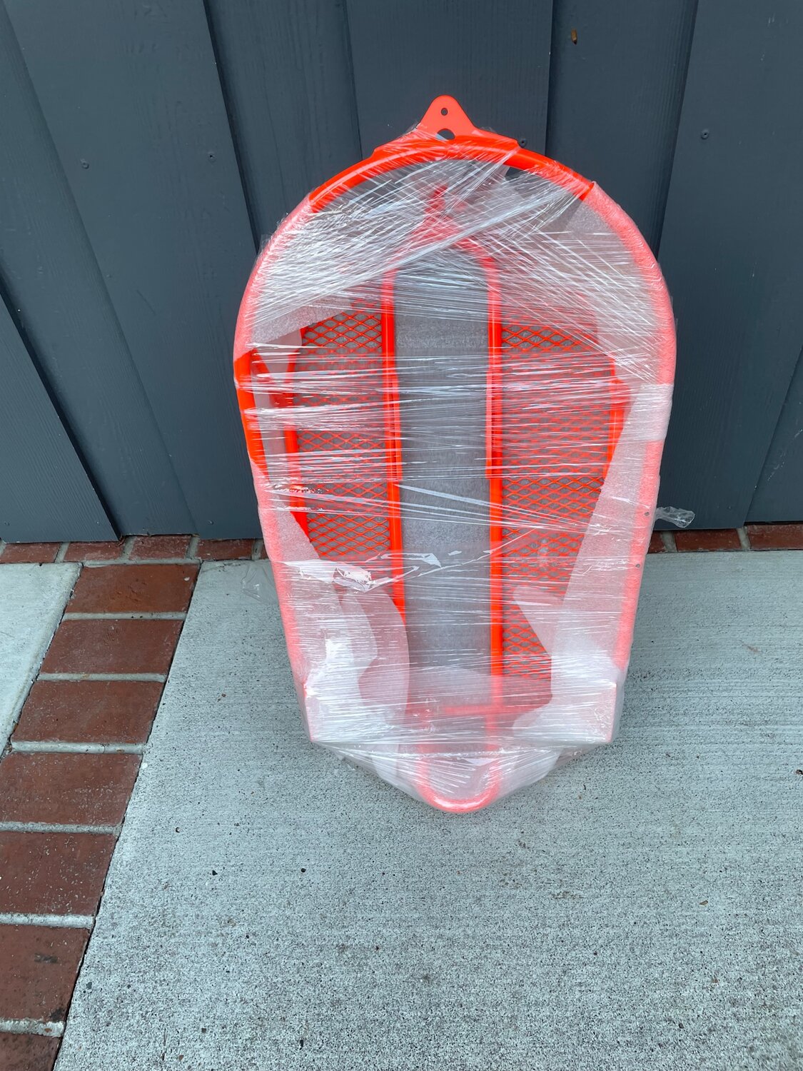

Progress report: Got the BOB back from the powder coaters. Went the bright route obviously. Wheel is in transit and batteries/boxes in stock.
