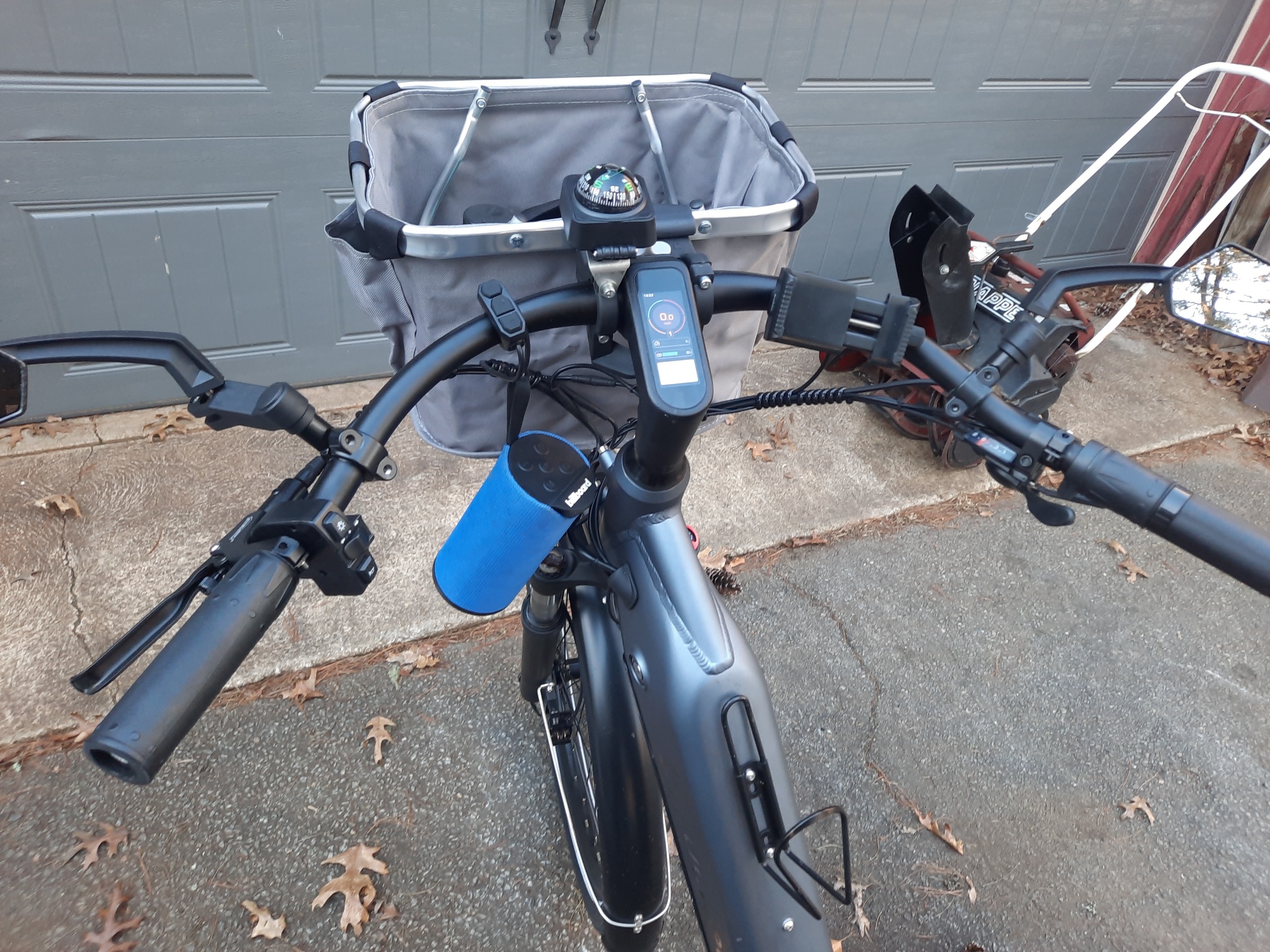

Hi Stan, yes got the new bars, these ones https://www.amazon.com/gp/product/B0CDPPVJYM/ref=ox_sc_act_title_1?smid=A1OBYPICC9E0TC&th=1 The rear brake hose and shift cable are somewhat short, had to install the bars upside down, and I cut about 1" off the ends of the bars on each side. Worked out pretty well, gave me the upright riding position I prefer, probably due to my back issues. Kind of tricky to remove the right hand grip/ throttle - there is an allen head screw inside the handlebars that you access thru the hole in the end of the grip. I have put about 90 miles on it, still getting acquainted with it. Got these mirrors on Ebay https://www.ebay.com/itm/353300570392 Real nice mirrors on a smokin deal IMO.

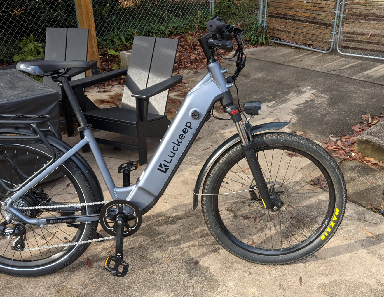

Have either of you noticed bad speed wobble in the steering? I'm unable to ride or coast with no hands. The front wheel dangerously oscillates. You can even do this without removing your hands. Just turn the front wheel left and right while riding.
As a test, I swapped the front wheel with the 26" wheel from my Mongoose Envoy. And it almost eliminated all the wobble. With the 26" wheel I can ride and coast with no hands.
The Envoy wheel is custom with a Deore XT HB-M756 hub, SunRinger MTX-33 rim, and Sapim Strong 14g spokes.

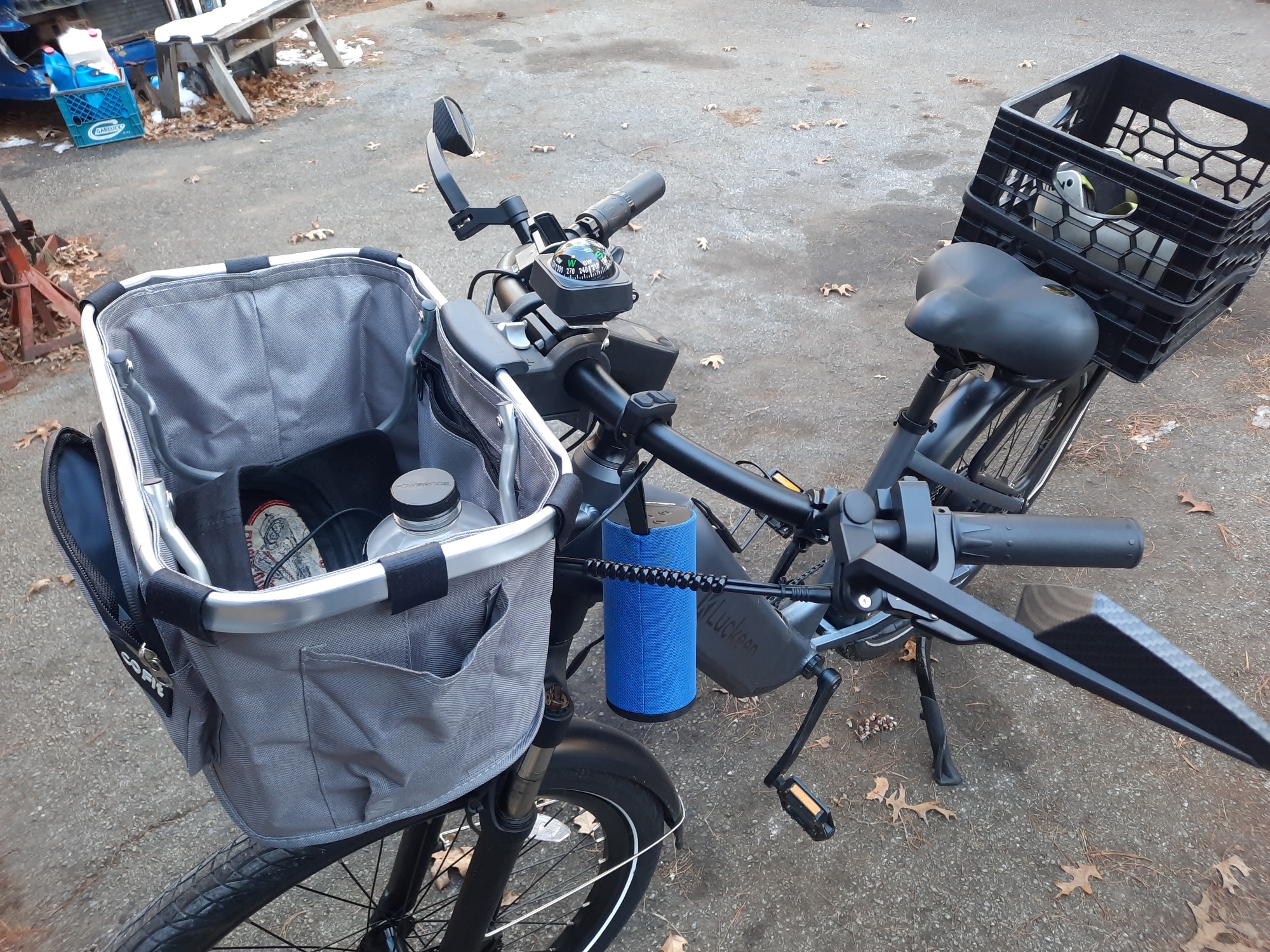

Been a cold winter, not a lot of days above 32*, unlike last year when I was able to ride almost every day. Have about 250 miles on it now, I like it, quite different from my Vitilan U7 20" foldable. I swapped out the handlebars, added mirrors, compass, and removable basket, much more comfortable upright riding position, at least for me with my back and neck issues.

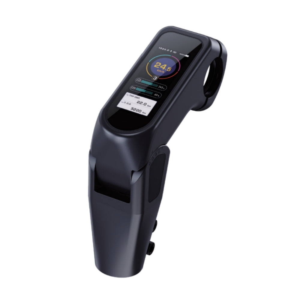

Anyone bought the adjustable riser on their site to raise the handlebars and bring them a little closer? Looks as though it comes with a new screen.
