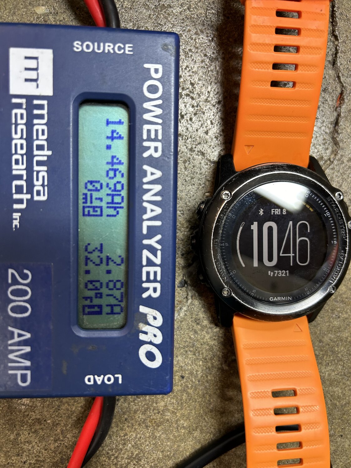

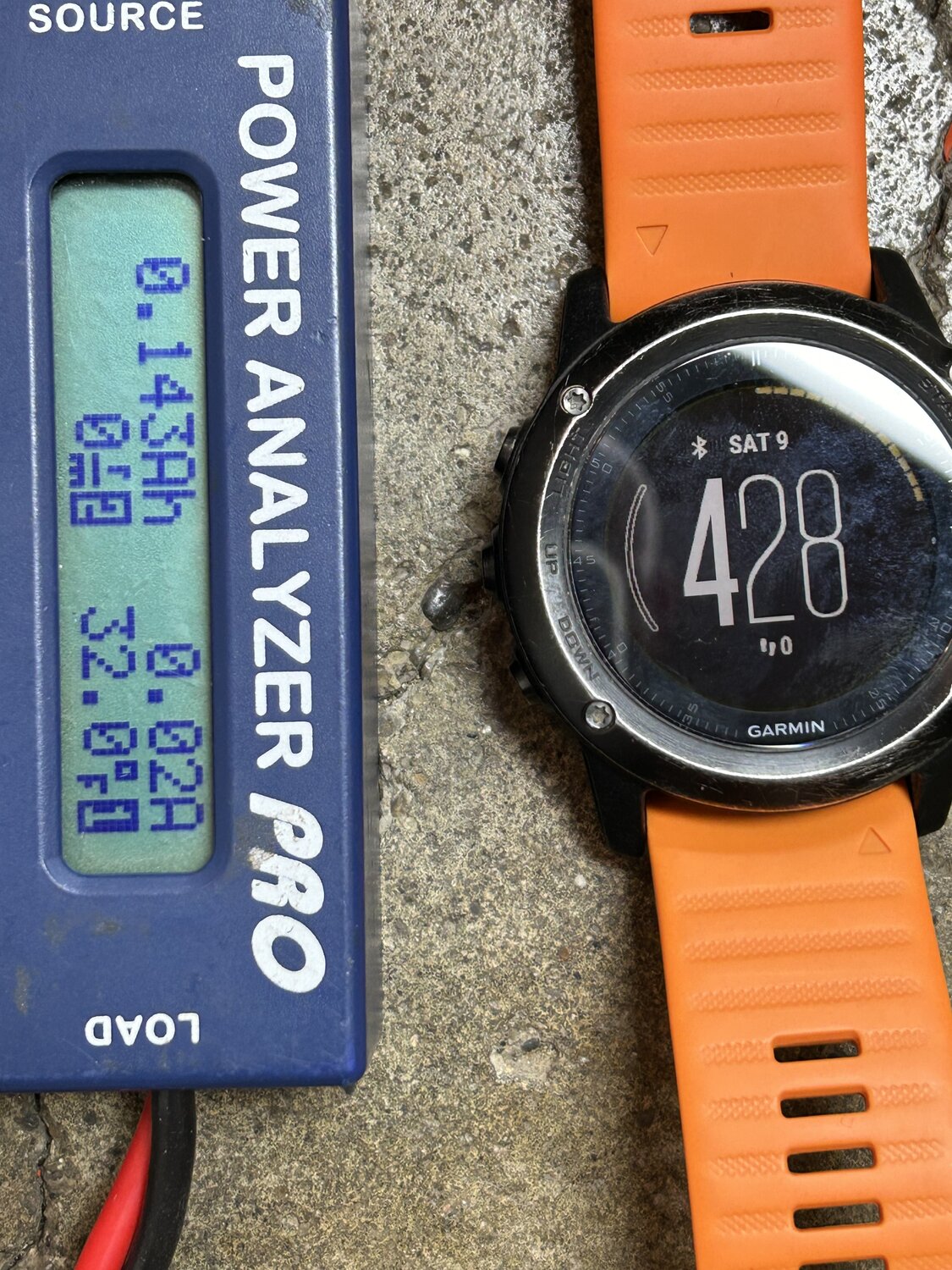

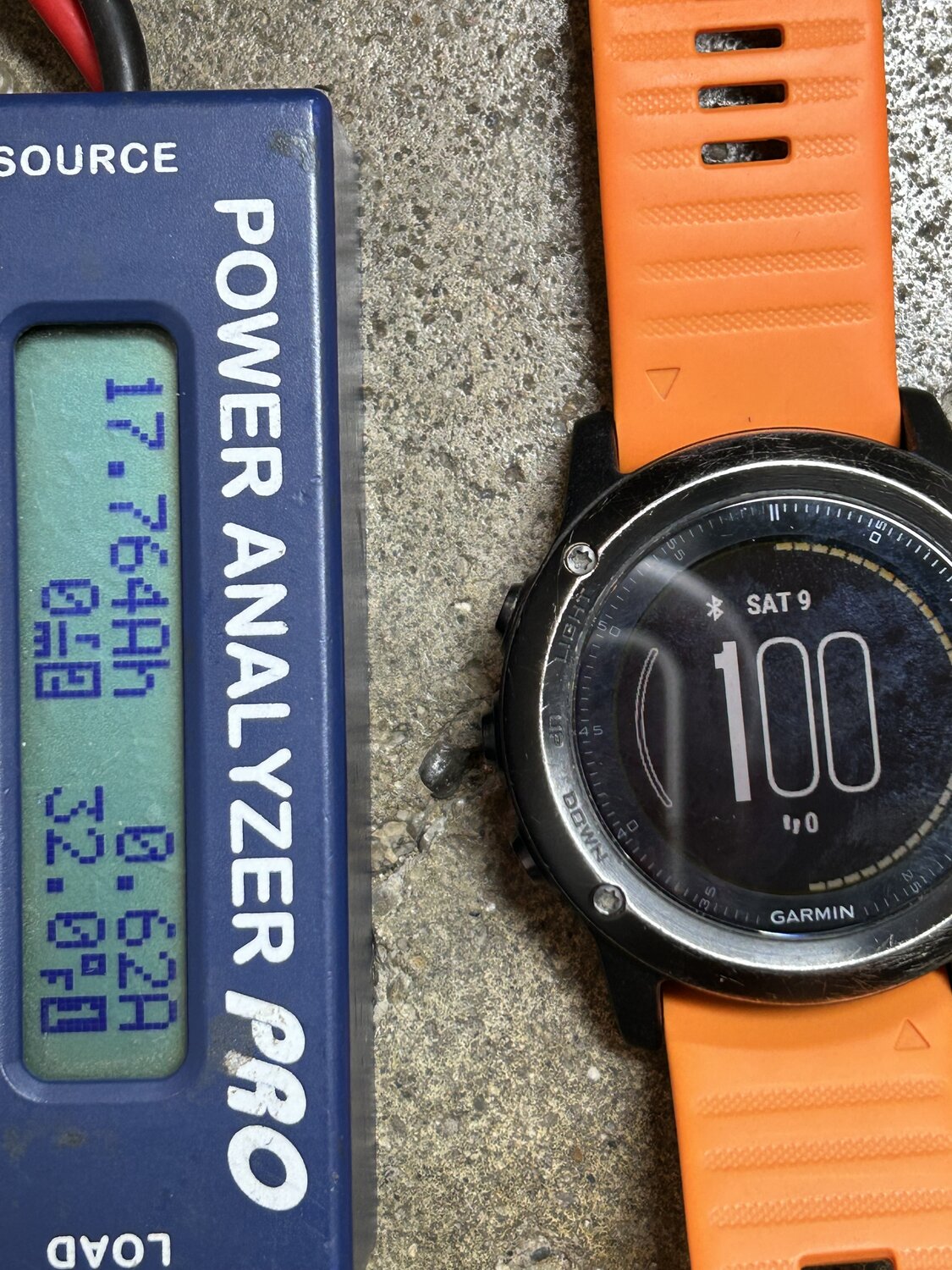

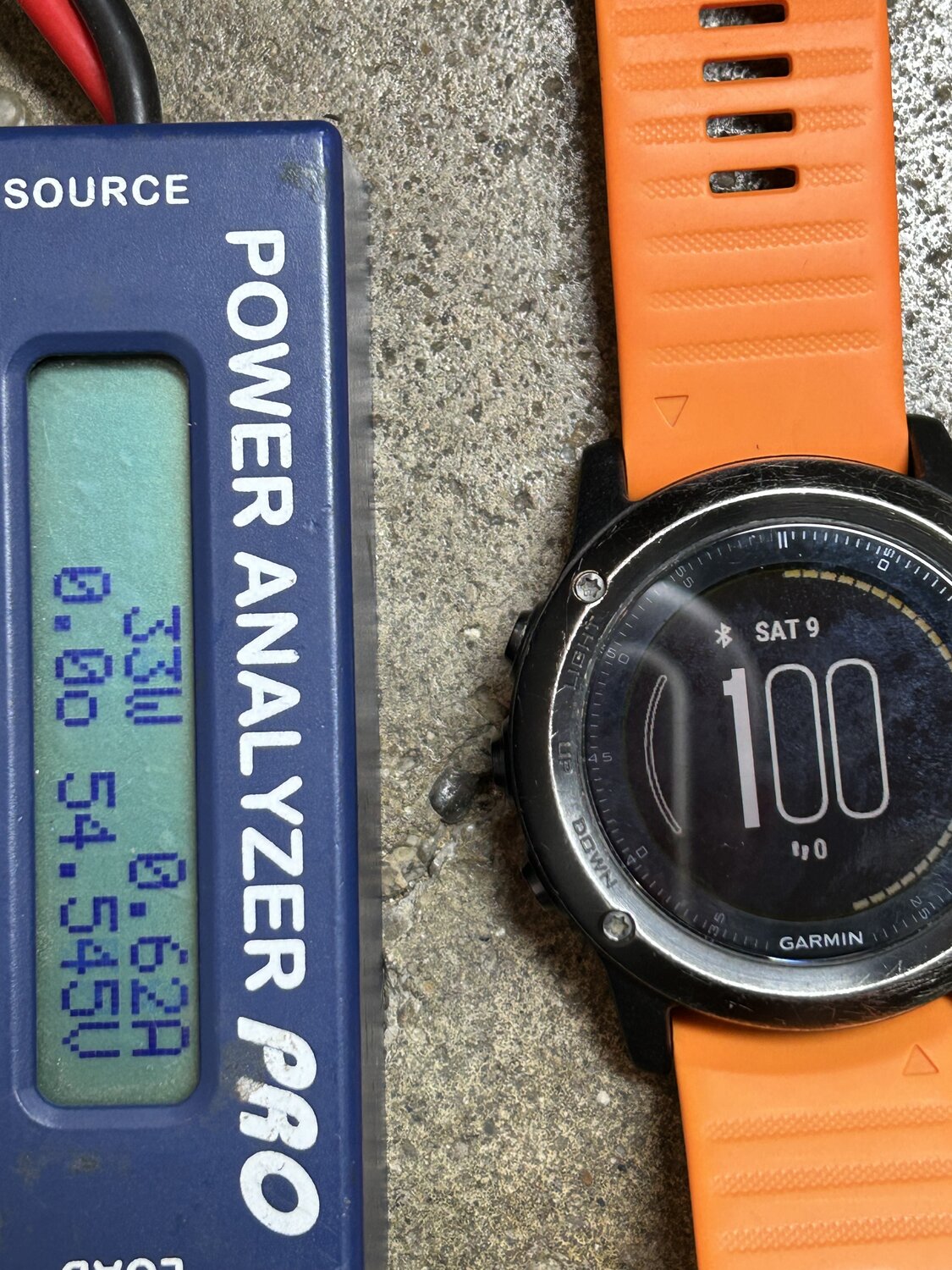

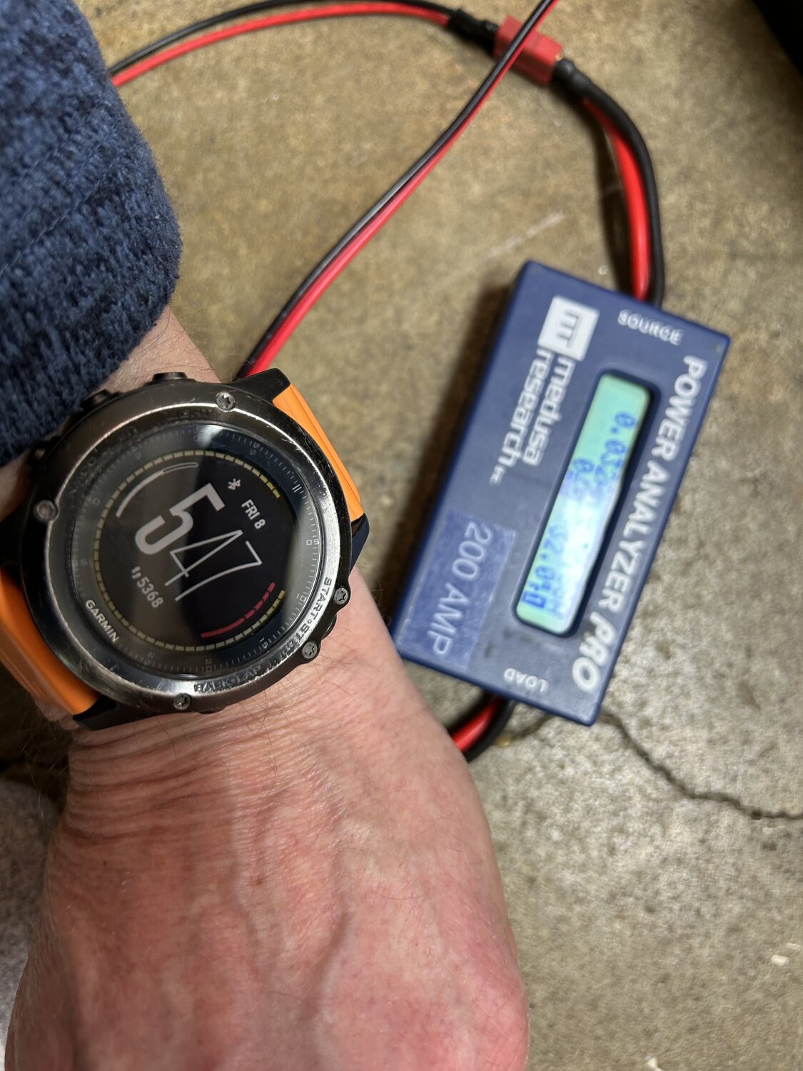

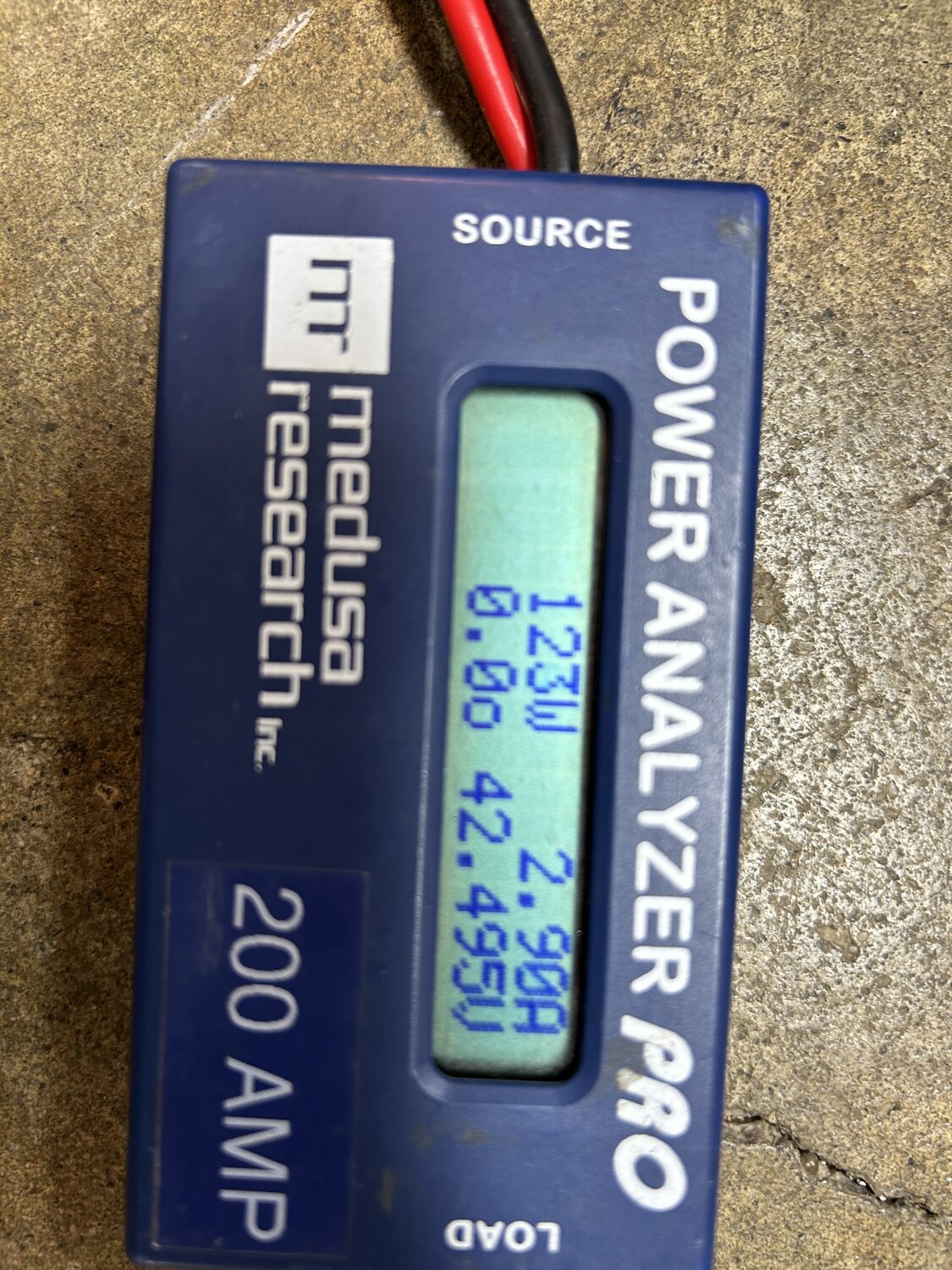

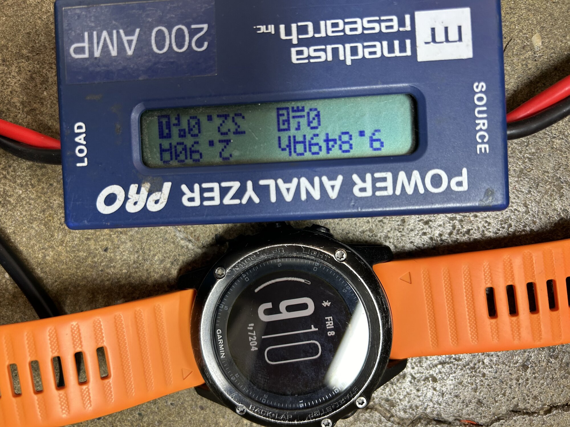

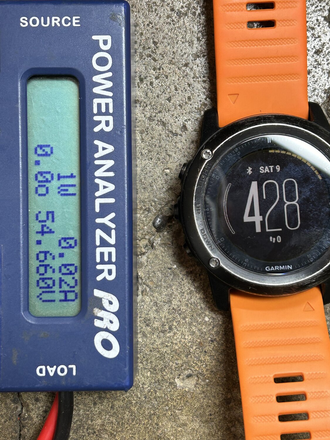

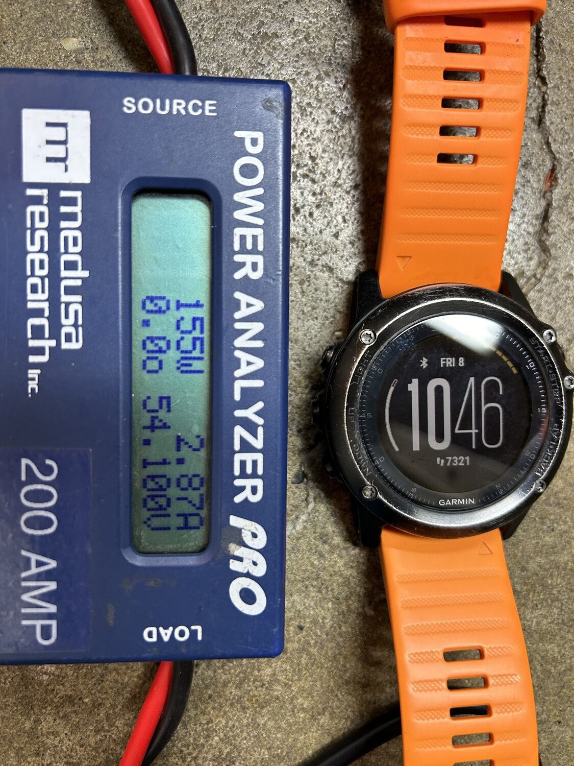

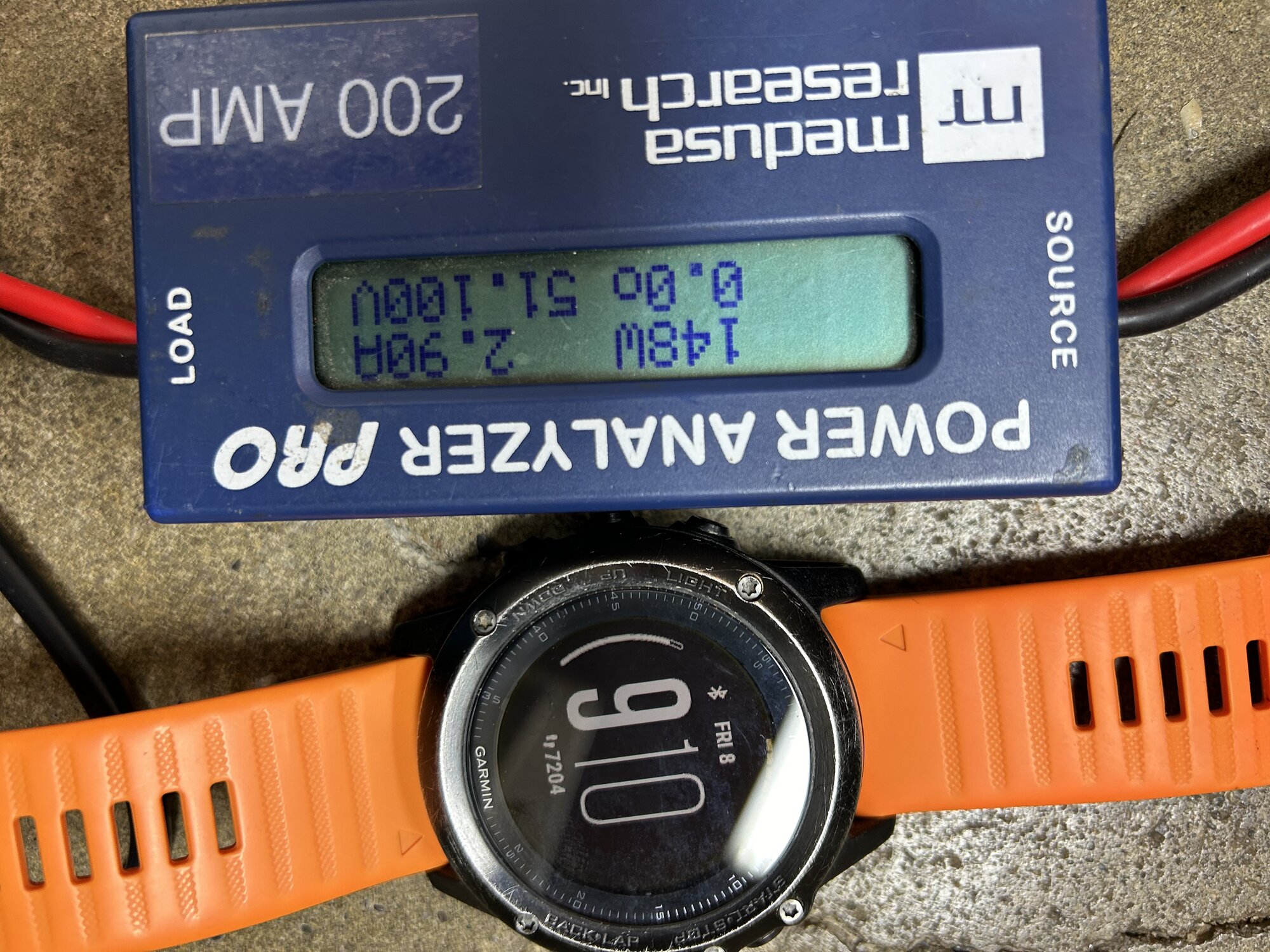

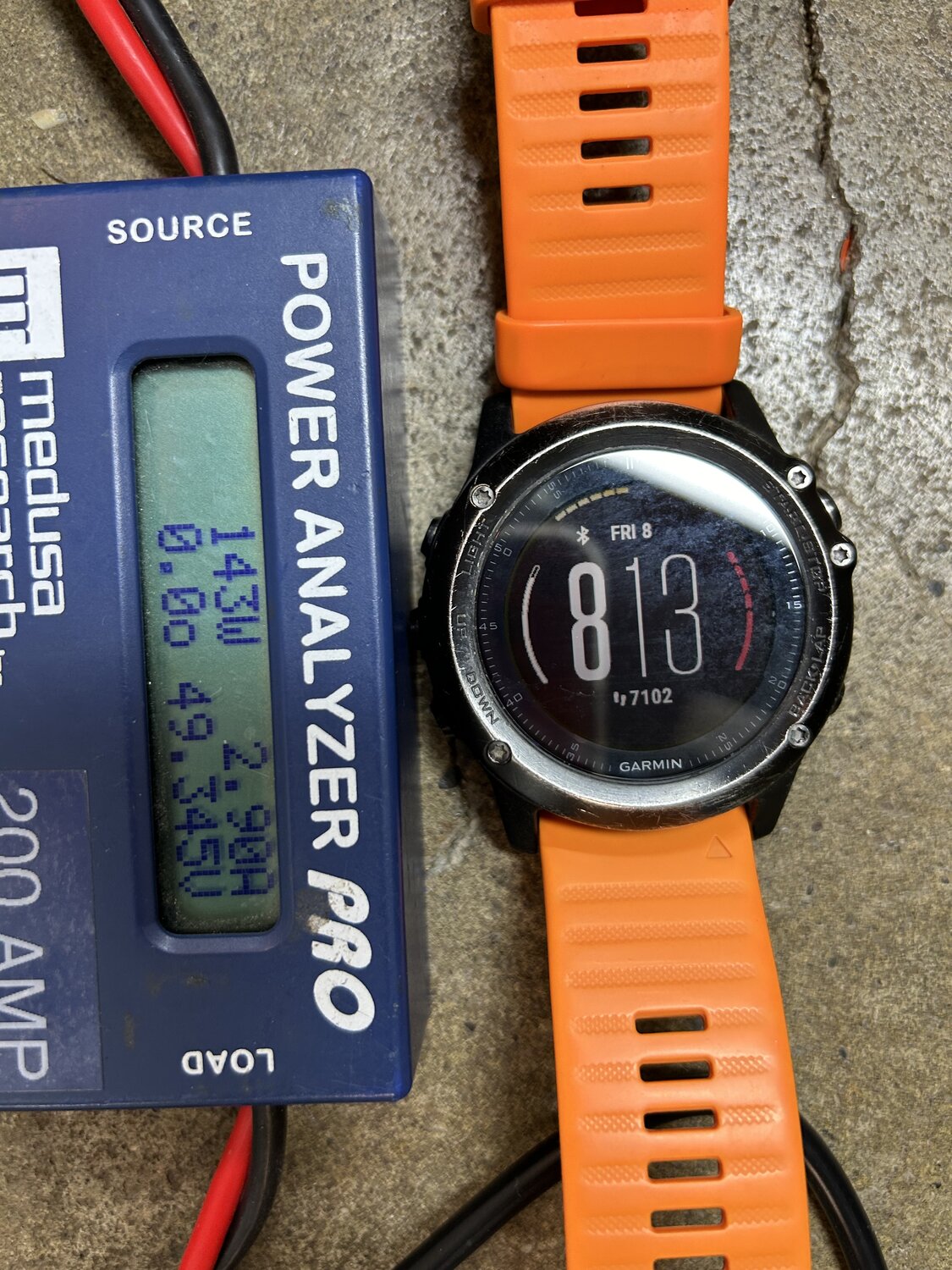

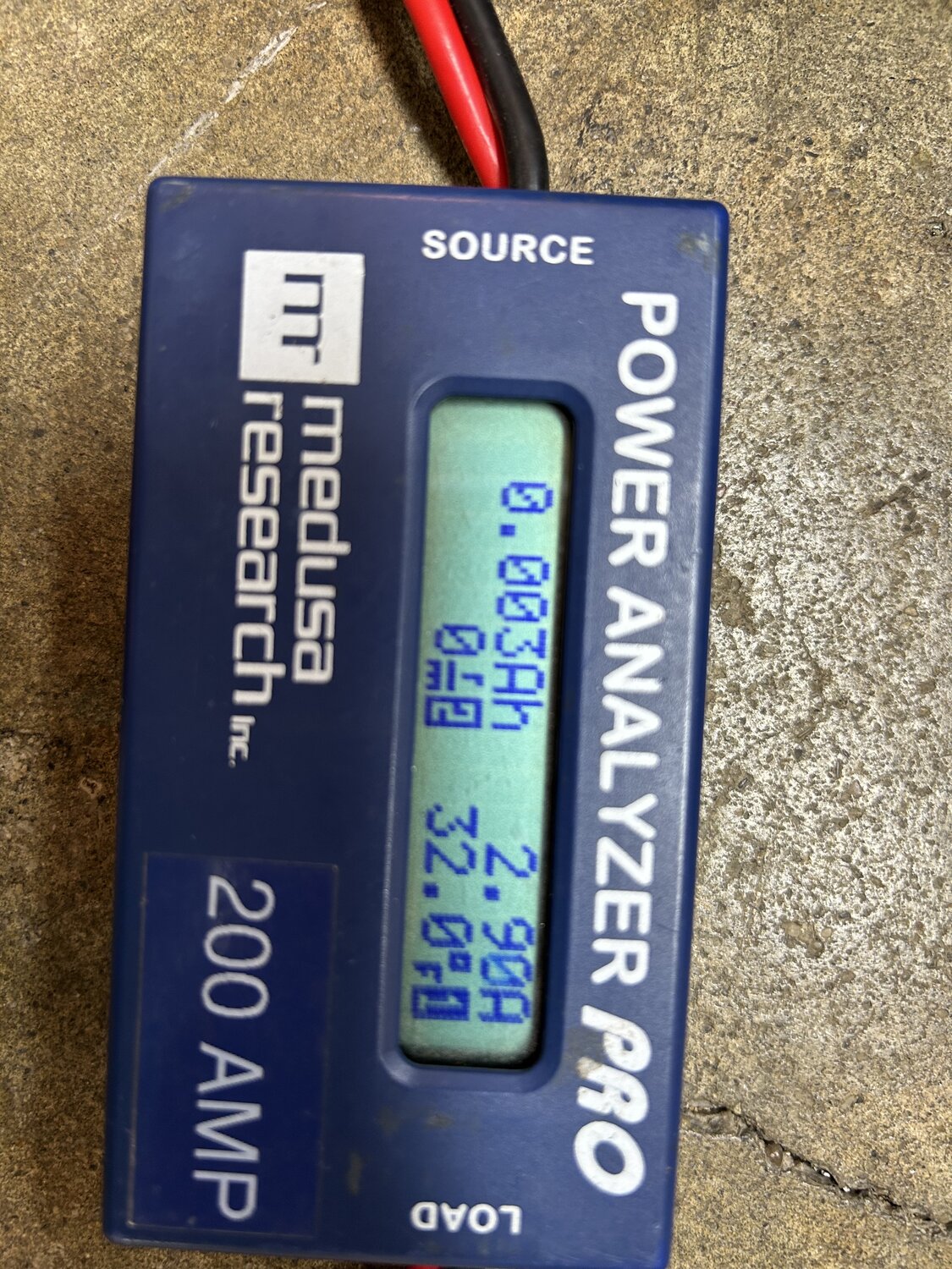

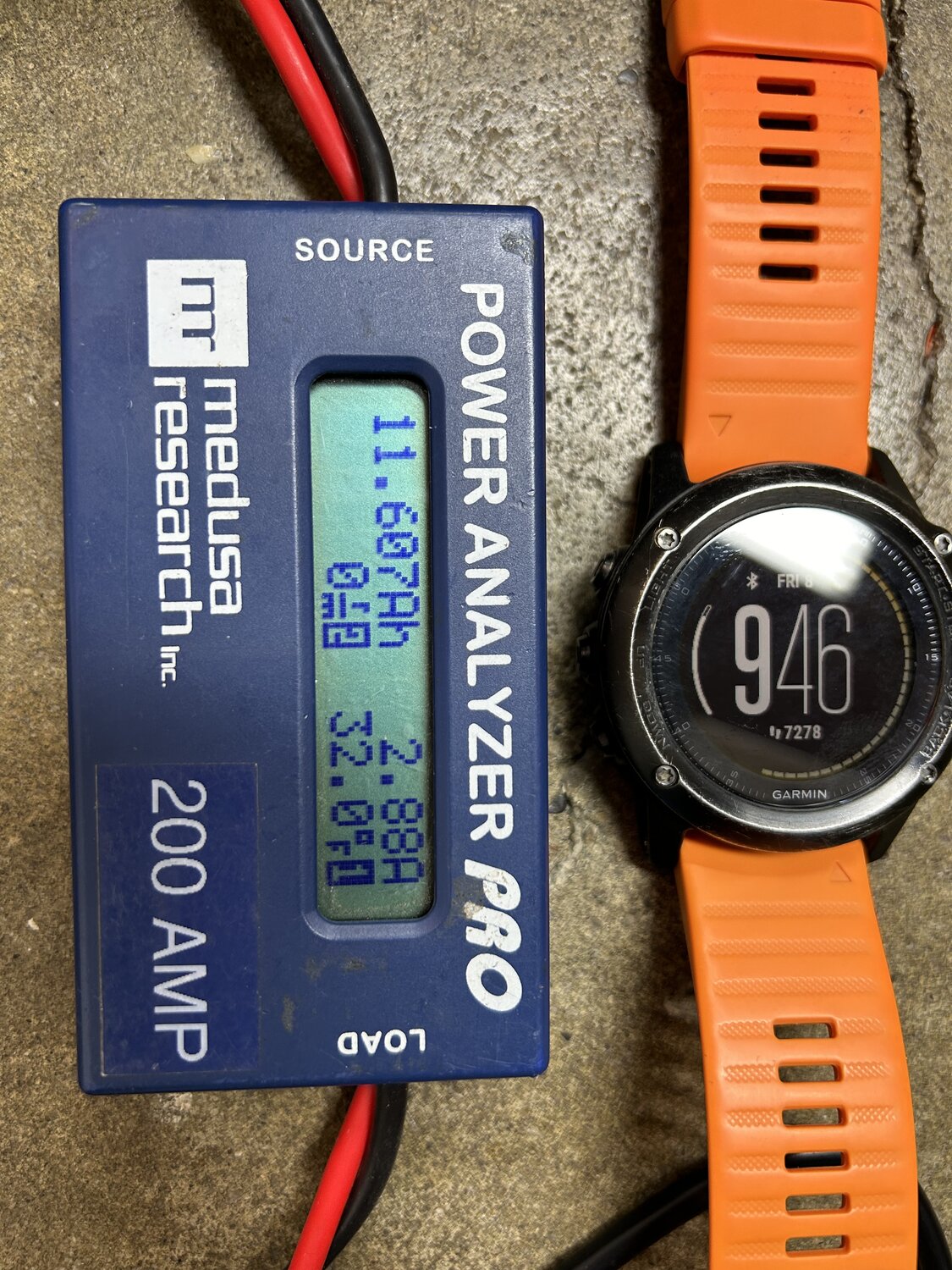

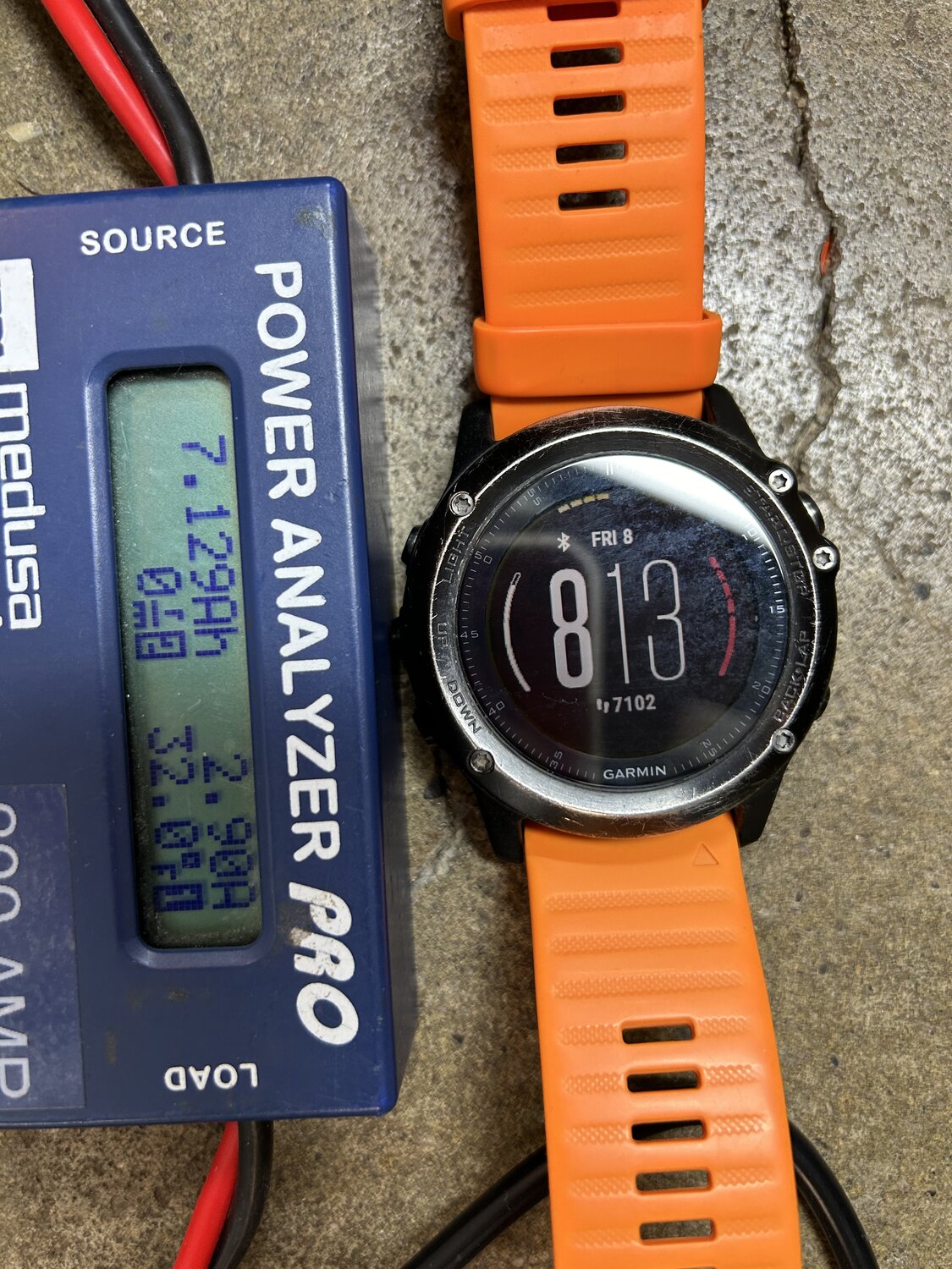

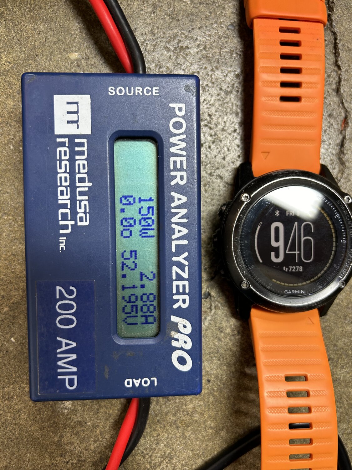

Screen 1 important bits are 2.9A charge rate, .003 Ah accumulation. Screen 2 important bits are 2.9A charge rate, 42.5v upon plugging in charger, 123w from charge rate X voltage. The battery registered 40.05 volts prior to plugging in charger and was lower than this when received. The charge level indicator lights wouldn’t come on at all when received. Likely a touch under 40v so bms shut it down I guess. Charging began at 5:47pm and last I saw it at 1am it was at 17.76Ahr and close to cut off voltage and current had dropped to about 0.6 A so guessing it was balancing cells. At 4am it had already finished. Probably is close to 20Ah pack is able to start the charge at about 2.8v per cell rather than slightly above 3.0. I’d love to know how many cells in parallel and cell stated capacity. An educated guess by looking at how many cells can be placed next to each other it looks like 18 cells down the length of the battery and 5 cells going up the height of the pack by alternating cells (packing as close as possible. 90 cells. Call it 91 and on 13s you get 7p. 2.8A cells get it real close to 20 over all

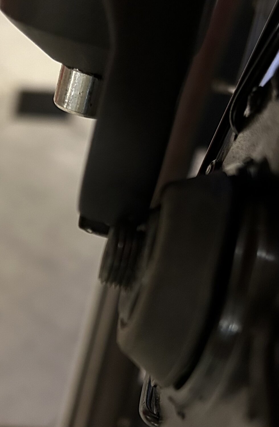

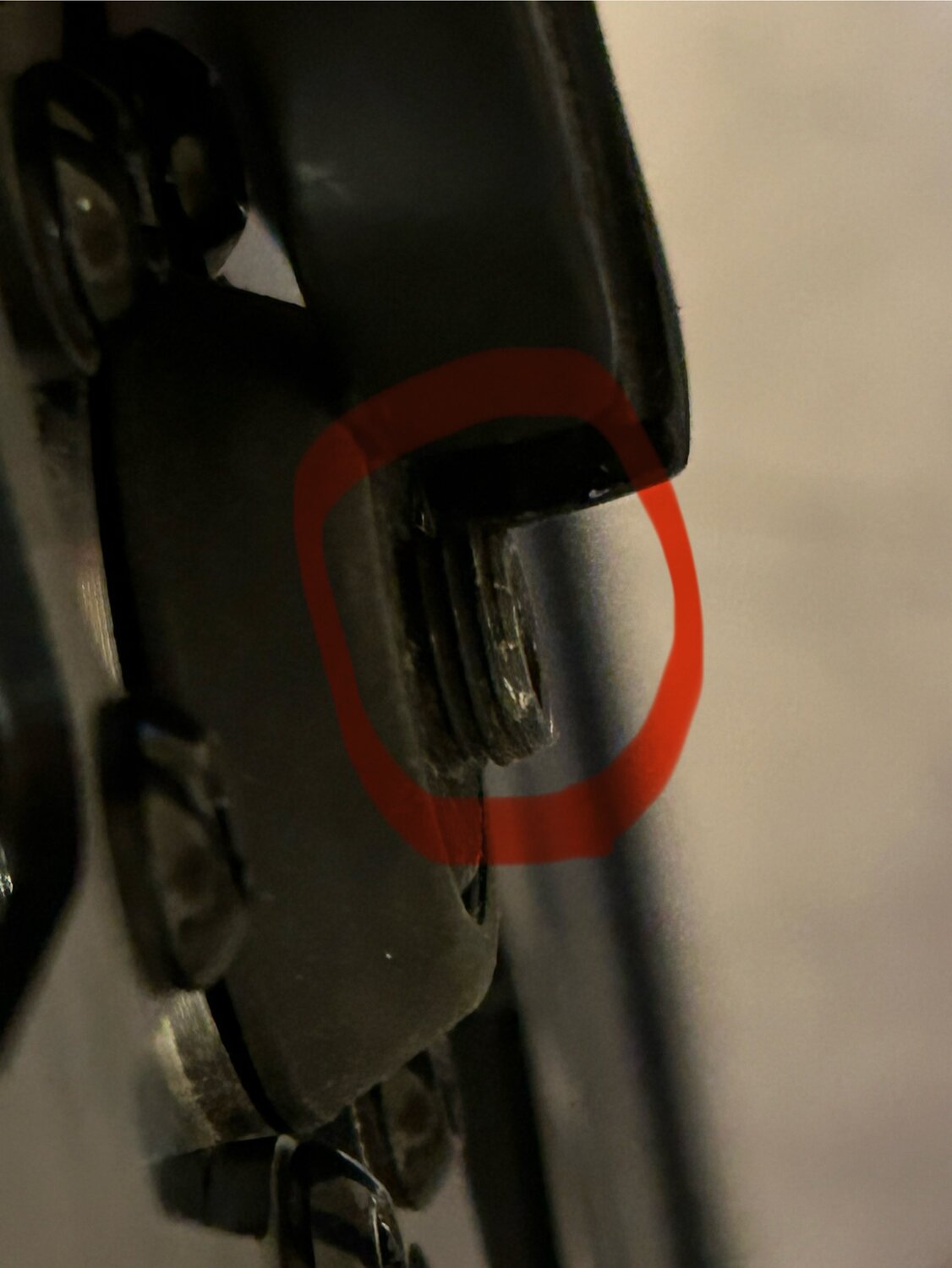

Loosening the bearing nut helped a lot. I can still feel it's not perfect like maybe a sealed bearing might be but it's way better than it was with just a tiny loosening. If all is well with this bike I will look for a longer axle by about 1/2 inch for piece of mind since it's not sticking out much to catch my forks. I know I read something about if you ride more than 10 miles it can't be returned. I'm sure there is a window of time also.
Short axle. Only about 1/3 of what could be accepted in the fork.

I think that's the way the quick release front wheel/axle is supposed to work. the "skewer" squeezes the fork together against the bearing nuts with their serrated faces. Looking at your pics, I see I'm definitely missing a rubber seal for the bearings, my wheel only had one on one side, thought that was strange. Yes, saw the 10 mile max return BS as well, hence a couple rides without turning on the bike, just pedaling, odo. shows 1.7 mi. at this time.
