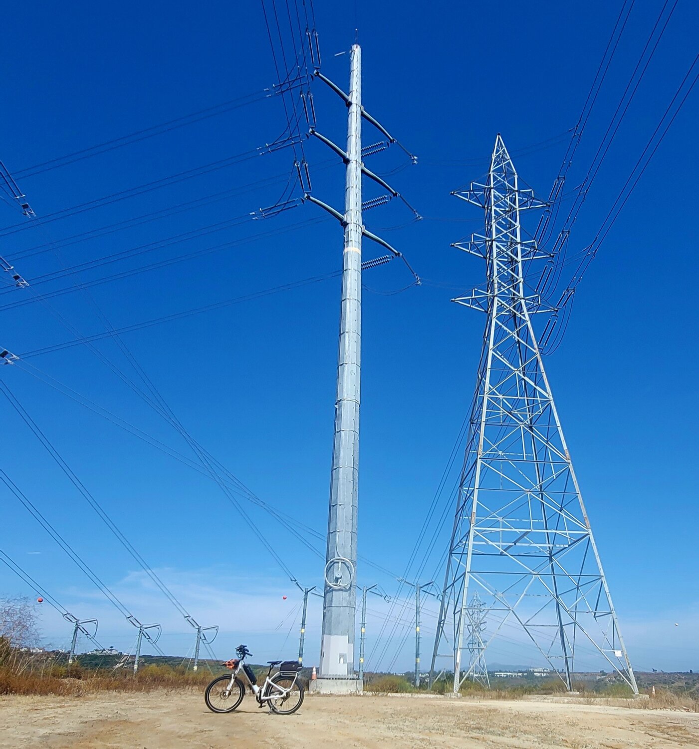

Wow, who knew? Like a leashed dog to a squirrel, my ebike pulled me to this happy place under a nexus of major regional transmission lines near our local power station. (OK, just kidding.)
Didn't notice any microshocks while the bike basked in the EMF, but gotta go back now just to see if I can feel them. The voltage could be high enough, but the lines are far overhead.
Maybe I should wear a foil helmet liner next time. Too many wild ideas already without adding EMF-induced flights of fancy to the mix.
