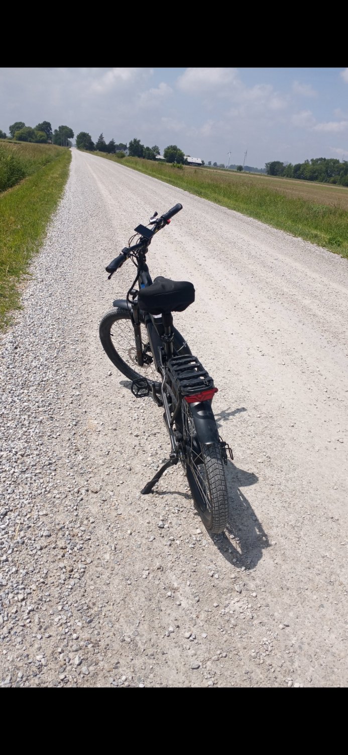

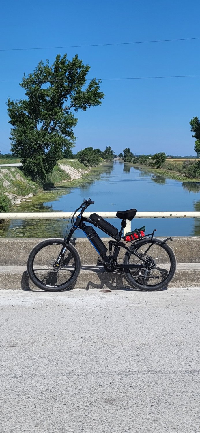

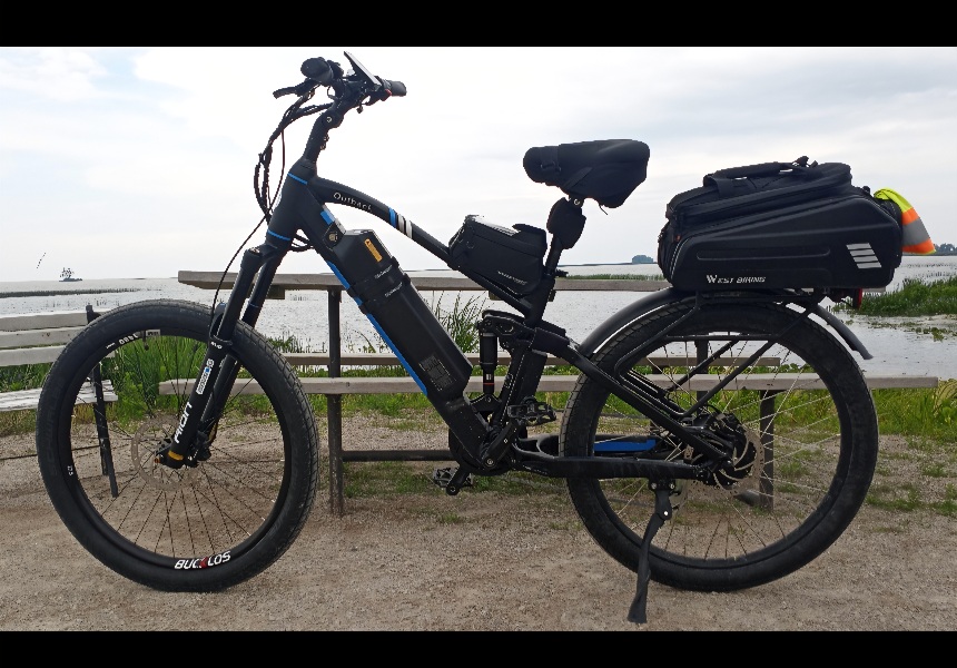

I voided my warranties on both my ebikes the day that they arrived.
it is someone else's, you are just paying to support it,
Both my ebikes and the battery on my first e-bike had problems.
I fixed the problems myself.
Good bikes are owned by their masters and fully programmable by their owners.
My "Monstrosity" as you call it, is Completely Owned And Supported by me alone.
I refuse to kiss 💋 ass with any proprietary establishment.
I learned (with your help actually) to not buy a proprietary ebike.
Both my ebikes came with off-the-self brand name components that could be researched.
Nothing proprietary, except the electrics/electronics.
Who controls your bike?
I do.
I rode over 7,000 km last year.
Over 5,000 km were no-hands.
I can only go 32 kph, so I keep it interesting by riding no-hands.
The Best Days are when I have 20 mph crosswinds and I Have-To-Grab the handlebars to keep from being blown off the road.
