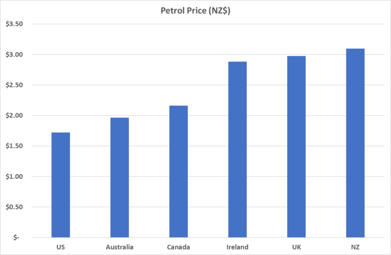

In these times of outrageous petrol price increases, has anyone got any relatively simple ways of measuring a charge of our fancy ebikes and calculating that in dollars and cents?
New Zealand has some of the highest petrol prices in the world:
(Source)
Would be interested in any tips on how to get a sense of cost of charging my SuperCharger 2!

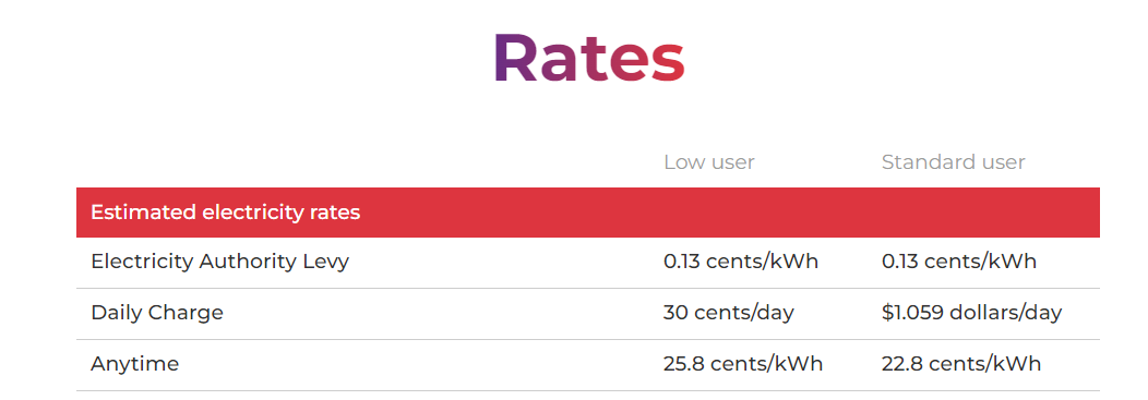

so I found I'm with Meridian Energy but trying to find their cost per kWh on their website virtually impossible! using their live chat on their website now to see if that helps!
Ditto .
Check your last bill. Mine states the supplied kWh for the period. Their kWh cost will not include the fixed daily charge. Hence my suggestion above.
Turns out I was wrong on Meridian, it's Contact - their website was a bit clearer...
so maybe around 32c per charge give or take.... not bad for regular 150km+ range!
