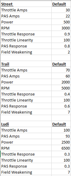

To start this discussion off I have posted the stock VESC tune settings for 2022-05-09 firmware.
My use of the x2 has been for trails that have been carved out of the old Florida Phosphate mines. I have been testing a few settings and wanted to share them. Most of my rides are in PAS 1-3 and when needed a little goose of the throttle. I have lowered my AMPS Max (Bike cfg) tab since I have a 30amp BMS battery not sure how much it plays into the overall tuning. My PAS Amps was lowered to allow for more useable PAS levels from my 860C display which is set to 1-9 levels. I lowered my Power level to 1250 which I guess restricts the max output. RPM was maxed but not sure it matters for trail riding. Throttle Linearity I have set to 80 which I believe reduces the shock to the drivetrain and allows the ramping of power from the throttle. I am still trying to get a balance of power from my tuning. A 3 hour ride with 20miles takes the battery down to 35%. Not sure how low the battery can get before running out of power on the v2 controller. Stock controller reduced power at 20% and caused the low battery display at 18%. If this is the case then 3 hours or 20 miles is my max for the 840 watt battery.

To update from my last ride which was 15 miles and I had 55% battery left. Mostly trail and punchy climbs which is my standard ride. Level 2 PAS for flowy trails was great. Level 3 PAS was great for the more techy sections with a few short climbs. Level 4 PAS I did try on a few really tough climbs and it made them much easier. But I like to get a workout too :) Still plenty of power to hit 34 mph on the pavement.
Interesting - I tend to use less battery than you are showing. I rode the 18-mile Starkey ranch trail yesterday on assist 1 (of 5) with power limited to 750 watts. It used about 13% battery. Pretty flat, but I weight 260 lbs. A couple weeks ago I rode a 20-mile loop in Tsali NC that was a blast - lots of ups and downs about 2100 feet of gain total. That again was 90% in assist 1, but it used probably 15% battery (maybe a little more).

I don’t ride with the VESC app. My current settings provide enough power. Most of my riding is flow trails and technical. Power setting 3-4 of 9 is good for all my riding.

I did not revert back to stock controller. Still have the v2 controller. Had a second controller from another bike. Not too many steep climbs here in FL. I decided to lower the power output for better trail riding. Too much power makes the bike tricky to keep under me. I would start with the stock trail settings that come with the controller before changing the settings. "Power is nothing without control"
