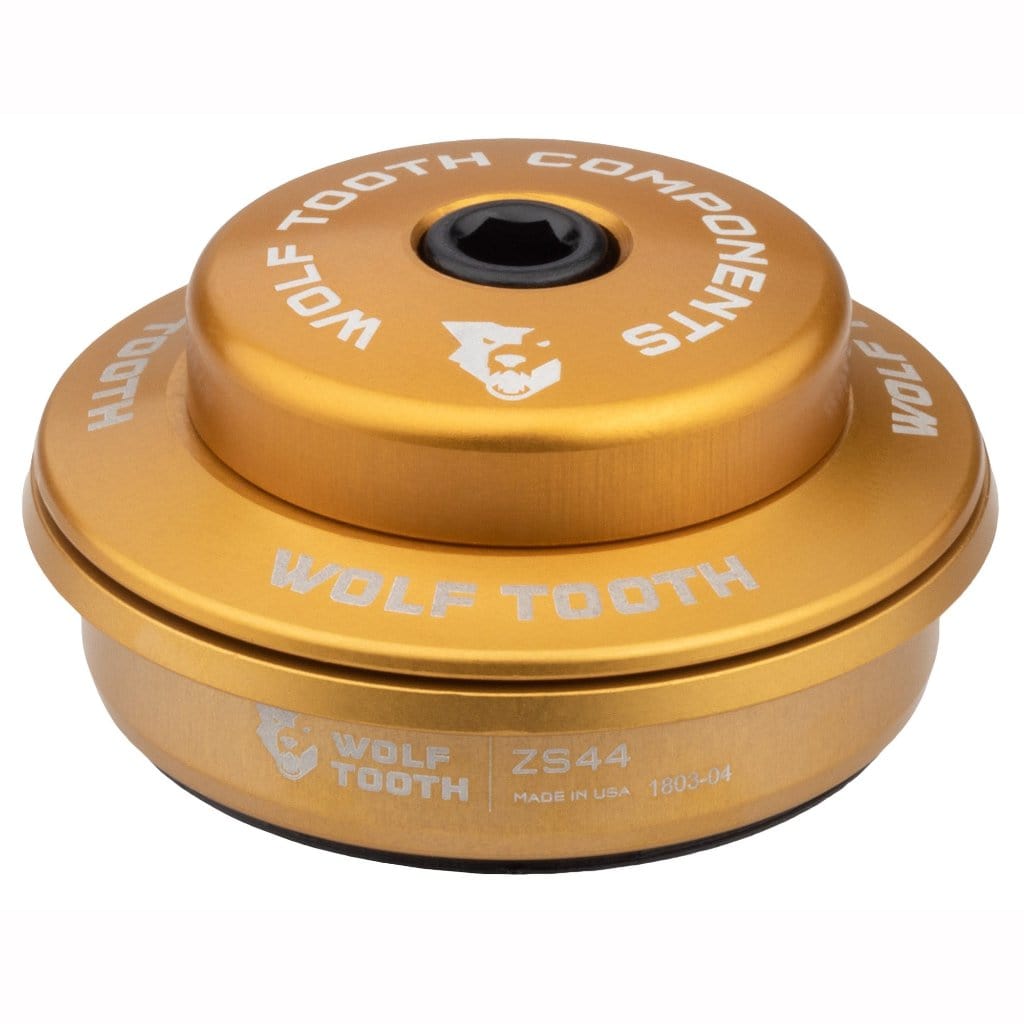

If you just want to stick with the stock geo. Headset ZS44/28.6 Upper, ZS56/40 Lower/Long 115-140 mm
Wolf Tooth Web Site for the headset. You will need 1 upper ZS44U-5MM-BLK-B and 1 lower ZS56L-40-BLK-B
