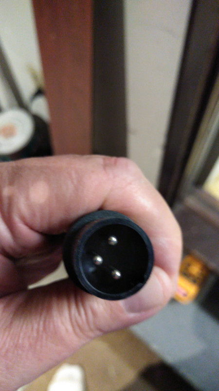

Mine's a 3 pin XLR connector, and I think most all Giant chargers are.

Dave tells me the connector is a 3 pin XLR... now I’ve got to search out what that is. At least this looks very doable. And for reasonable cost too!

Here's the male charger end. Female is on the battery covered by a rubber flap.
XLR is what is used on microphones.

The two links to 3rd party chargers on Amazon appear to be the right XLR 3 pin type.
