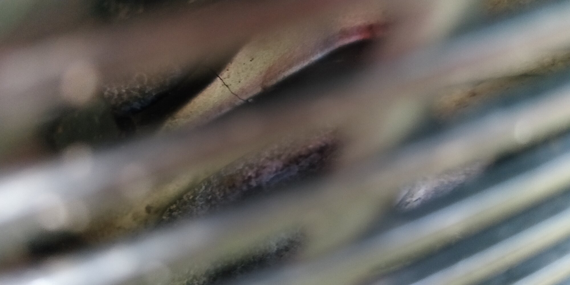

Broke a second bike and again at around 1500 km. So that's 2 bike in a single year... This bike was actually a loaner Como 2.0 (2018) that I got brand new in November 2019 while I wait for proper replacement Como 4.0
The frame is not completely separated yet but i guess its just a matter of time. This is super upsetting because I know my new bike will break too... Como and Vado are not for serious commuter and that pretty obvious. And its such a waste...
Not good news... I suspect that the lower frame web on the motor mount is too narrow and will require a redesign to fix the issue.

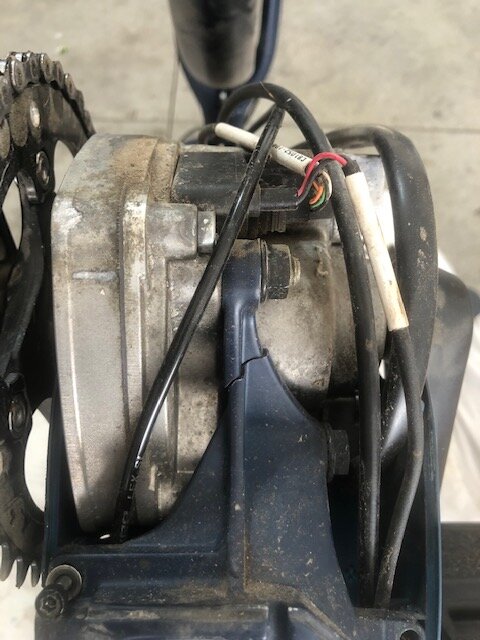

I'm the newest victim, I guess. I ride a 2018 Como 2.0. For a week or two, my chain felt "chunky" with any amount of torque applied to the pedals and I noticed that the "bottom bracket" was loose. After watching a couple YouTube videos on how to tighten the BB I removed the plastic motor enclosure and realized that the Turbo doesn't have a traditional BB. I eventually noticed that my frame is cracked. I took it to local Specialized dealer and I'm waiting very impatiently to see what happens next. I'm a daily commuter and I miss my bike and riding so much!
Thank you to everyone who has posted on this thread. It makes me feel better knowing that the outcomes have been almost all good. Is there a step-down in component quality from the 2018 to the 2020s? Should I be requesting a 3.0, 4.0, or would they be willing to upgrade to a 5.0 (by paying some or all of the difference)? What if the color they offer is hideous? (I'm looking at you, 3.0 Lilac.) What about the worldwide bike shortage? So many questions!!! ARGH! I'm feeling so sad :(
I've included a video I took in my garage after I spotted the break in the frame. Hopefully it loads ok. Picture, too.
Any advise on how to deal with the LBS and Specialized is appreciated.
Thank you to everyone who has posted on this thread. It makes me feel better knowing that the outcomes have been almost all good. Is there a step-down in component quality from the 2018 to the 2020s? Should I be requesting a 3.0, 4.0, or would they be willing to upgrade to a 5.0 (by paying some or all of the difference)? What if the color they offer is hideous? (I'm looking at you, 3.0 Lilac.) What about the worldwide bike shortage? So many questions!!! ARGH! I'm feeling so sad :( I've included a video I took in my garage after I spotted the break in the frame. Hopefully, it loads ok. Picture, too. Any advise on how to deal with the LBS and Specialized is appreciated.View attachment 60510
Sorry to hear about your cracked frame... the good news is that Specialized has been replacing the entire bike is some cases.
I would recommend that you tell them what replacement you want... and let them know you would like a loaner during the process. ;)
Sorry to see this! I can take apart my Vado 5.0 I've been commuting to the shop on, I've got about 1k miles on it, turbo all the time;)
Your 2018 2.0 is now the 2020 3.0. If you're up for it, and based on you commuting, see if they'll credit you to get the Como 5.0. The 1.3 motor, larger battery, upgraded brakes, drivetrain, and rack/fenders are worth it!
