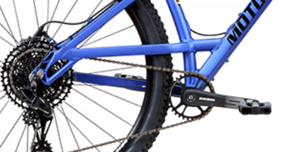

THis is the Mototobecane that was mentioned by the OP. Add a mid drive, Wrap a belt around an IGH and slide in the rear wheel? Probably need a tensioner.
Yes that sort of frame is just what the Dr. ordered for a belt, where there is no need to have a break in the frame. Don't know how you would tension it with vertical dropouts though. I am sure there is a way as my own belt drive bike had verts and it was do-able. But a real PITA to tension. Its been a few years so I don't remember exactly how it got done.
