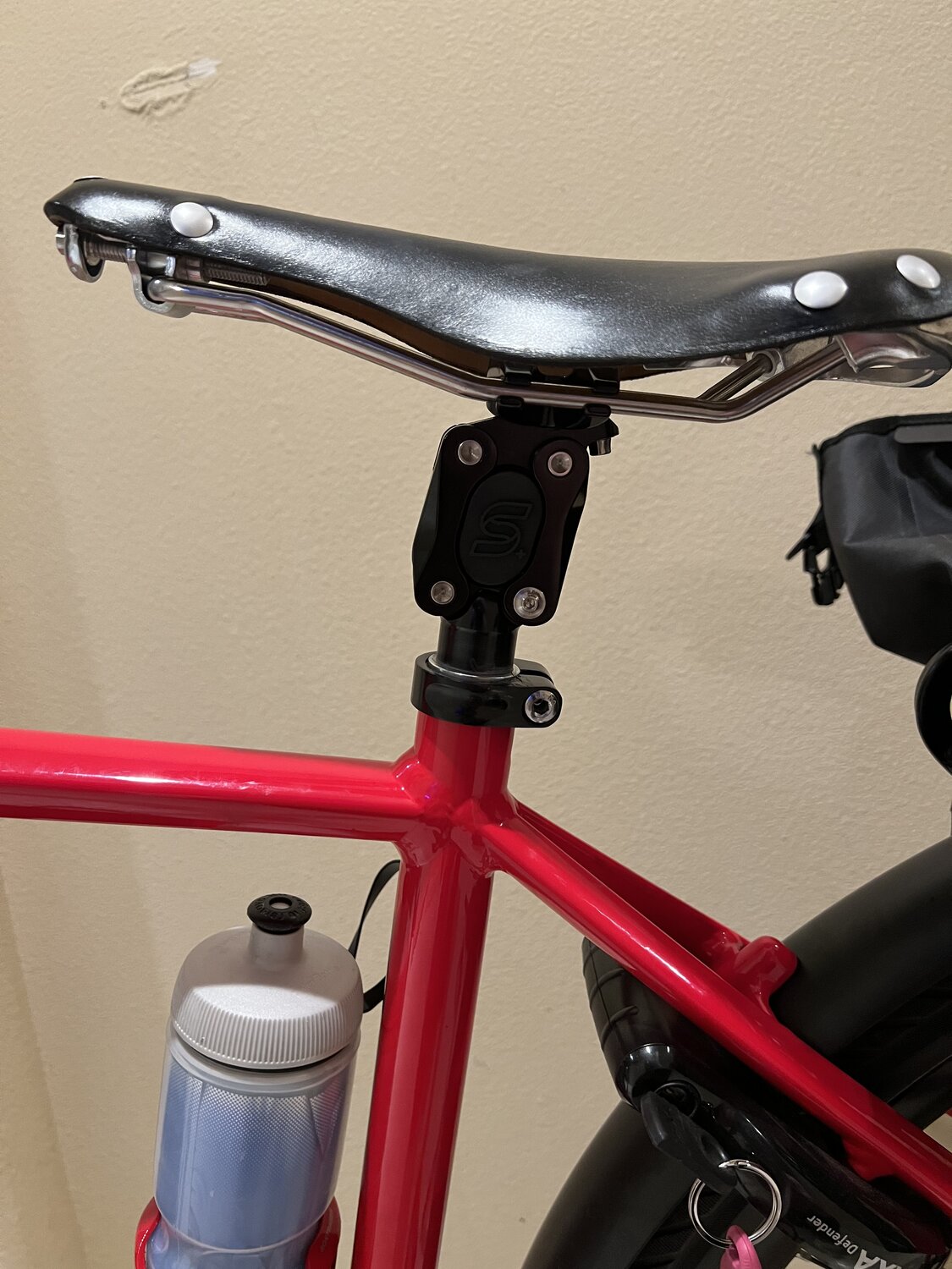

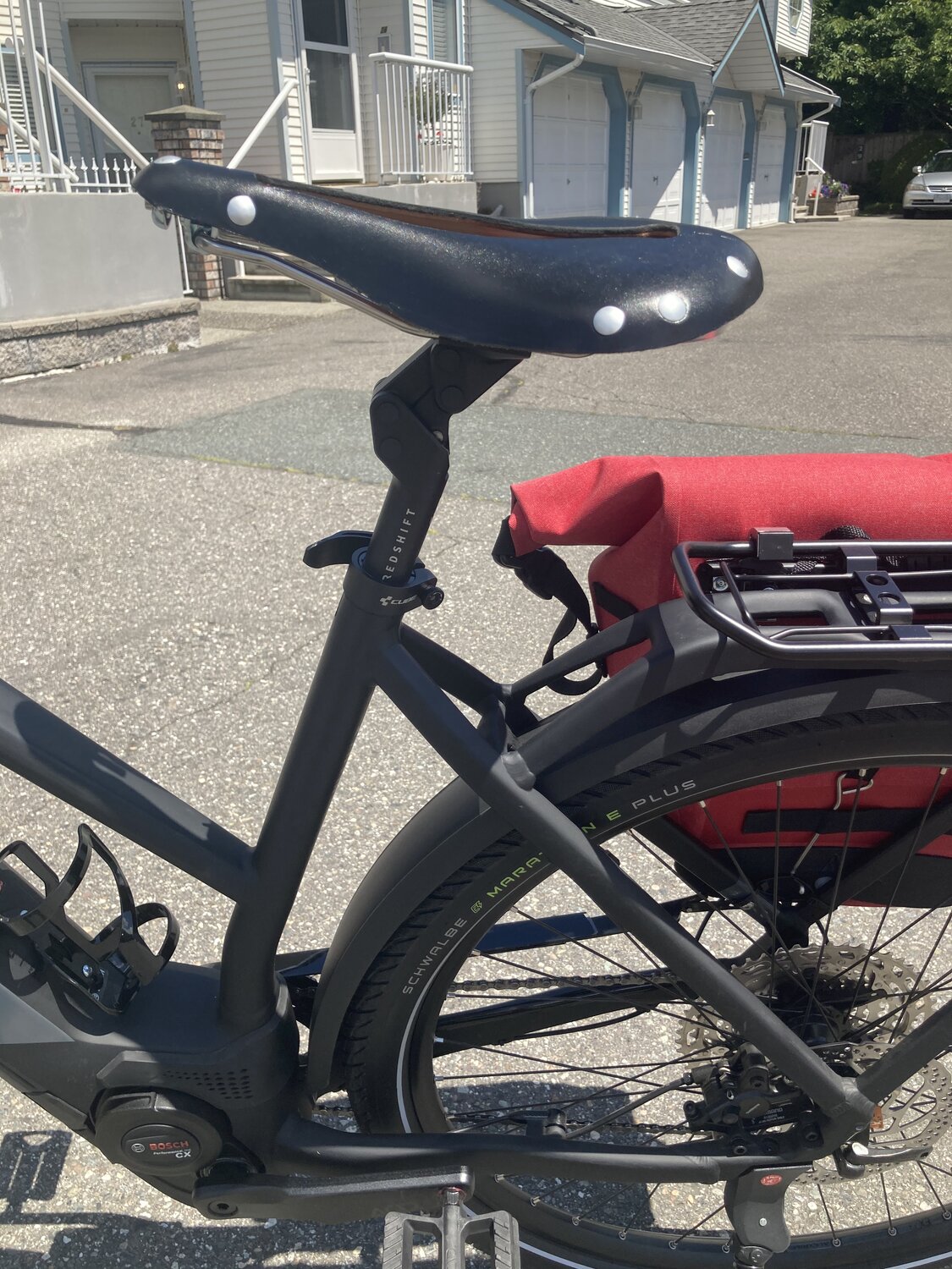

Maybe worth noting.....when I changed my seat out to a Selle Anatomica (H2?) the seat rails don't extend down near as much as the stock seat in my post above. That is, the seat is much closer to the top of the seat post requiring me to raise the seat post up a bunch to get my seat's ride height set. With the SA seat I suppose I could have used the Kinekt post after all. Just note between the two pics how much seat post extends out of the seat tube. CN
I use a Selle Anatomica X2.

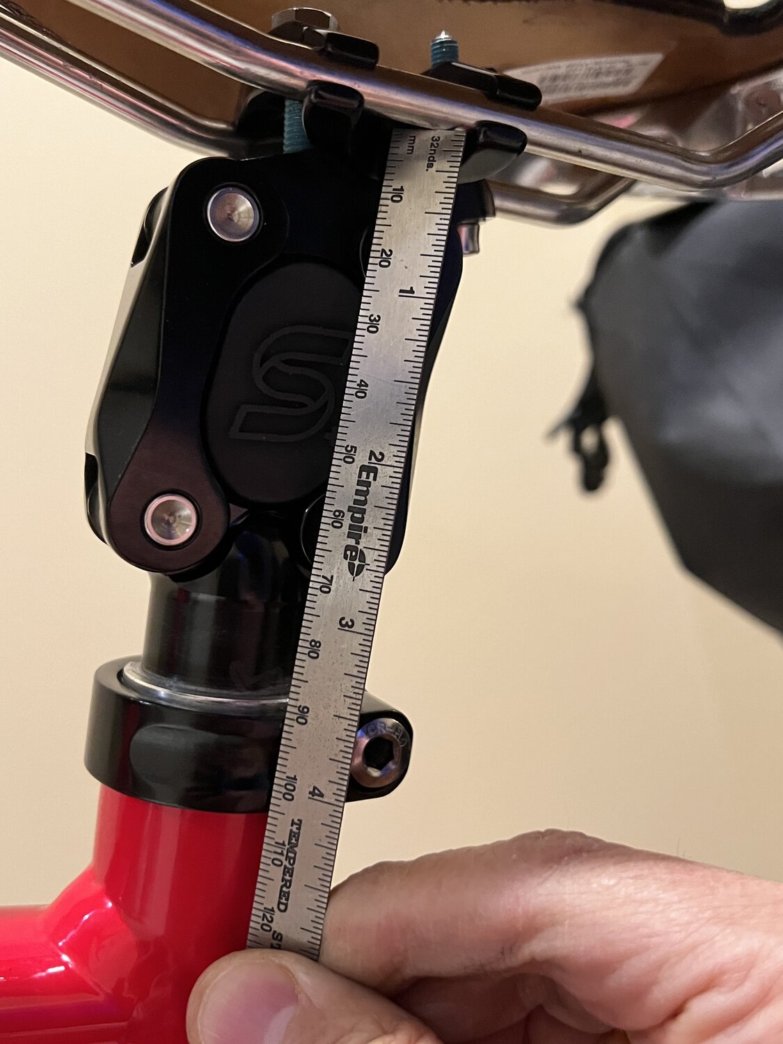

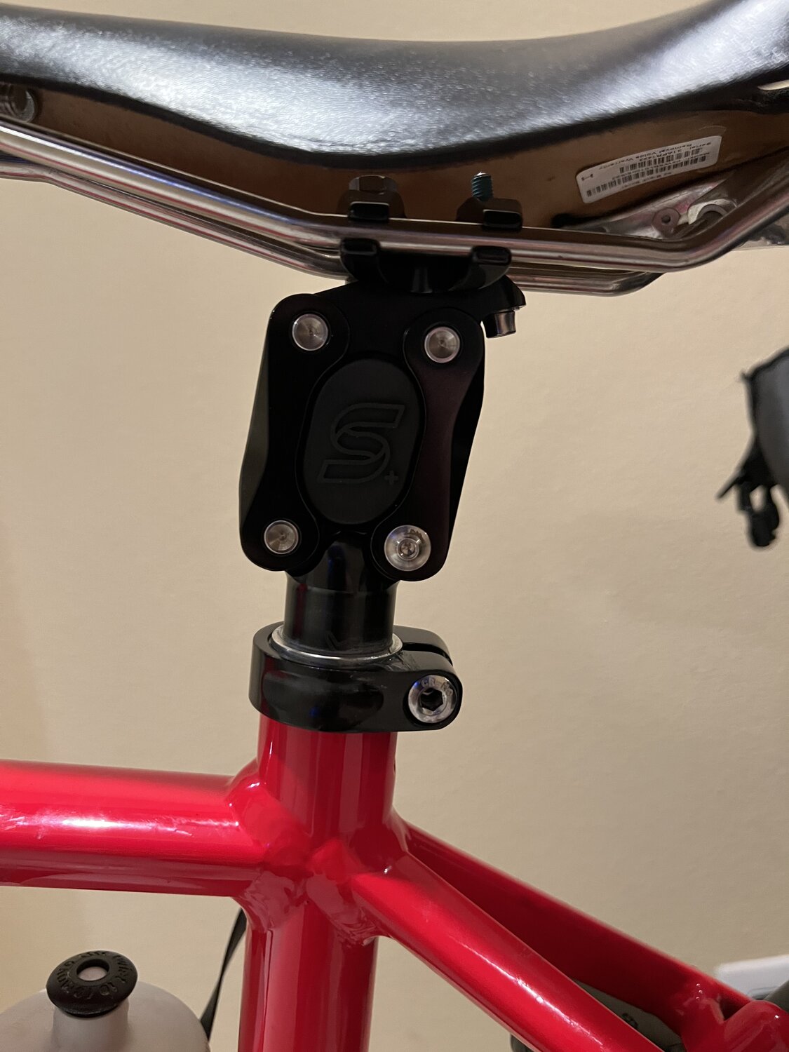

My clearance between the rails and seat collar post is 88 mm.
80 mm is the minimum clearance I was given by CaneCreek (80mm) for the eesilk+
I purchased the aluminum eeSilk+ for my Gazelle Ultimate T10+.
The tube would not go all the way in because the bottle cage screws interfered with full insertion.
I cut 2.5 inches from the distal aspect of the tube.
As mentioned above and as you can see in the pics, 80 mm is the minimum clearance between the rails and seat collar post.
Will see tomorrow how it rides.
