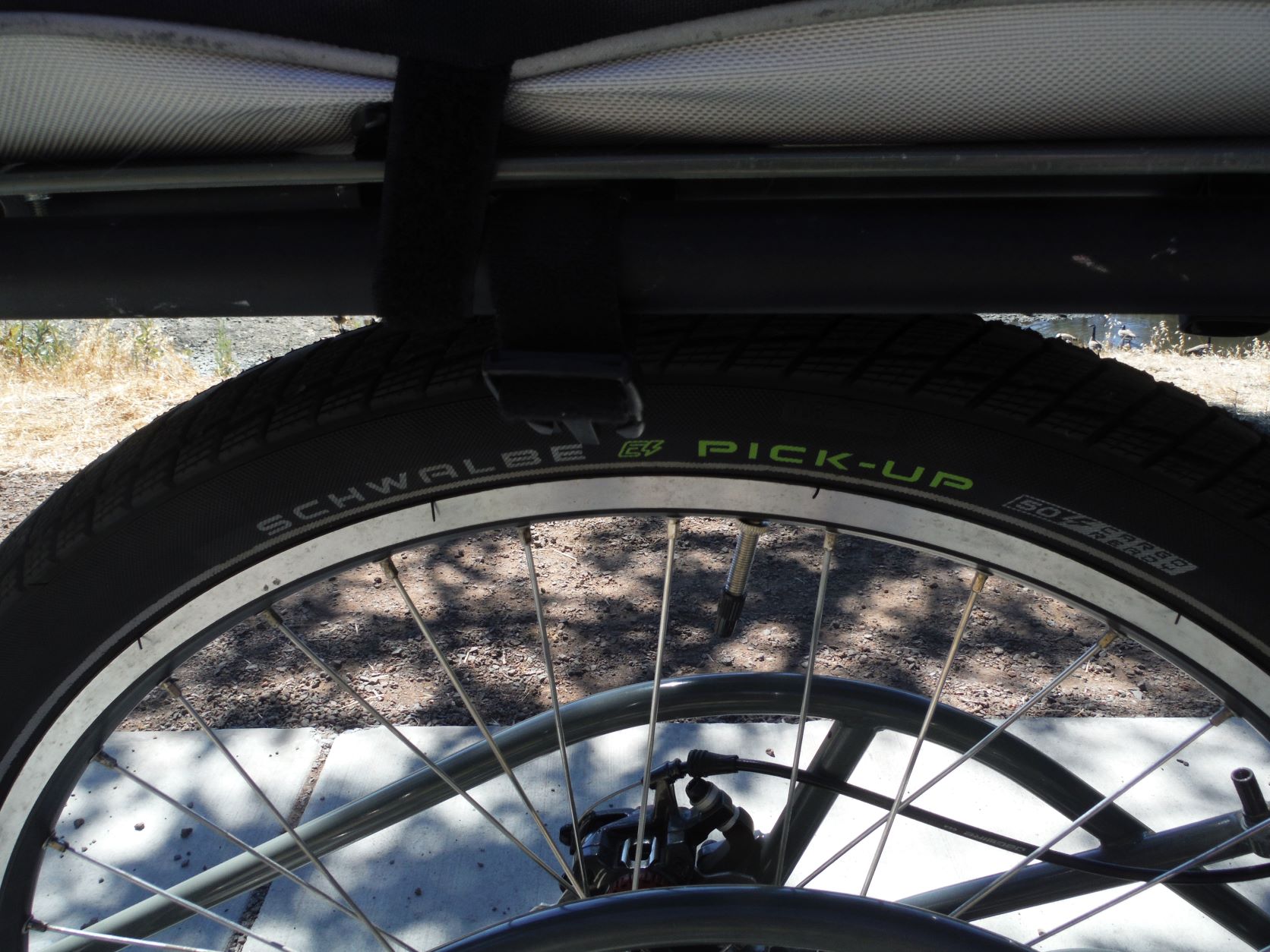

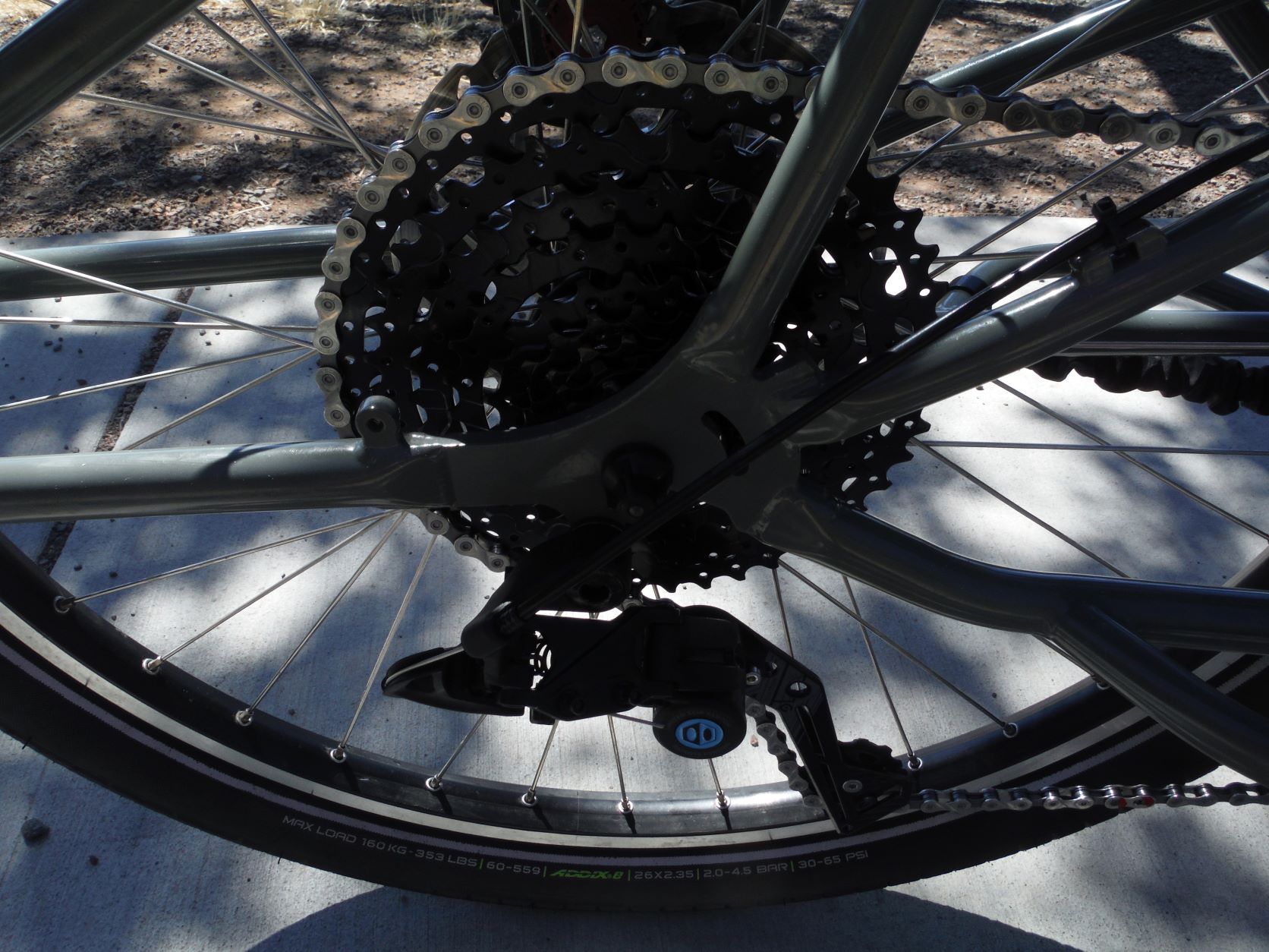

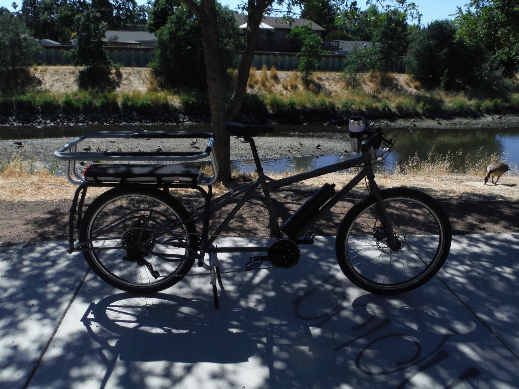

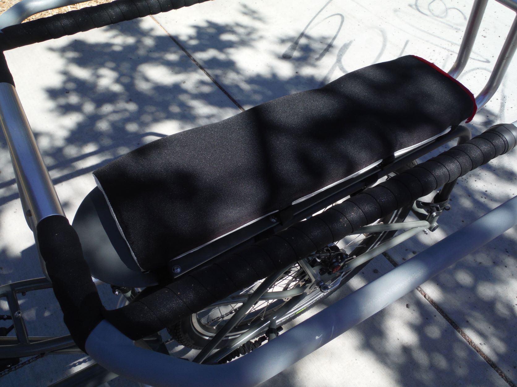

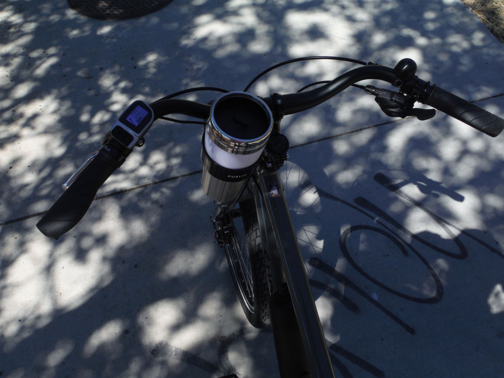

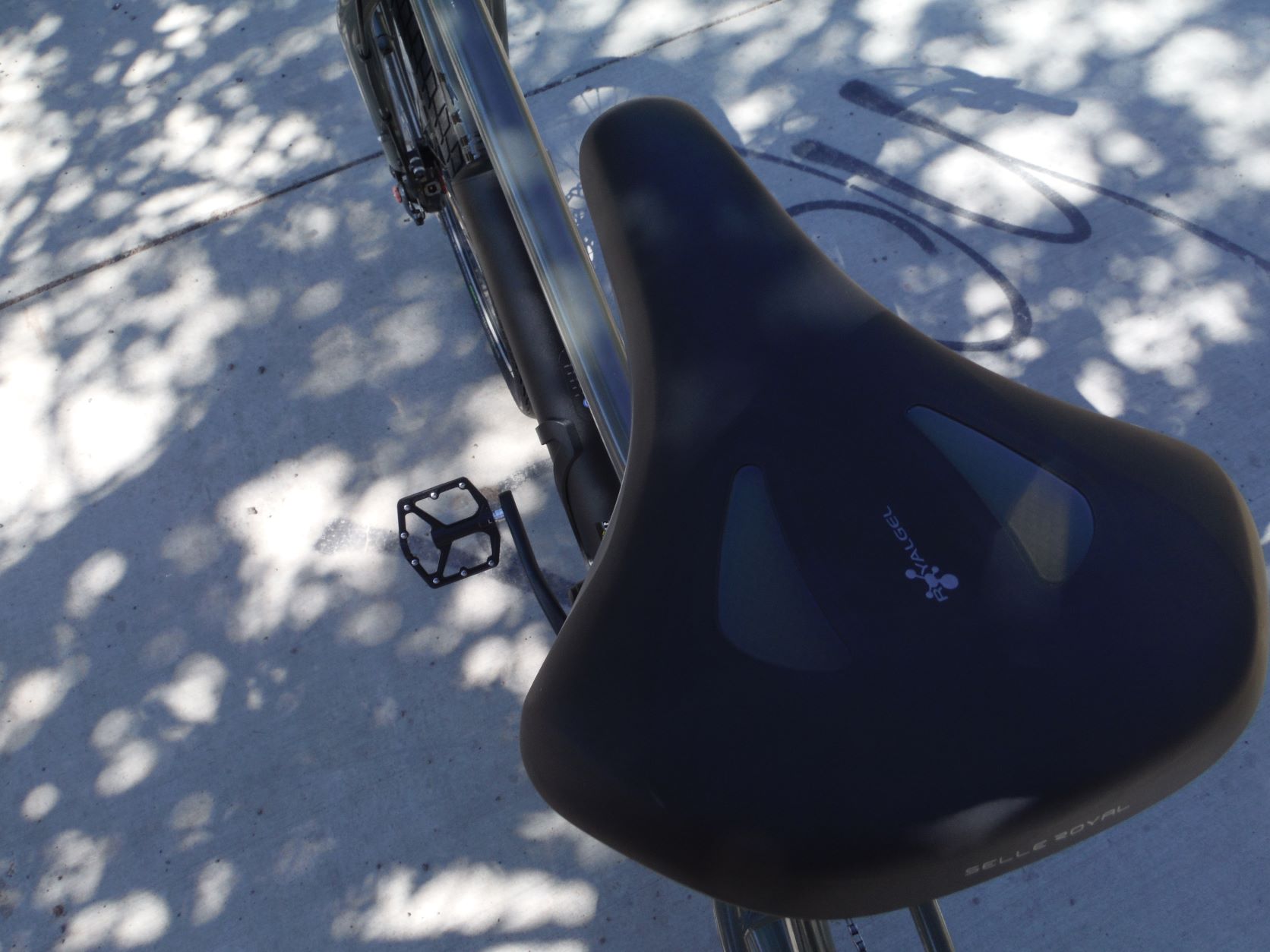

The bags hold 42 liters each. The E50 tires 160 Kg each. 90Nm, Class 3, 750W, 504Wh, with an 11-47 cassette to a 42 ring. It can get fenders. It can take one week's worth of groceries plus two kids up big hills. This is just one example of a groundswell of people giving Putin, Texas, and the Saudi Princes the finger. Besides it is more fun than waiting at red lights and the other CA's bumper to bumper "freeways." This is part of the Mother Load movement. https://vimeo.com/ondemand/motherload Last week a kid ran away when his parents tried to put him in a car seat, Franco climbed onto their Mundo cargo and wouldn't budge. The mom started quoting Susan B. Anthony on bikes to her friends. The dad is tired of paying $450 US per month for gas, only to then be stressed, revving, stuck in traffic at the next light.
