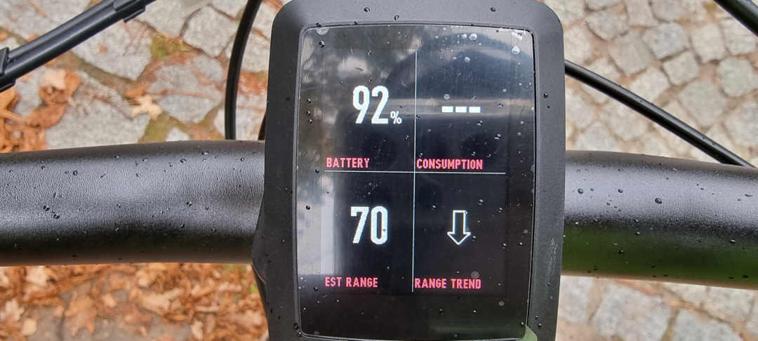

It is amazing how much the range increases on long downhill rides! The 2022 Como and Vado are equipped with the new MasterMind TCD display. There is a whole display page devoted to the battery range. Not only the current range is recalculated as you ride but there is a Range Trend data field, too. If you ride uphill, you see the range figure go down and the trend arrow is pointing down. As soon as you start descending, the arrow turns up (I could see that on the 2022 Tero I demo rode this year).
The Range data page on MasterMind TCD. The pink colour indicates the Smart Assistance Mode (you enter the distance to be ridden and predicted elevation gain in Mission Control, and the Mission Control automatically manipulates assistance to achieve your goal with predefined battery % at the end of the ride). Of course, Smart Control would make you slower if the objective could not be met at faster pace. (In emergency situations, the user can activate the Turbo mode). As you can see, the Battery Consumption field is null if you do not pedal.
I could use the Smart Control on my older Turbo e-bikes and I only don't have the Range data page in my displays (but I can use the BLEvo app for the same). The reason I'm not using Smart Control is it is me who wants to control the e-bike :)
