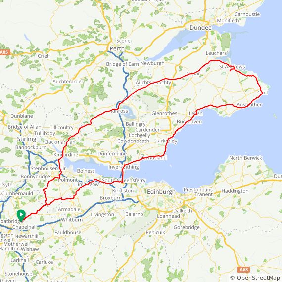

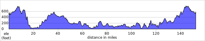

I managed 152 miles with just 500Wh ;) I did pick the perfect day though which makes a huge difference if you are contemplating a long ride, bring big climbs and strong winds into the equation and your battery will suffer a hell of a lot! I have a Giant Road E+1 Pro which has 22 gears so is very capable of being ridden without assistance on a lot of climbs! As others have said, there are so many variables involved! Rider fitness plays a huge part, picking the right bike is very difficult and shouldn't be rushed!
The first 70 miles of that ride were with no assist at all, I had a tailwind of course and my gears got me up the climbs without any assist! I now have 1000Wh at my disposal and would love to see what I could do in a single day but the time of year and current circumstances mean I won't be doing any long rides for the foreseeable future! Hopefully next year in the better weather and a change of circumstances I might get a chance to test it...
Elevation gain was 7,275 ft which isn't a lot for such a distance! If I did that distance where I live it would be like climbing Everest! ;)

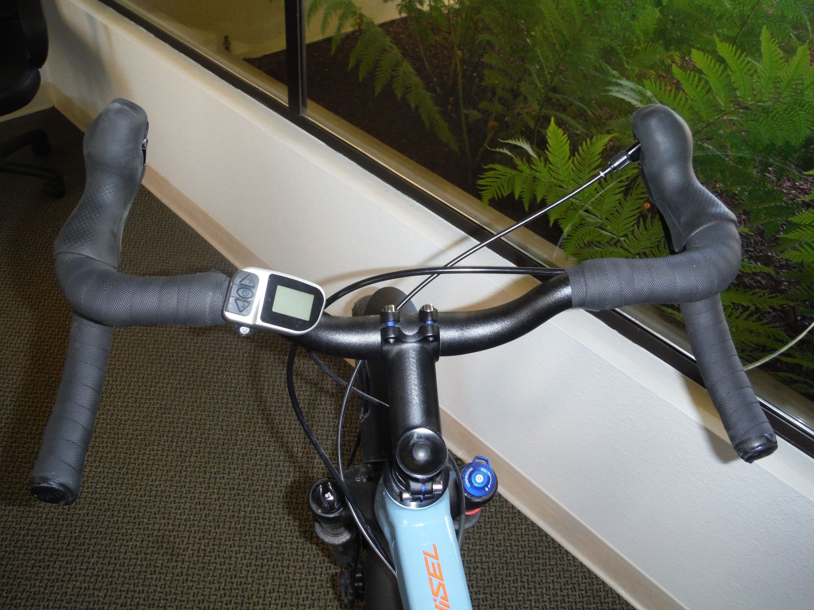

This is the bike that I use for what are for me 'longer rides.' It has a bar that allows for changing positions to prevent fatigue. The saddle has gel and ventilation. It can be ridden clipped in or un-clipped with double sided pedals. It has low rolling resistance tires that can take broken pavement or trails and it has an air fork. It can hold a second battery if I want, but I have found that it is more advantageous to get rid of the added weight of a second battery. The rural roads around here are very rough. That is why this bike is beefy. Three hours of rough roads is good enough for me.
