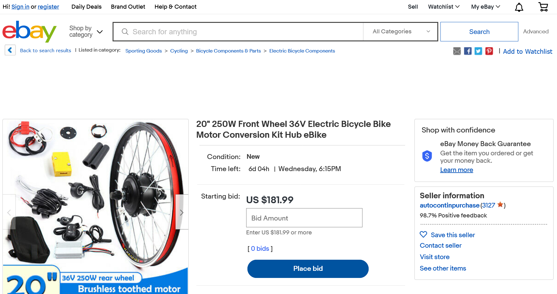

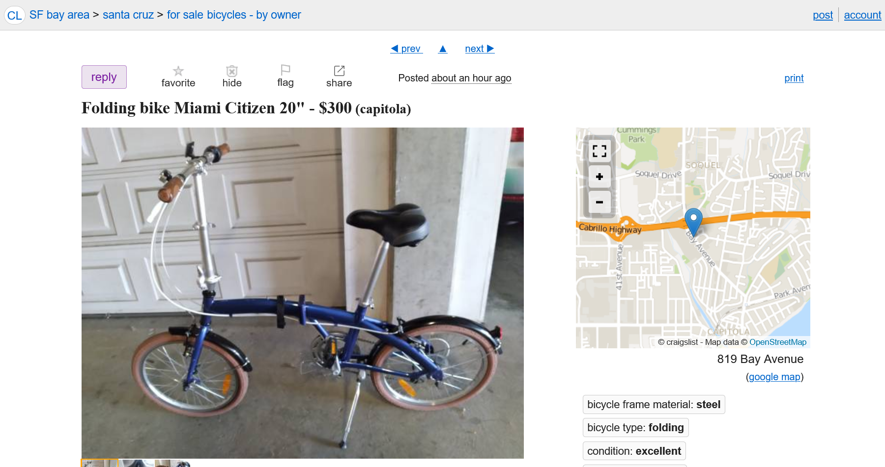

I just looked on Craigslist in the SF Bay Area. There are plenty of lightweight, quality folding bikes in the $300 range. A front hub motor on eBay is about $185. These motors come already laced into the included wheel. Then you need a $340 battery. You would need a few odds and ends $50. You could install it yourself within three hours. You would then have some bragging rights for your ingenuity, pride, and a bike that suits your needs for about $900. There are plenty of videos on how to do this. The hardest part is removing your old front tire and installing on the new wheel.
Just a thought.

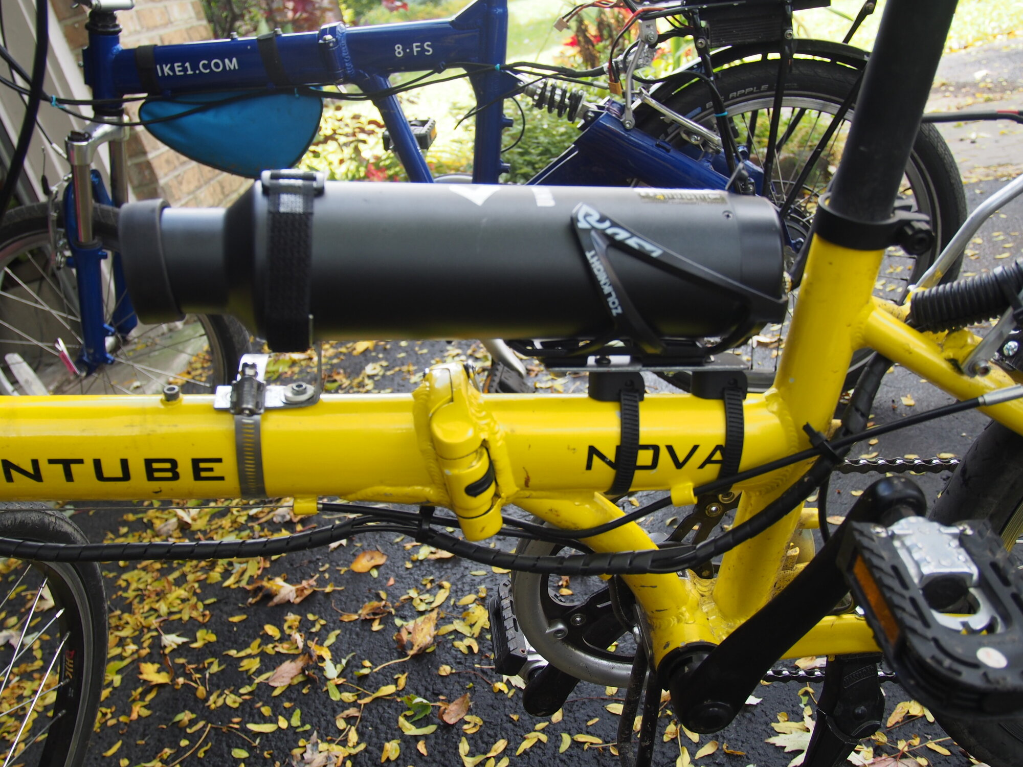

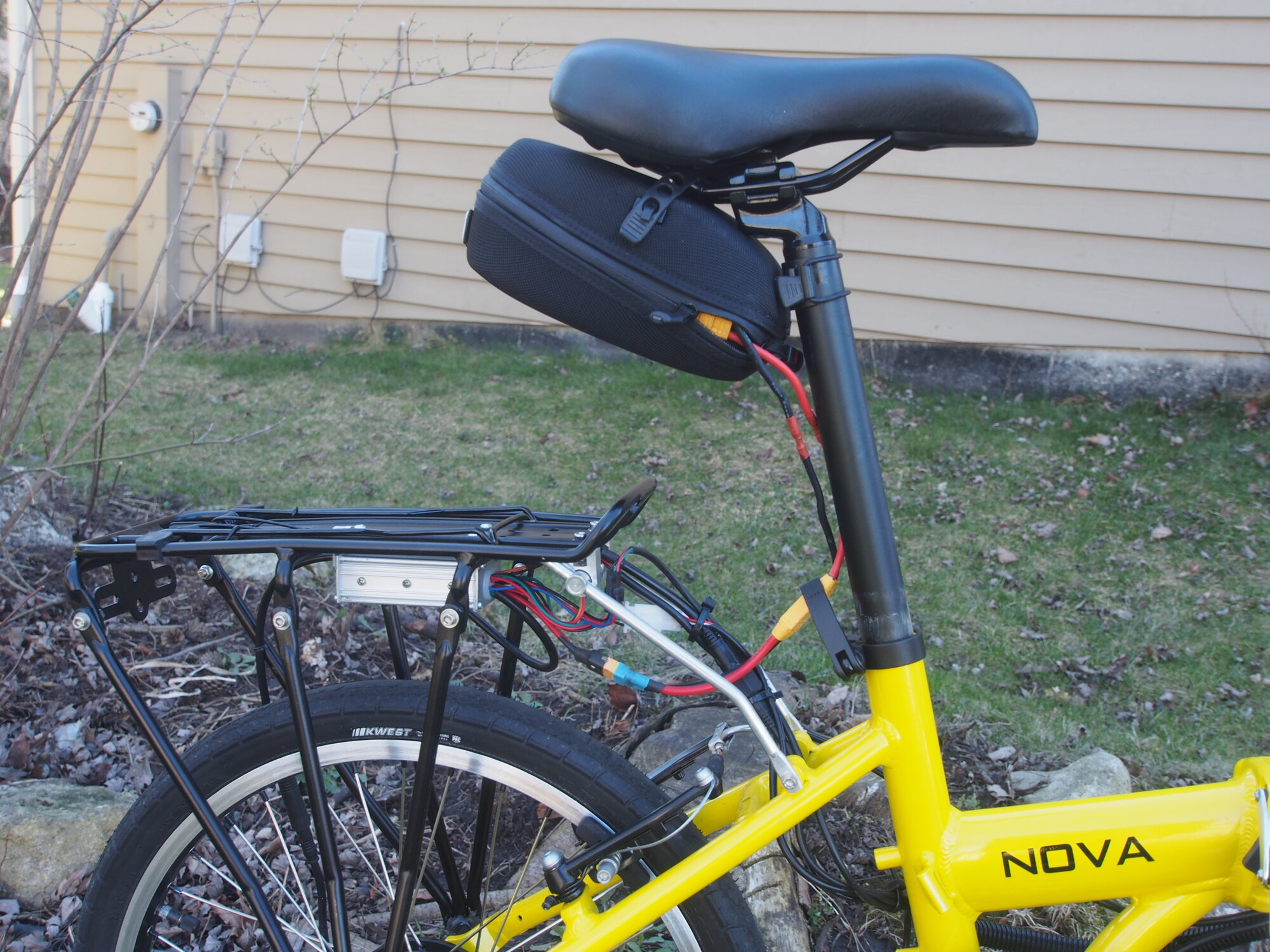

I own four 20" ebikes, three of them folders, all home made. As these bikes are small, it gets harder to put a battery on them and keep them compact. As we rarely fold them, I often keep a bottle battery across the frame. This defeats ease of fold and commuting, although the battery is easily removed. I do have small battery packs that fit in a bag under the seat, but the bags aren't designed for a 2-3 pound battery, and the straps break. So it's either on the rear rack or on the frame.
This is where the Qualisports seat tube solution is better for commuting, By the way, those batteries should be ample. I can cover 14 miles using 4AH out of a 36V6AH battery. It's just about flat at that point. If you can recharge at work, do it. Stick with skinny tires. Don't buy their Beluga miniwhale,

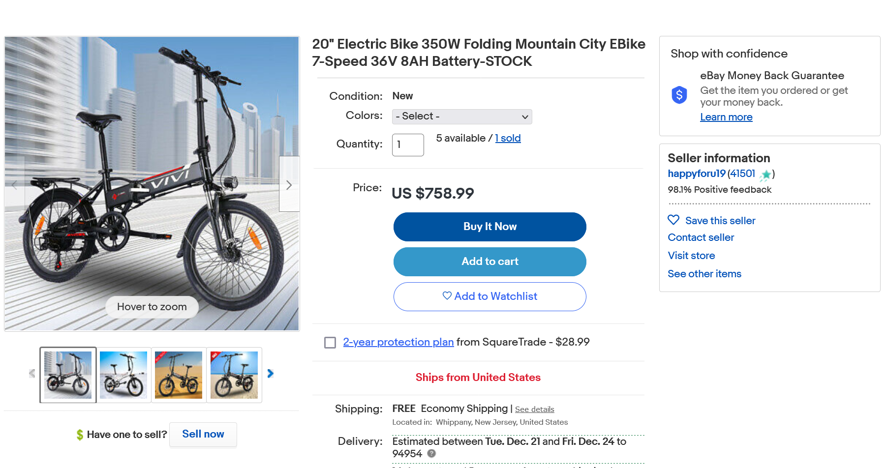

I put 'folding electric bike' into eBay and got 3,065 results. The ones I saw were under $1200 and included free shipping. Finding a seller with domestic stock and with a domestic presence will give you some recourse. Lower end sellers who rebrand come and go. I suspect that they just form another brand so that customers have no place to go for support after a year or two. Many of these bikes are essentially the same bike with different stickers.

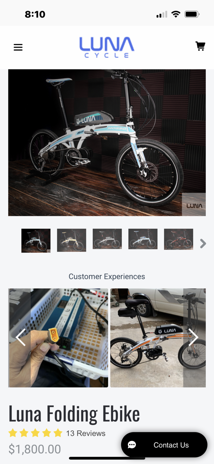

We have two of these and about 1,500 mikes on each. Class 2 throttle. Strong value. Fun. Tim
