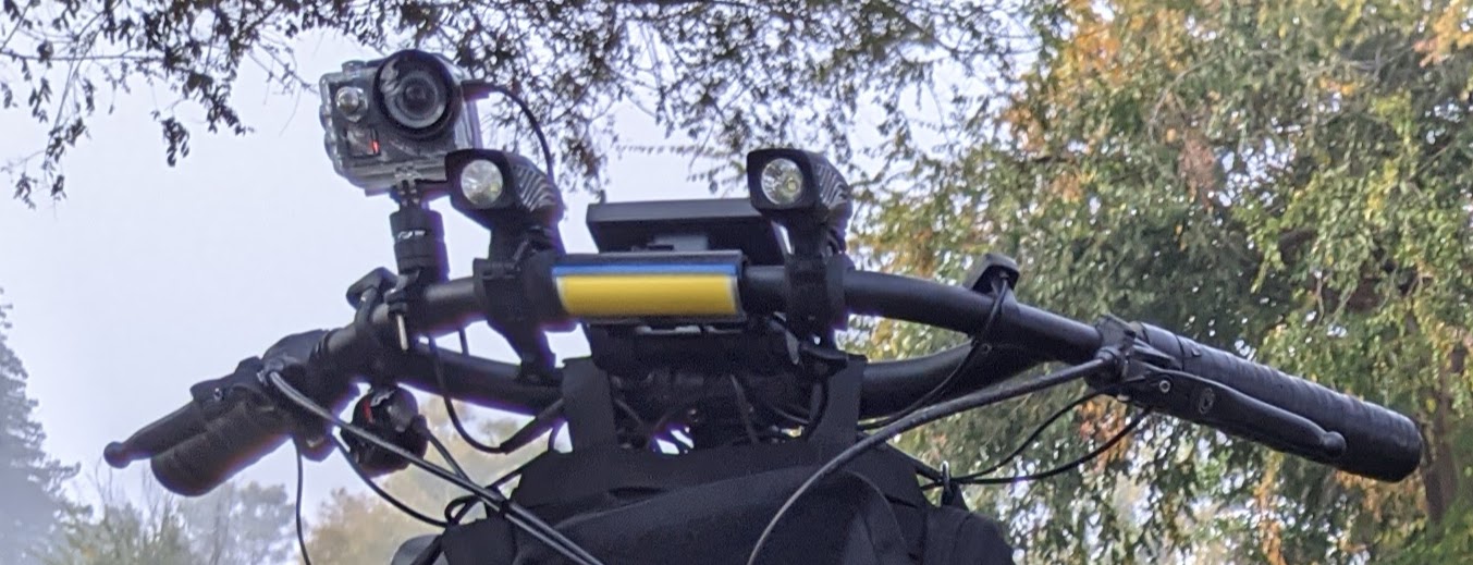

Thats not necessarily true. If you take the time to work your light setup you can avoid this. This pic is an earlier front end setup. The central Knog Cobber ordinarily throws light in a 330-degree arc, but has a mode that shuts off the top portion of the light, so the blinker is blinking down and partially forward (light placement helps with this as well). I doubled this up with tape as you can see, as I got a little blowback myself while riding without it.Now, to use flash mode at night, in the front is super dangerous, as it blinds the drivers.
This takes time to suss out. There are a lot of night time trips back and forth on a neighborhood street, where you test and re-test what the bike presents as from a distance. What you learn as you see your bike from a distance down the street is a blinker that is physically close to two bright steady lights is washed out and swallowed up by them so that, unless its a REALLY bright blinker, it is completely invisible past only a few feet.
To get around that, you vary the intensity and strength of the blinker, and the space away from the steady lights. The Big Cobber shown here is REALLY bright, but sitting in between two Nightriders, the whole assembly yields the impression of a single beam that is pulsing, for lack of a better term. Between placement and shutting off a portion of the beam, its no longer a sharp blink, but its a visible variation from a steady.

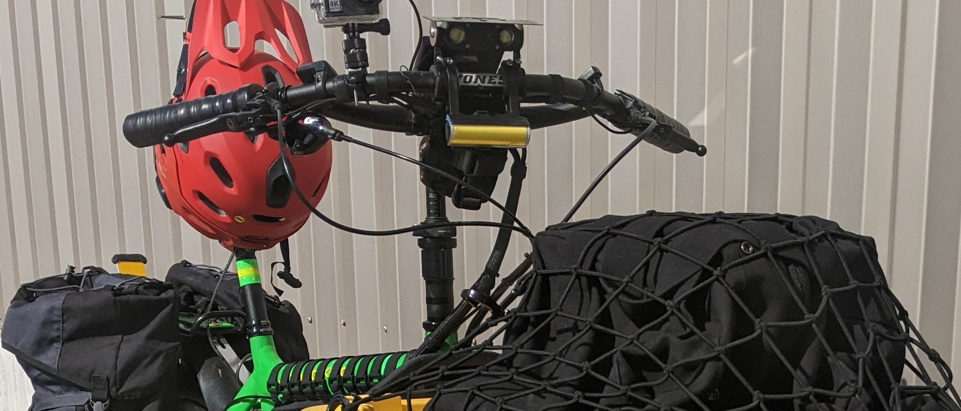

That pic above was taken almost exactly a year ago. In the last few months I have set this bike up with a much nicer - and more expensive, sadly - setup. A Fisher Fab House light that has a variety of modes: 80 lumens, 770, 2900 and 3200. And a 700 lumen flasher. Needless to say, the two big modes should be limited to trail use. I use the 770 lumen mode day and night, and along the lines of the blinkie distance from the main light, I have mounted the light straight up above the bar, and added an extension down below it for the blinker. It ends up being a nice balance again.
The Fisher light is a real winner. One spot and one flood beam, running in tandem. Aluminum casing. Powered directly off the main battery thru a shunt leading to the BBSHD display. But its a pricey little bugger.
