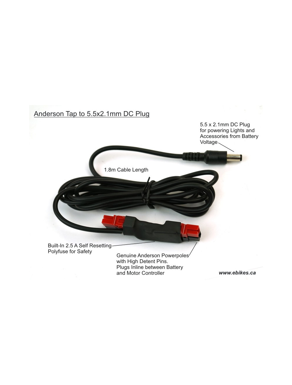

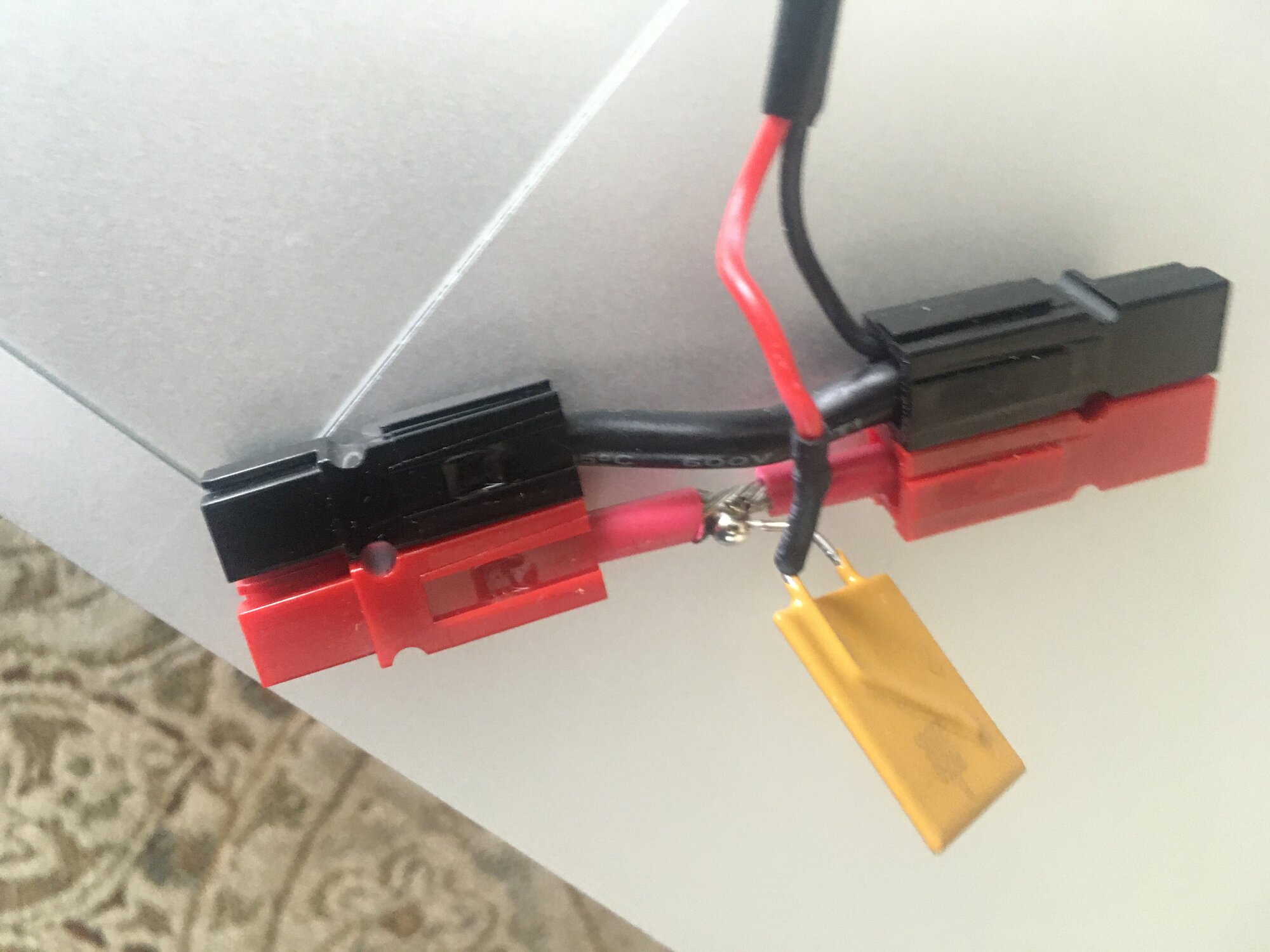

I was looking for something that I had hoped I could wire directly into the headlight circuit of the 35A controller
There a quite a few lighting system that run from battery leads and work in the range of 24-60 volts.
a simple tap with a resetting fuse makes wiring simple and clean.
i bought a few of the fuses and can make them with any connectors.
