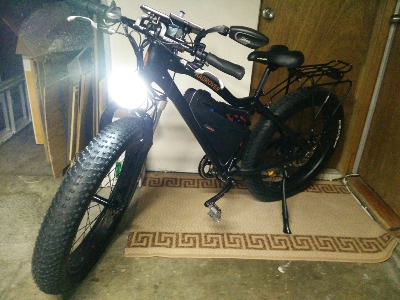

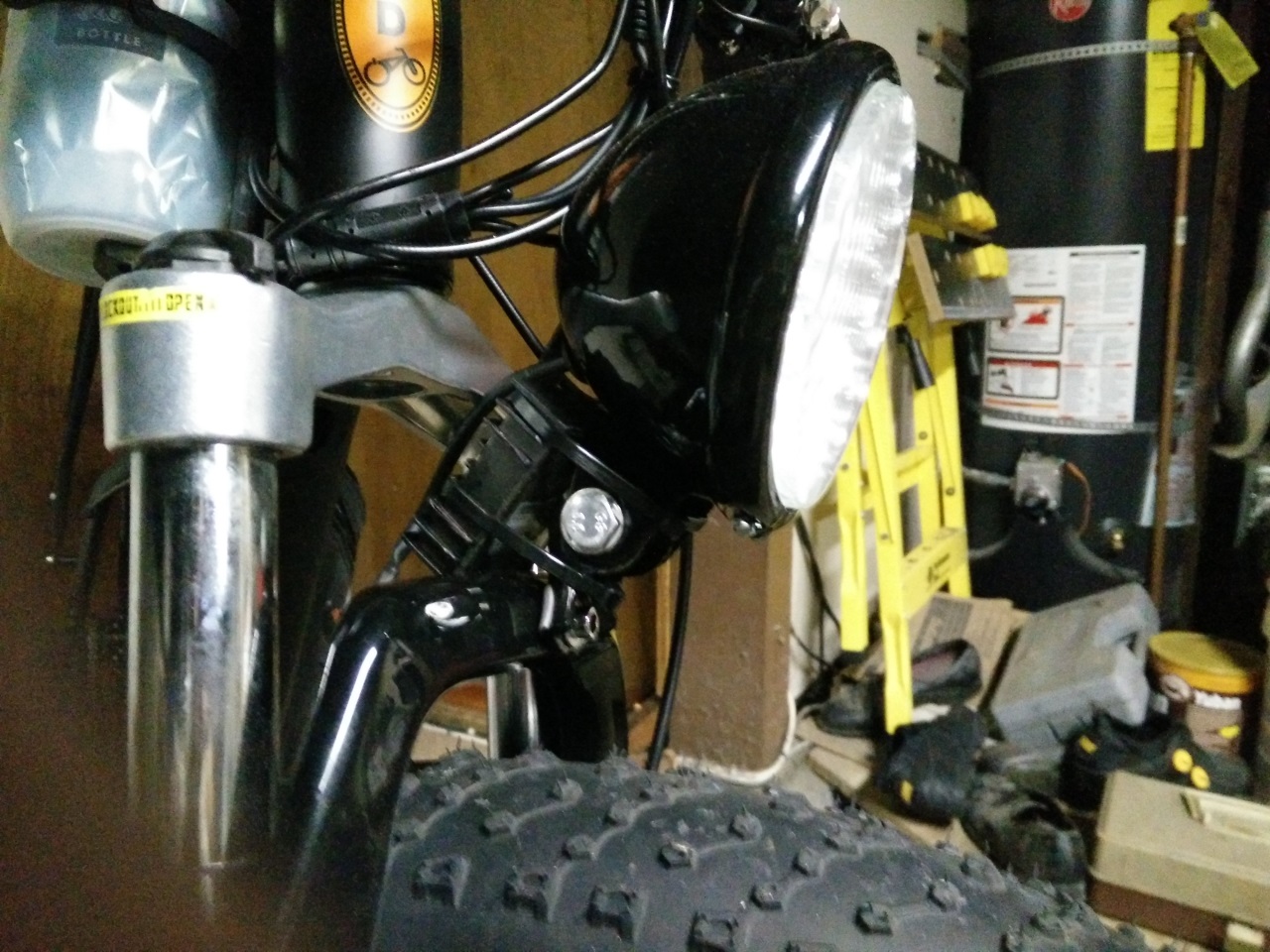

So I received the 5" LED light. It's supposed to be for motorcycles but I don't believe that at 5w, it's actually bright enough for a motorcycle. Anyway, it's bright enough for me on a bike. I haven't connected on the bike yet as I'm still waiting for a stepdown converter, this one. I connected it to a 12v power source so I can compare it with the Rad original headlight. Here's a couple of pics:
. First is a side by side, and the second is top and bottom. It's not as focused as the original, but it's a much bigger spread of light.
Here's a couple of pics of it on my bike.

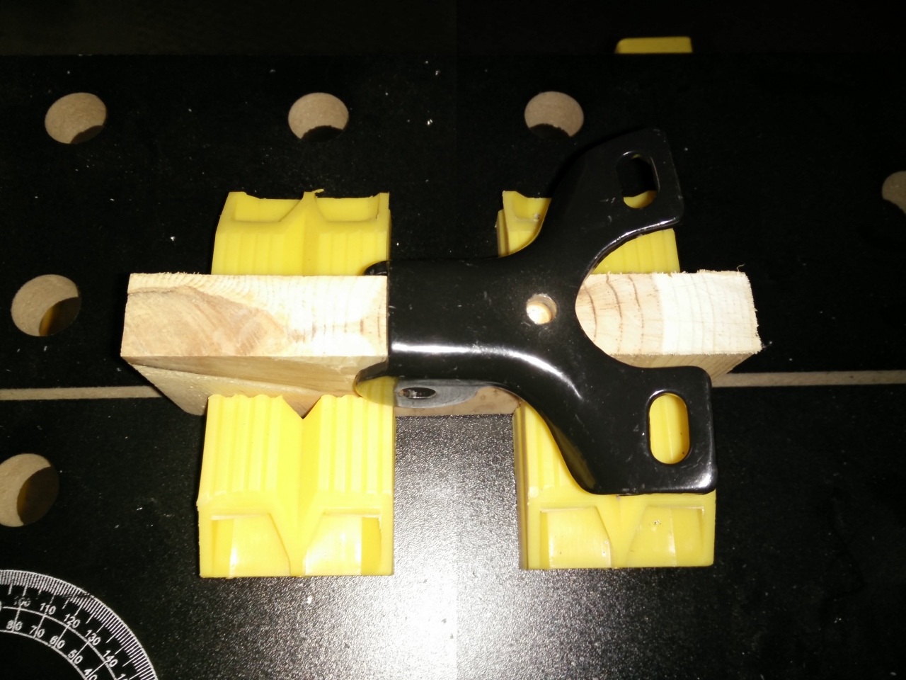

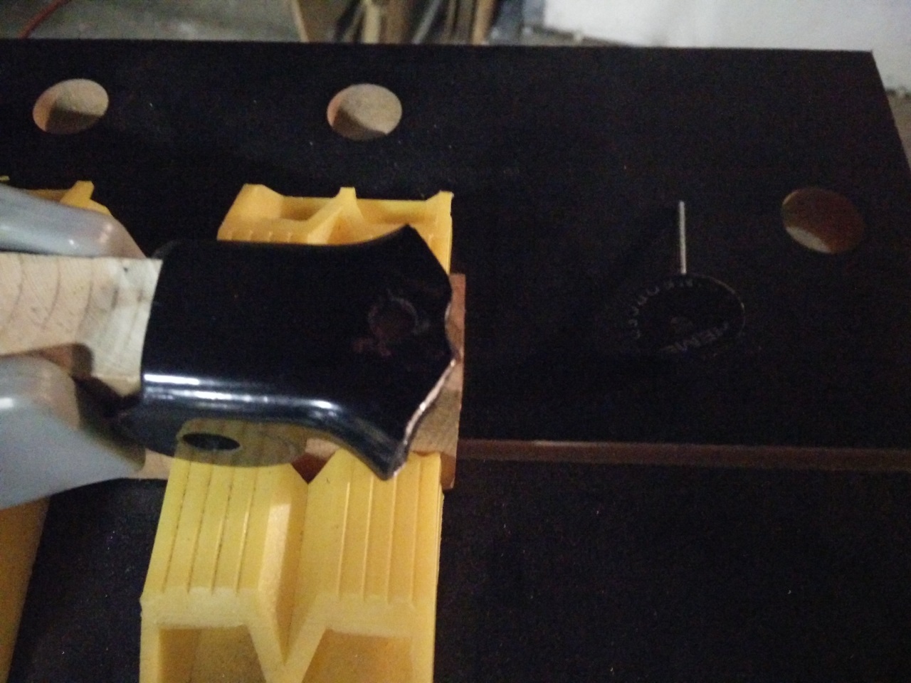

Basically, drilled a hole in the mount, and cut off a little bit of the metal, then use the original nut & bolt. Note that the light is not turned on in the pics, just looks that way. The wires are not even connected yet.
![2016-07-11 22.29.29.jpg 2016-07-11 22.29.29.jpg](https://forums.electricbikereview.com/data/attachments/7/7139-93cd20cc62e87146f4a817d2b6ee5357.jpg)
![2016-07-11 22.29.52.jpg 2016-07-11 22.29.52.jpg](https://forums.electricbikereview.com/data/attachments/7/7142-c5d175c2e315db0396d84395aa516a0a.jpg)
Edit: I found a smaller converter so I canceled the earlier mentioned one and ordered this one. It's smaller so easier to hide, and already black so I don't have to paint it.
