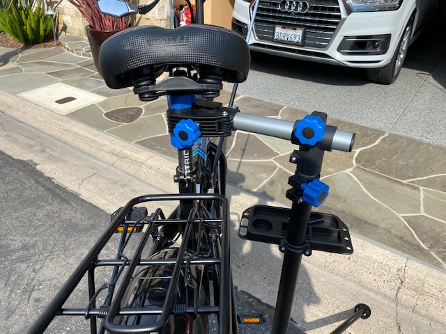

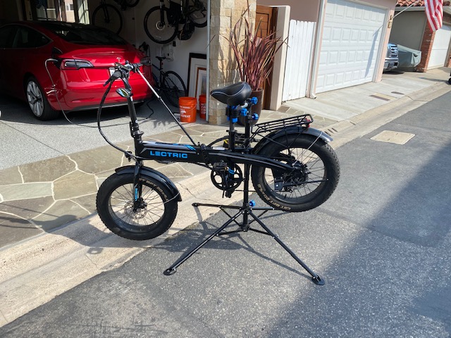

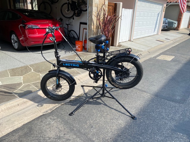

The YaheeTech workstand arrived from Amazon today. I was searching for a stand in my post above on Aug 13 that would support my XP as well as our other non electric bikes. I think that this one will work well for $80. It supports up to 66 lbs so I removed the battery just to make the XP easier to mount. I am able to support the entire bike to run through the gears and adjust the brakes. However I think that for wheel removal I will position the stand to allow the wheel that I am not working on to be supported by the ground to improve stability. Overall I think that the Yaheetech workstand is a well engineered and built product and i am pleased with my purchase. Photos are attached.View attachment 62843View attachment 62844View attachment 62845
Thank you for posting. How compact is the stand when folded up?

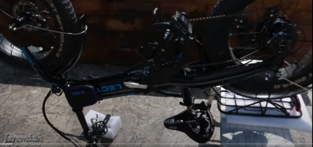

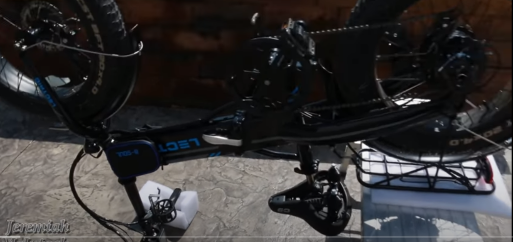

I prefer to work on the bike upside down using the handle bar jacks. It makes for the most stable scenario if the back is supported on the back rack (and not the seat). It puts everything right up where you want it. You don't even need the handle bar jacks. Foam blocks from shipping boxes work great too. See pic...via Jeremiah McInTosh video.
Lectric Xp E-Bike Freewheel Upgrade replacement Tutorial and differences - YouTube 8-31-2020 3...png
Yeah, I saw that video and thought the same. I was just curious about how the wooden stand would work for rear tire removal, but not a very good use case for it.
