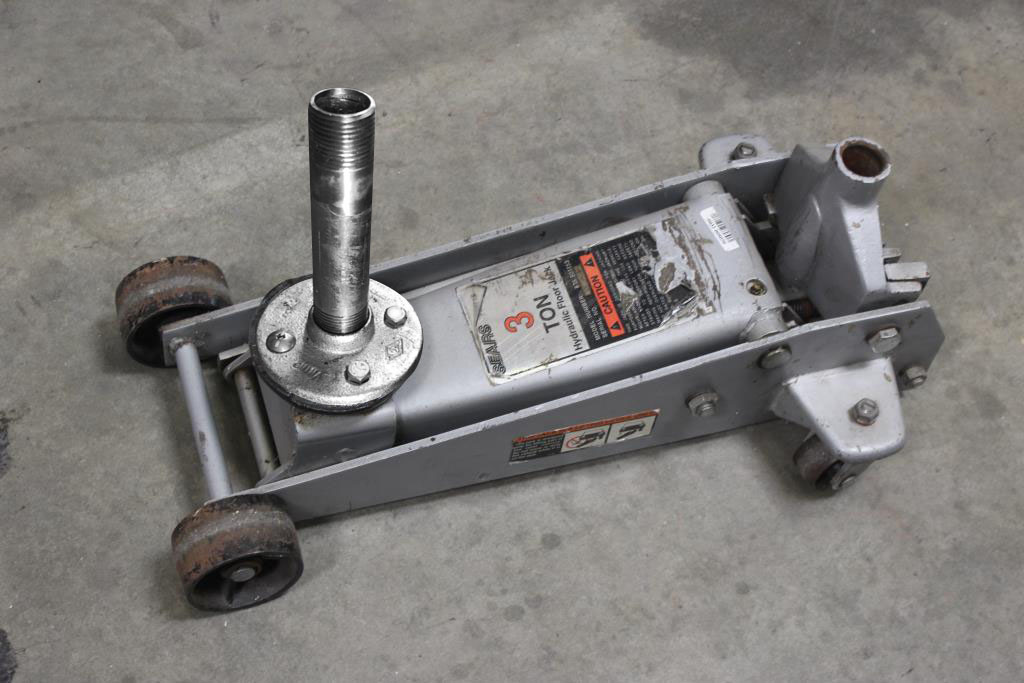

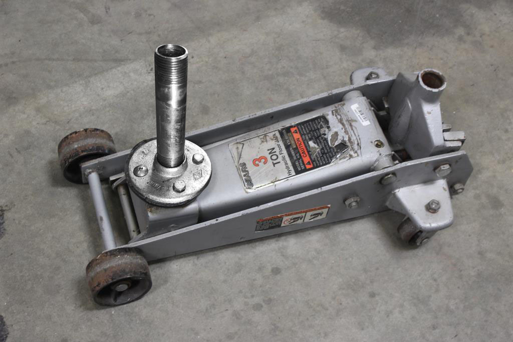

Here is what I came up with based on ideas I’ve seen here and elsewhere.
I have the original seat post that was replaced by a suspension post. I used a 1” pipe flange and 6” pipe nipple that is bolted to my hydraulic lift cart. I had to grind down a fre high spots on the pipe nipple so it would fit smoothly in the seat post tub.
Now I can mount the bike upright or upside down and use the hydraulic lift to raise and lower it.

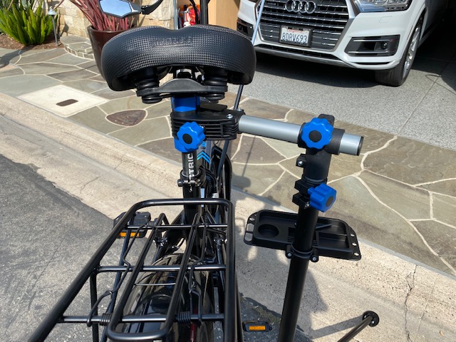

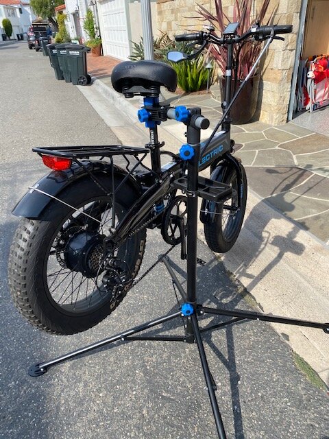

The YaheeTech workstand arrived from Amazon today. I was searching for a stand in my post above on Aug 13 that would support my XP as well as our other non electric bikes. I think that this one will work well for $80. It supports up to 66 lbs so I removed the battery just to make the XP easier to mount. I am able to support the entire bike to run through the gears and adjust the brakes. However I think that for wheel removal I will position the stand to allow the wheel that I am not working on to be supported by the ground to improve stability. Overall I think that the Yaheetech workstand is a well engineered and built product and i am pleased with my purchase. Photos are attached.

Mine just arrived today. I just assembled it in the living room. What I noticed different from Johns is where John has knobs to turn, Mine has 1 knob and the rest of the connections are quick release clamps including the arm that connects to the bike. Its too hot in the garage to do a test run and it's close to my nap time!
Was kicking around an idea. Maybe something like the attached image. Would be cool to make an attachment that can be taken on and off of a regular car hydraulic jack. Any thoughts?
I mean seriously...what good is a conventional bike stand when you have a 63# bike to lift at least a foot or more off the ground BEFORE you actually clamp it to the stand? There are ways but it ain't easy. This idea is something that makes so much sense. You can buy one of those cheap harbor freight floor jacks for very little money under $50 or buy a used one off Craig's List. Lots of guys are buying new seat posts so I would use the original seat post for the vertical pipe. Just need a way to secure it to the jack.
Is the post on the floor jack Idea short enough that you can position it under the seat post tube without having to lift the bike by hand? That would be an advantage over my Yaheetech stand but I still like the idea of having one work-stand that works for all my bikes. I just don't have a lot of space in my two car garage to store "extra stuff". John GIMG_0488 (1).jpg

Nice! Couple questions:
1. Is the seatpost the only viable attachment point to the bike stand?
2. Do you actually have enough clearance in that position to run the pedals?

Starman,
The Yaheetech has enough clearance to pedal. In fact I was just doing that today on the XP to adjust the derailer. I did fold the inside pedal to add more clearance but this was not really necessary. This is my first bike workstand and I am loving it. I have been using it on my other bikes to change flats and clean and adjust. I did not know what I was missing before I got it.
Also, It looks to me like the handle stem is a viable attach point to work on the front wheel but I have not needed to do that yet. The stand will support the entire bike off the ground.
