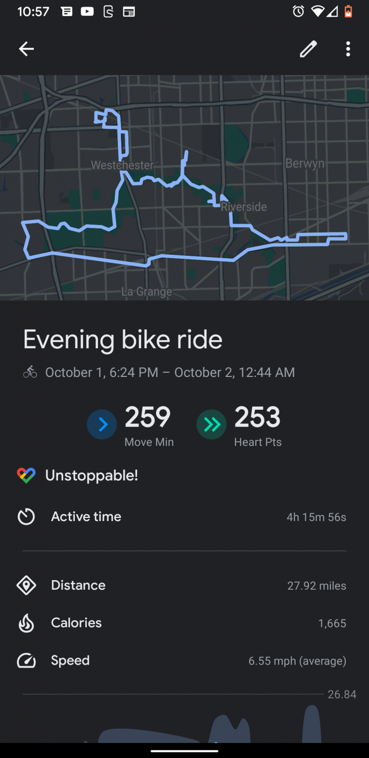

Lastly, I received my XP yesterday and since went for a long ride. My Google Pixel 3a's Fit app which uses GPS recorded 28 miles. The XP odometer recorded 22 miles. I stopped and rested a couple times as I mentioned above but for the most part this was a general round trip. I'll record more runs and keep posting my results.
