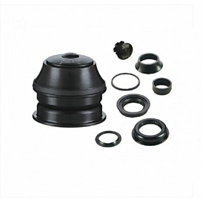

I know the headset seems a bit of a mystery but it really is very simple pretty much any 44 mm semi integrated headset will work. Here are some links to a few sellers on eBay with USA stock.
Just do a search for semi integrated 44 mm and you'll find all kind of results. About the only real difference is the top cap some of them are flat and some of them are angled some of them are cone-shaped, they all will match up to the bottom of the new threadless stem quite nicely.

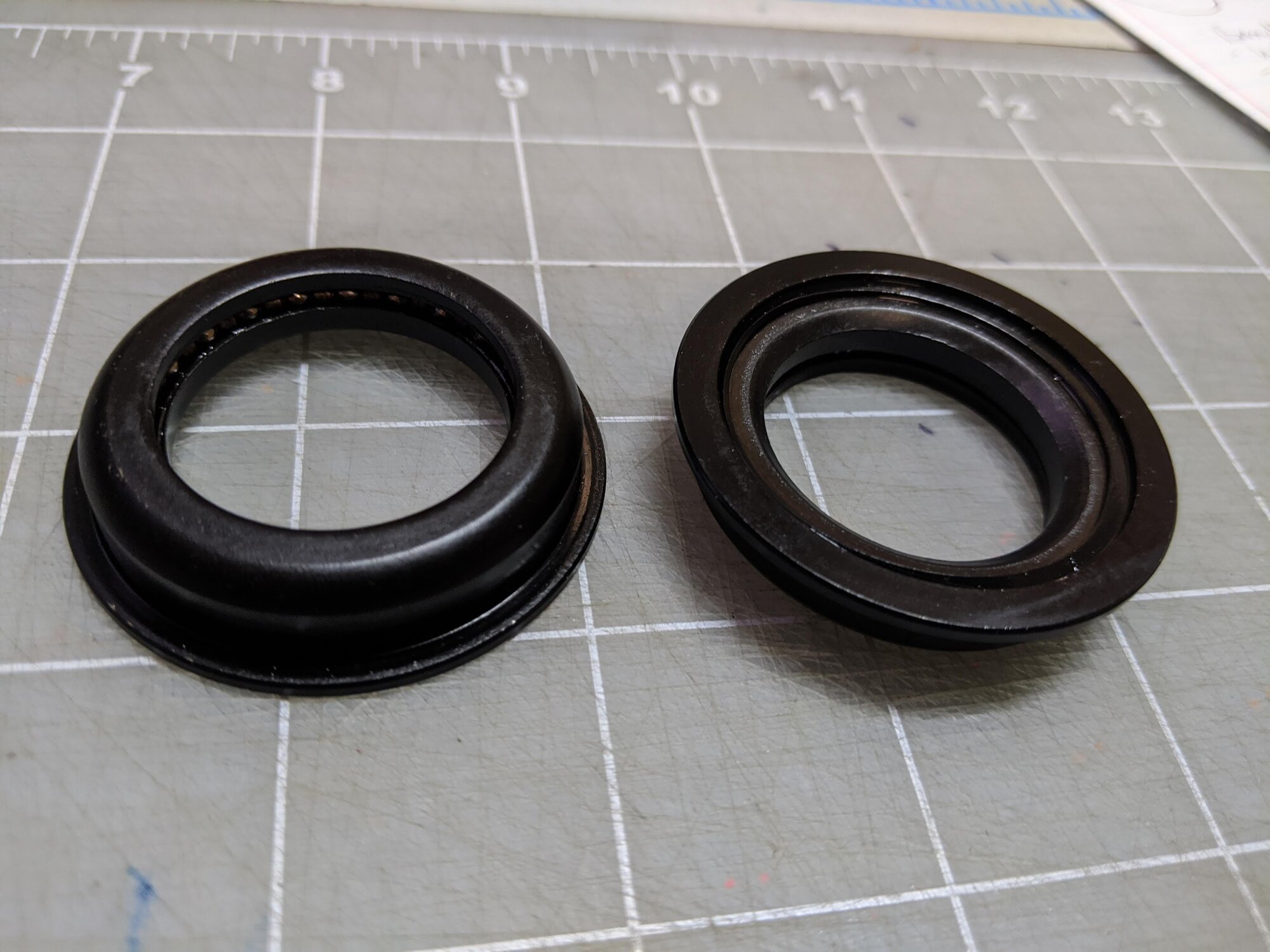

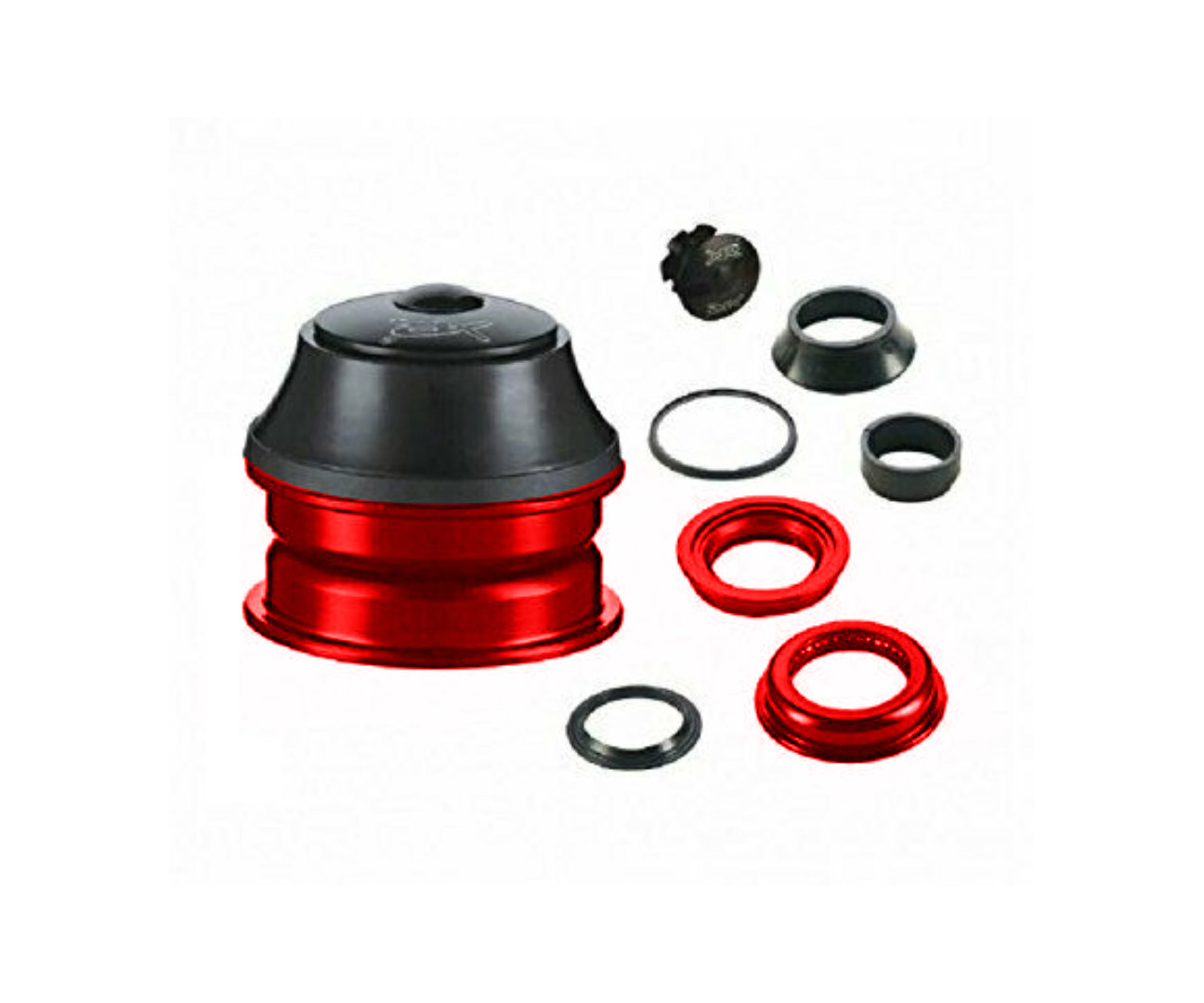

I bought the 2nd one and have a general question, Are you supposed to use the bearings / cups on this set? They are integrated together and it doesn't look right. The video that shows the installation of the h185 Neco headset looks like it uses only bearings top and bottom with spacer's to fine tune. It does not look like they are using any additional cups. Are we supposed to re use the original bearing / spacers? I have attached an image regarding the parts in question. They are the pieces in red. Thanks,

I can't quite tell from the picture what type of bearings that headset uses. Can you send a better picture of the bearings?

Looks good. You won't use those two red cups, they are extra. Your frame has a top and bottom bearing cup already installed that you're going to reuse. The new bearings match the old cups perfect, that's why we went thru the hassle to find just the right headset.
IF you want to remove the headset cups (not hard to do) then your options become much greater as there is a wider variety of headsets choose from.

Here's the best I can do. It appears that the bearing and cup are integrated? not sure. I did not want to try and force the bearings out due to fear of ruining them.
