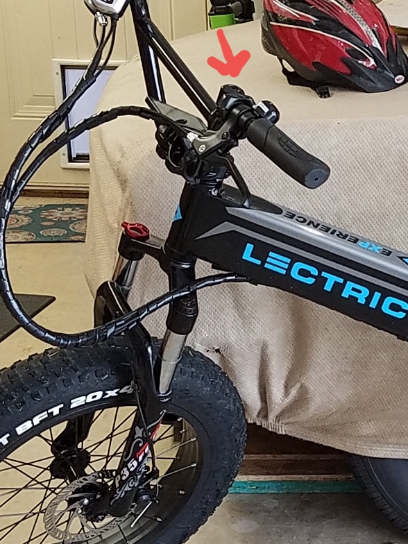

In the video where the air for is installed, Bob says that the star nut needs to be positioned 1/4 to 1/2 inch down in the tube. Do you measure from the top of the tube to the top of the flange of the star nut or from the top of the tube to the top of the threads of the star nut? Also, I have some play in the fork once I assemble it all together. Could it be that my measurement was too long? I'm using the Neco H185 headset. And, do I have to drive the top cone and compression ring (the parts that sit on the top ball retainer - bearing) down when assembling the fork in the bike's frame? I ask because the assembly has play when it is assembled. Please answer my questions because I need expert help.
Thanks for posting that information for me. I will be re-measuring the length and cutting the tube a little shorter.View attachment 60873
Maybe this will help. See the red arrow, it points to the top of the uncut Fork. You see the cap on top of the fork which is held in with a screw that goes into your star nut. Below that I have about 6 spacers and below that is the stem which holds my handlebar.
That cap pushes down on those spacers which then pushes down on my handlebar stem and creates tension and keeps it all tight. If your Fork is cut a few millimeters too long when you tighten that screw it won't create to the compression you need. Conversely if you cut the fork few millimeters too short oh, it doesn't matter and still works perfectly.
To answer your question, that's star nut needs to be far enough and so that it can both be captured by the screw that goes through the cap and allow the cap to be tightened down. A way to test it would be to install just the cap with a screw through a plain fork with nothing on it, tighten that screw down and make sure that cap pulls tight. That star nut might not be far enough down and it might not be tightening properly.
