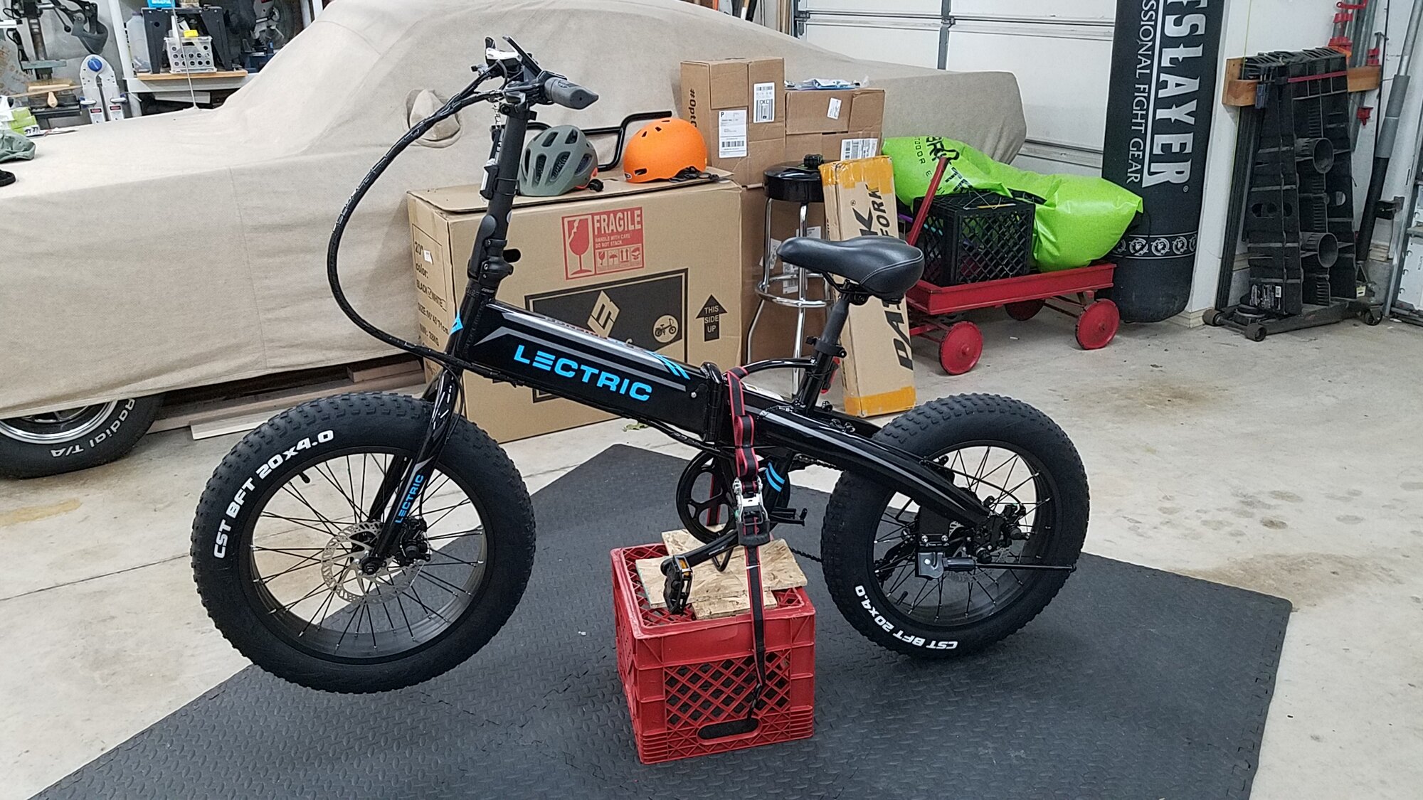

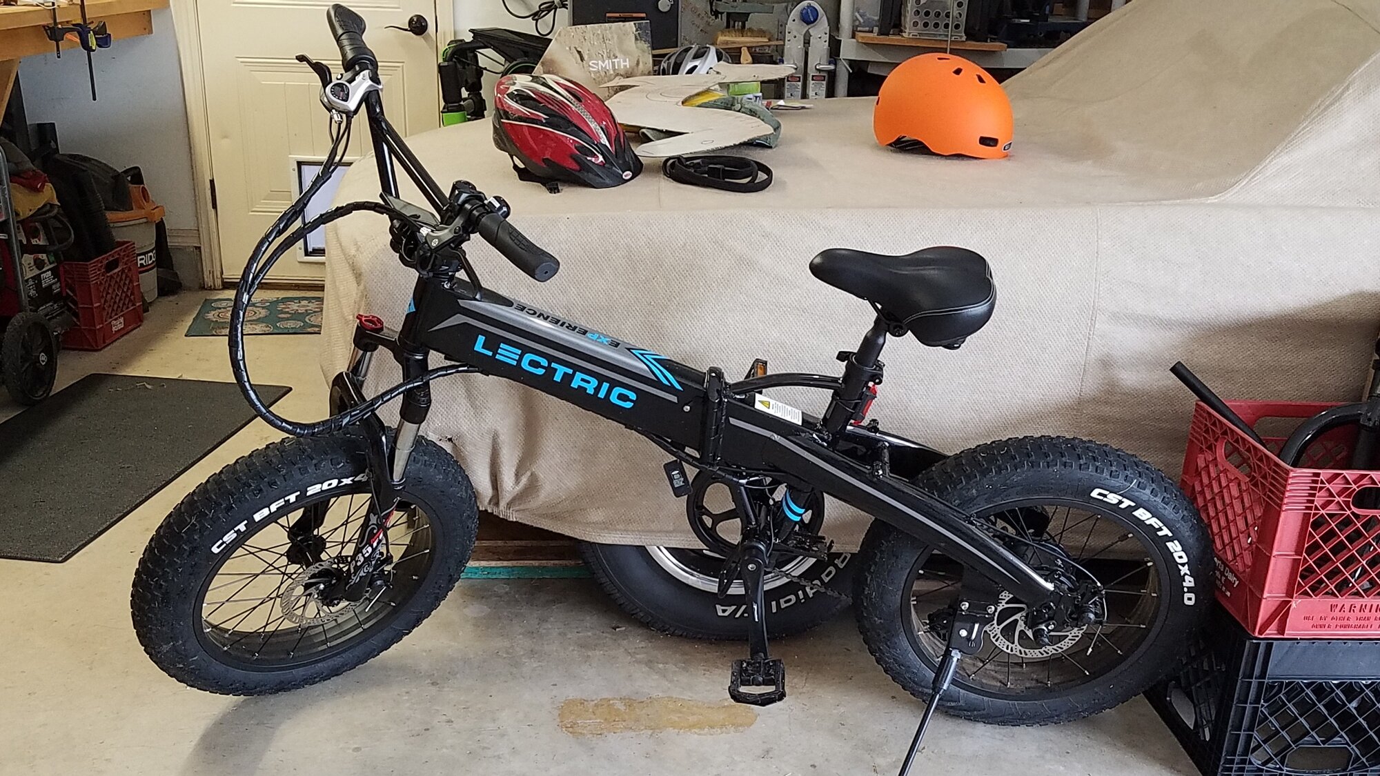

She arrived! 2 weeks early! Thanks to everyone who backed out to order a step-thru! Upgraded to the coil fork, and then went back to rigid, for now. The new fork is about 4" taller than the stock one. Nothing wrong with that, if you're okay with the look, I am. I like the BMX look as opposed the MTB so I might stay with the rigid fork.
And here's the super easy and cheap work stand I used.
DAAAAMN BMX mode is so flippin sick!! Do you have to lean way more forward to ride it in that fashion compared to stock?

I like the look , gives it that retro steam punk kinda look . Maybe thats an exageration but I like it.

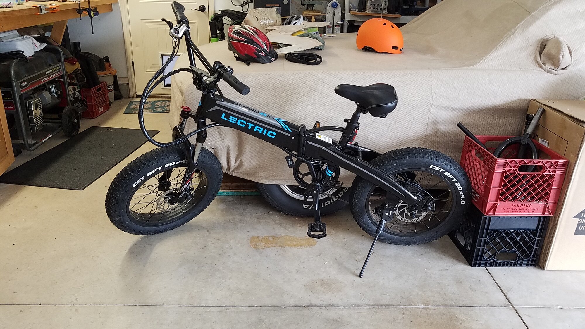

Thanks! Nope! With the seat low my knees come up between my elbows, just like when we were kids. Even with the seat higher the reach to the bars is still good. Plus those bars make it simple to adjust the reach, just rake them forward or back. Here's another shot.
