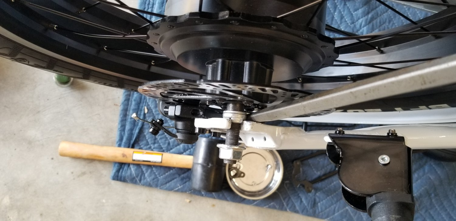

How do you do this? Do you have to take the tires off the bike and do you need special tools or just some tire levers? I am waiting for mine xp to arrive but I like the look of these tires a lot. TIA
The wheels do have to be removed. The tires come off easy with tire levers, however the rear wheel is challaging to get back on. Several posts on methods to spread the frame to get the rear wheel back on. I used a long screwdriver as a pry bar against the brake hub and the gear hub on each side taping the wheel back on with the nuts on the axle and a rubber mallet.

How long of a screwdriver do you use to pry and what do you tap on with the rubber mallet when installing the rear wheel? Thanks.

16 inch Craftsman, placement shown in photo, tap on nut that is on the axle. Rubber mallet shown.

Thanks for that information BroBox. I'll have to get me one of those screwdrivers to carry with me while riding. I've gotten one of the mallets a few weeks ago.
