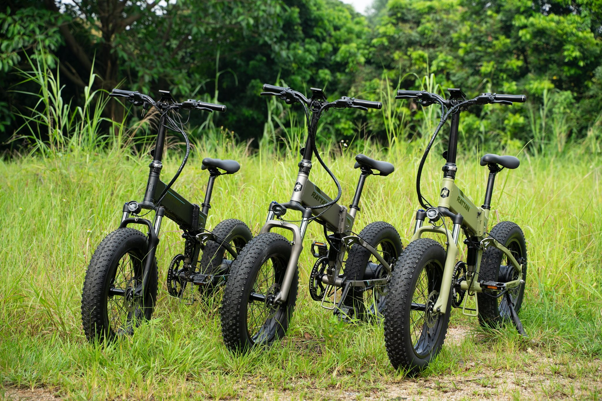

hmm, from facebook page images, cable wrappings on these exactly like the XP
Also, looks like there are a few in stock, lol

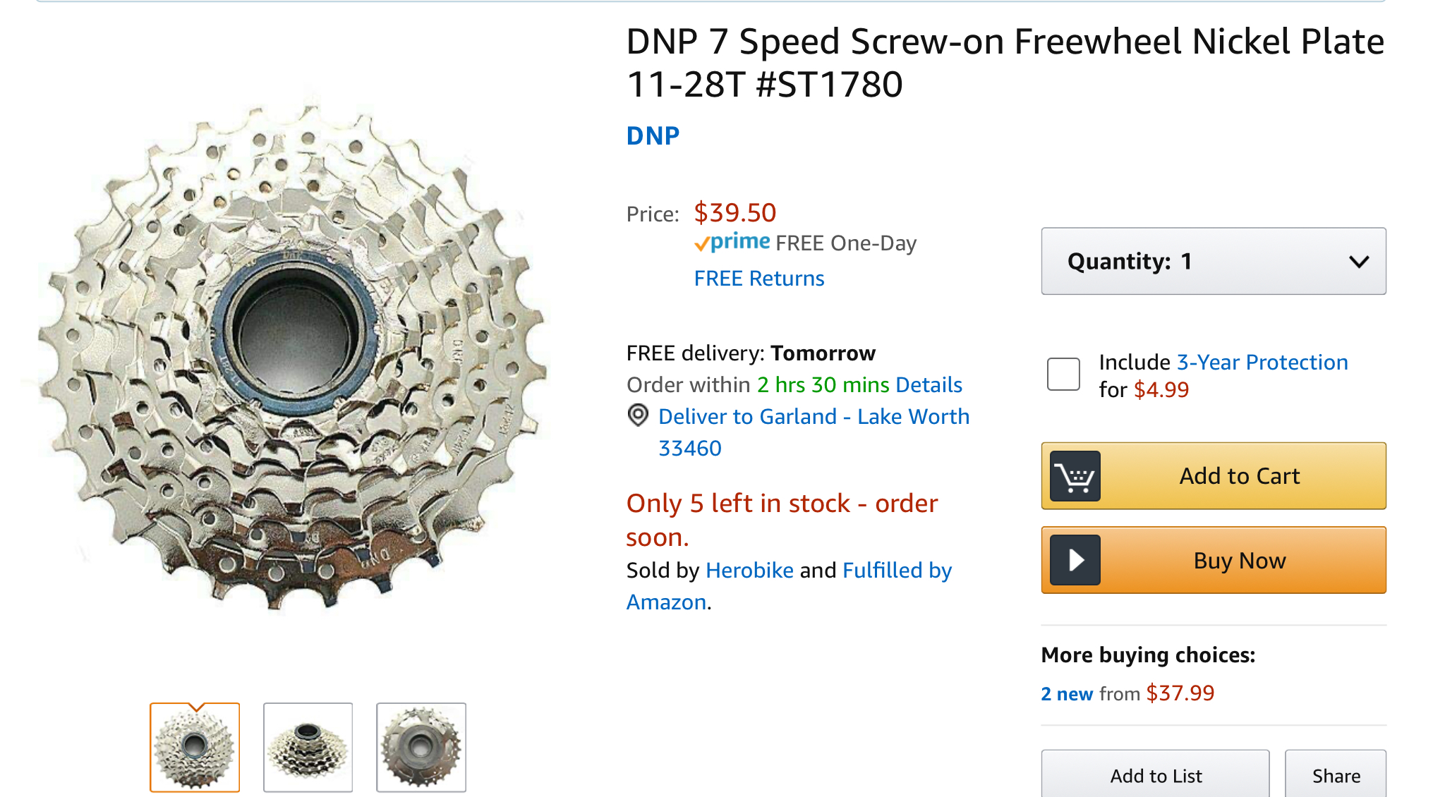

I installed the DNP 11-28 tooth freewheel today. I paid about $38 on Amazon but I see the same item on AliExpress for $17.
I only put a couple miles on with it but it is an improvement for sure. I am one of those that wants to feel like I am peddling, not necessarily hard but not without resistance. At least now I can go 20mph or so and feel like I am not comically spinning the pedals. I will probably upgrade the chainring to a slightly larger one at some point.
Installing the rear wheel took me 10 minutes or so. I am sure the next time will go faster but I wouldn’t want to do it on the roadside!
Thanks for the freewheel update, that is a change I may also make. Found the $11. hub changing tool on Amazon for $1.22 on AliExpress. That place amazes me. I just received my $10. Amazon cell phone holder from AliExpress for $1.20, same box, same phone holder, identical.
