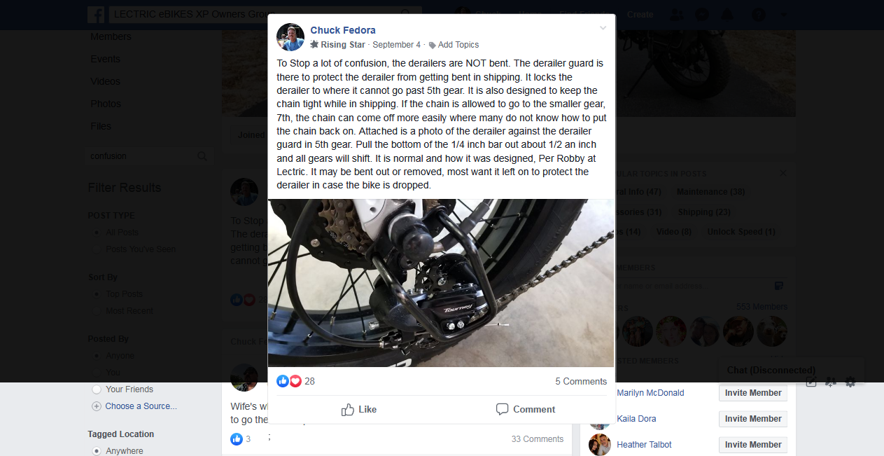

Try this video. It is specific to our derailers. Mine was way out of adjustment too and the guard was bent. All is good now though.
Thanks for sending me this video. I been looking all over the internet trying find our exact derailleur. I'm a novice at adjusting and I just didn't care to mess something up.
Yesterday my bike started refusing to downshift lower than 5th. Good video. Apparently this stuff isn't that hard. I managed to fix the problem and now it shifts like it's supposed to.
First derailleur adjustment so take this with about 100 grains of salt, and please correct me if I'm wrong. The 1st gear and 7th gear adjustment screws tend to be 'set it and forget it'. The cable collar adjuster that doesn't require any tools is something that needs a tweak now and then?
