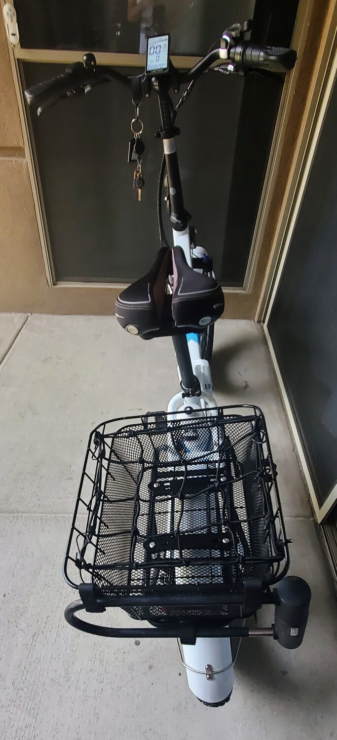

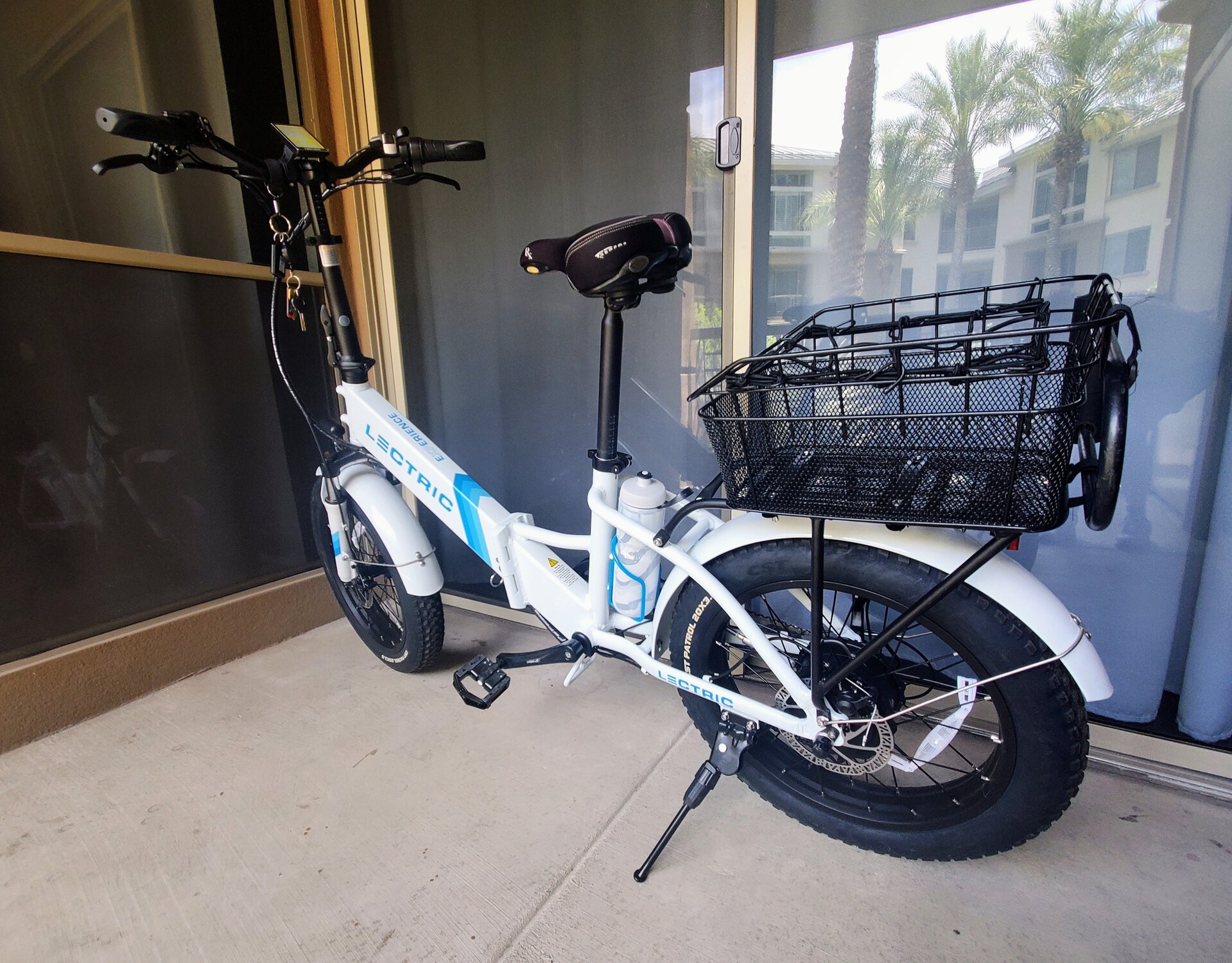

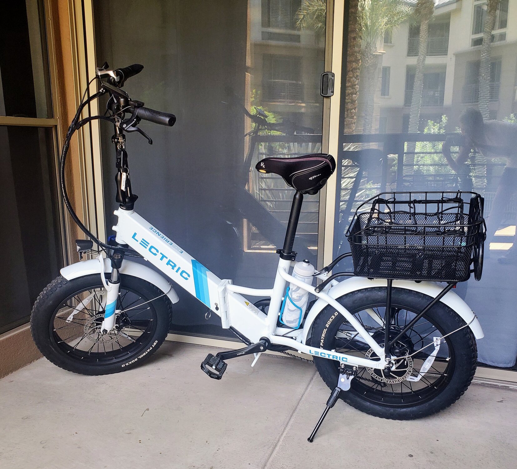

A little history. These are the 3rd electric bikes that we have owned. We are retired and in our 60's and live in a condo.

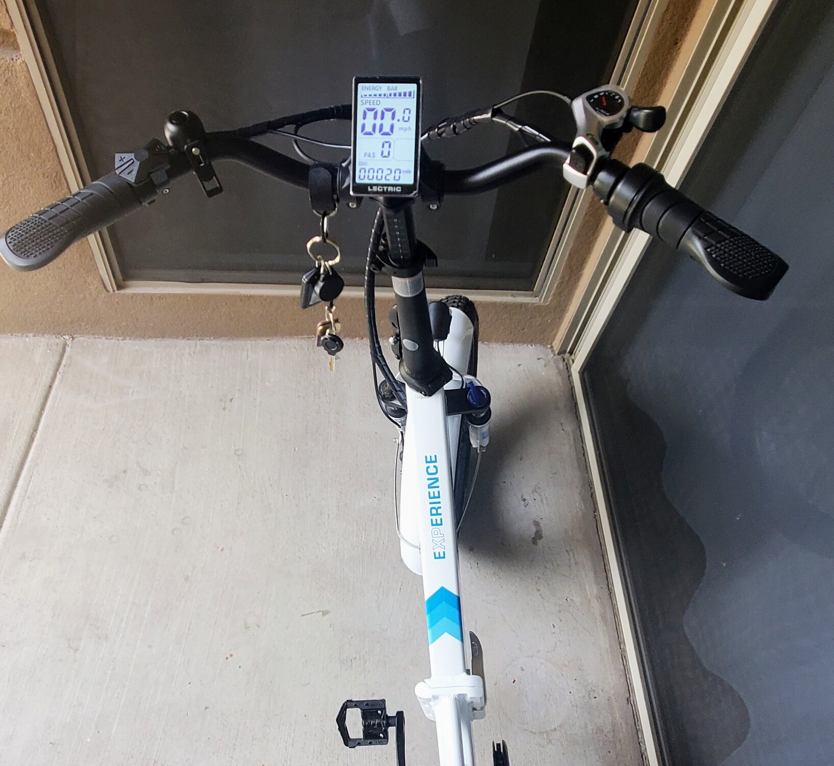

We purchased 2 Lectric bikes back in April 2022 after taking a test ride in PHX. I have the white step thru XP 2.0 and hubby has the the regular black XP 2.0.
I really didn't like the straight handlebar after the first home ride. It caused wrist pain and I felt like I was reaching forward. I broke my wrist back in October 2021 and my wrist can't be bent in that position. I ordered a 25 degree sweep-back handlebar from Amazon the next day. What a difference! I sit totally upright now and my wrists are loving this relaxed position. I also feel more in control with the new handlebar.
We swapped out the saddle for a gel Serfas that I had on my old bike.
The cockpit is still a little cramped for accessories so we ordered small black brass bells. A local bike shop had a water cage that matched the sky blue decals on the bike. Score! Plus a Polar water bottle.

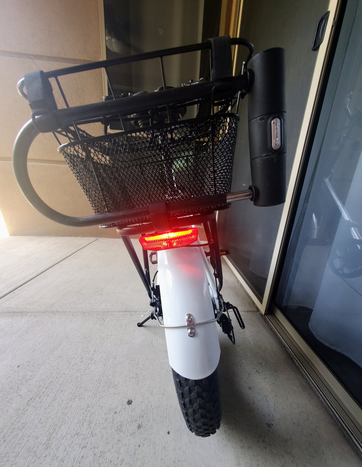

We are transportation riders, for errands and grocery runs. I got a market basket for the back.
The bike is heavy for me to move around. I am 5'6" and weigh 118 lbs. I am recovering from a total hip replacement. I have to make sure I take off with my good left leg since I have very little strength in the right. This is the first ebike I have owned with a throttle. We don't use the PAS that much since it is fairly flat in Phoenix. We like the throttle to get us across busy streets. I am sure I will use the PAS when we take longer trips but right now it is way too hot.
We plan on getting the Craftsman 50 gallon totes to store the bikes and to take them on trips.
The key position is awkward. I hope they change this in the future.
With the changes made I am enjoying the bike. I'll update info if needed.

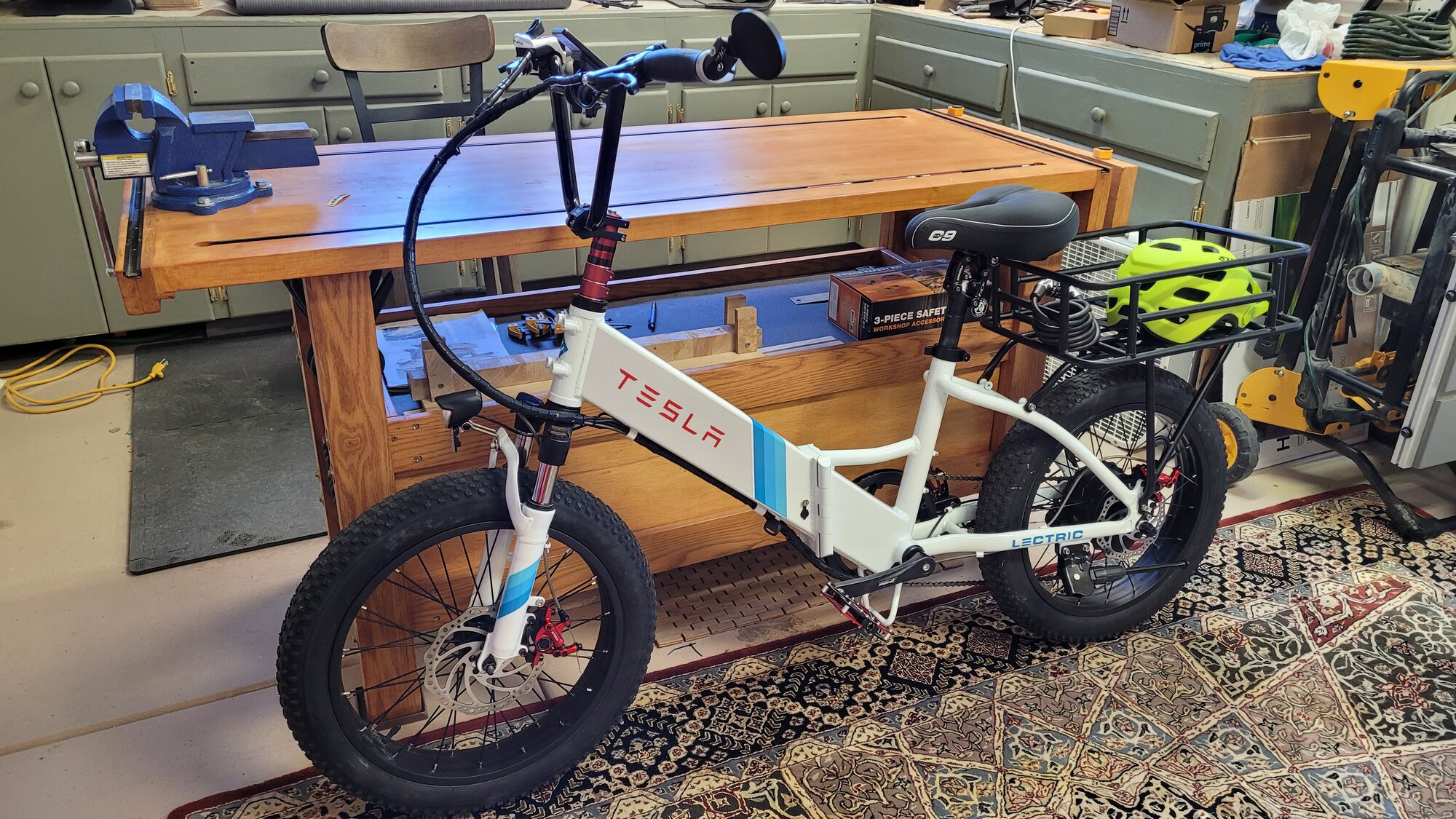

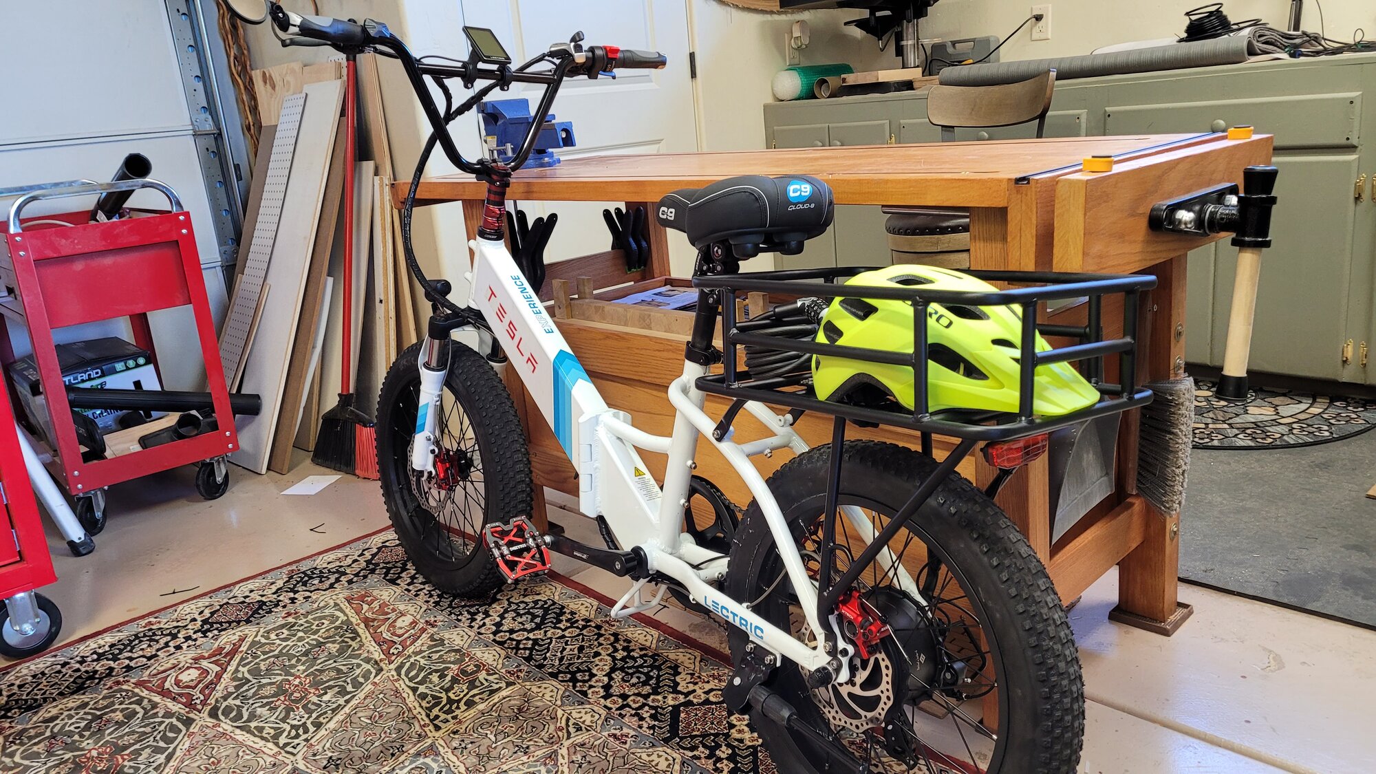

Here are pictures of my new Lectric XP 2.0 S/T and it's current upgrades, most from Amazon. I am 72, in good health (except for a 2 month old shoulder replacement that is healing well and use the ebike to get around town and the surrounding area here in Sedona, AZ.
I did the BMX handlebar (8.5" rise) upgrade with a stem, riser, extender (needed some alterations) and spacers with Ergon Rohloff grips, a bar end mirror and a 1859Northwest thumb throttle add-on to the existing throttle. Zero Xtech cable pull hydraulic brakes and new discs (180 front, 160 back with new Jagwire brake cables. C9 saddle and Suntour suspension seat post. 11x28 freewheel (I don't need a crawler gear for where/how I ride) and Orange Seal tire sealant. New pedals (non-folding). Lectric rear basket. Took off the heavy fenders (don't need them in Arizona. And white reflective vinyl side panels with a new Tesla decal for a whimsical flair. And it now has a red, white and blue colorway.
The bike is now perfect for me, it is more stable, more comfortable and stops better. I have some other, fancier brake discs that got here too late but will be installed soon. As the Army says, "Be all you can be!".

Have you found the trip odometer to be off? It is really messed up on my bike. I had to set the tire size in the computer (#f 6) to 26.5. My husbands wasn't as bad but he still had to change it.

Yup, setting wheel to 26.5 makes the speedo and odometer accurate. I think Lectric locked in some internal settings before someone discovered the error. But in any event, 26.5 makes things right.
I should also mention that in addition to turning the front stem around 180 degrees I also offset the stock handlebars with a 60mm extender that moved them slightly back forward. Flipping the stem made the handlebars just a bit TOO close to the saddle.
EDIT: Now, 26.5 way too much. Setting of 22 tracks Google maps accurately. Turns out 22 is the tire diameter. Dummy.

Can you post a link to the alarm you bought? Thanks.

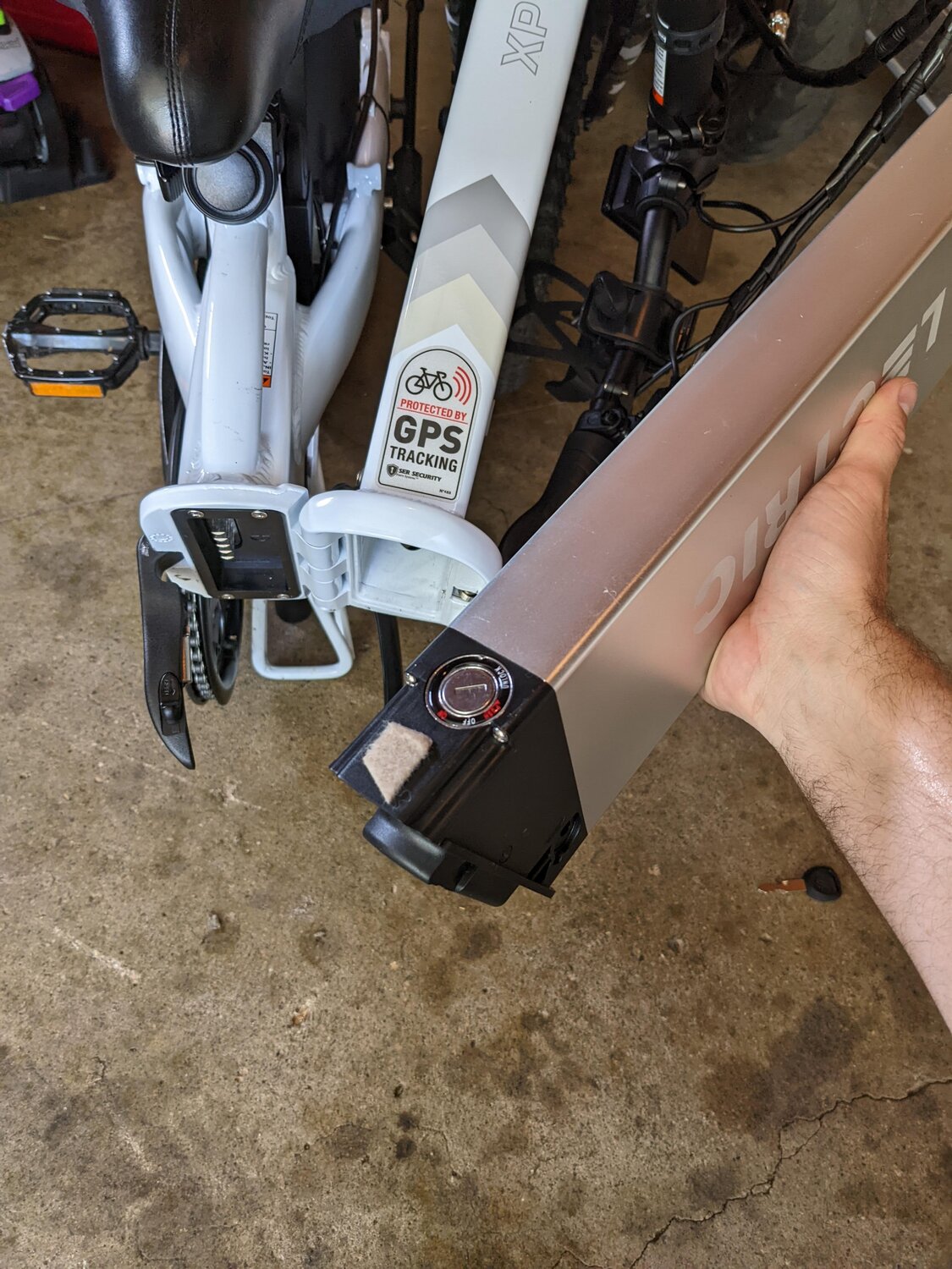

Have added a few accessories and little mods to the XP Lite after it arrived earlier this month. 1 easy mod was adding a little felt tape ahead of the battery key cylinder. This made it stop rattling or jarring over bumps and WAYYY easier to plug the charger port cap in. Check it out:
Hi Shelly. Like the handle bars you added. Can you tell me the name and model number of your handle bars that you bought on Amazon? Cheers!
Haven’t heard the rattle yet but if this fixes the issue with the plug then I will definitely make that mod. Thanks!
I couldnt ever find that rattle.. thought it was the Stem or in that area.. Sold the bikes either way..
