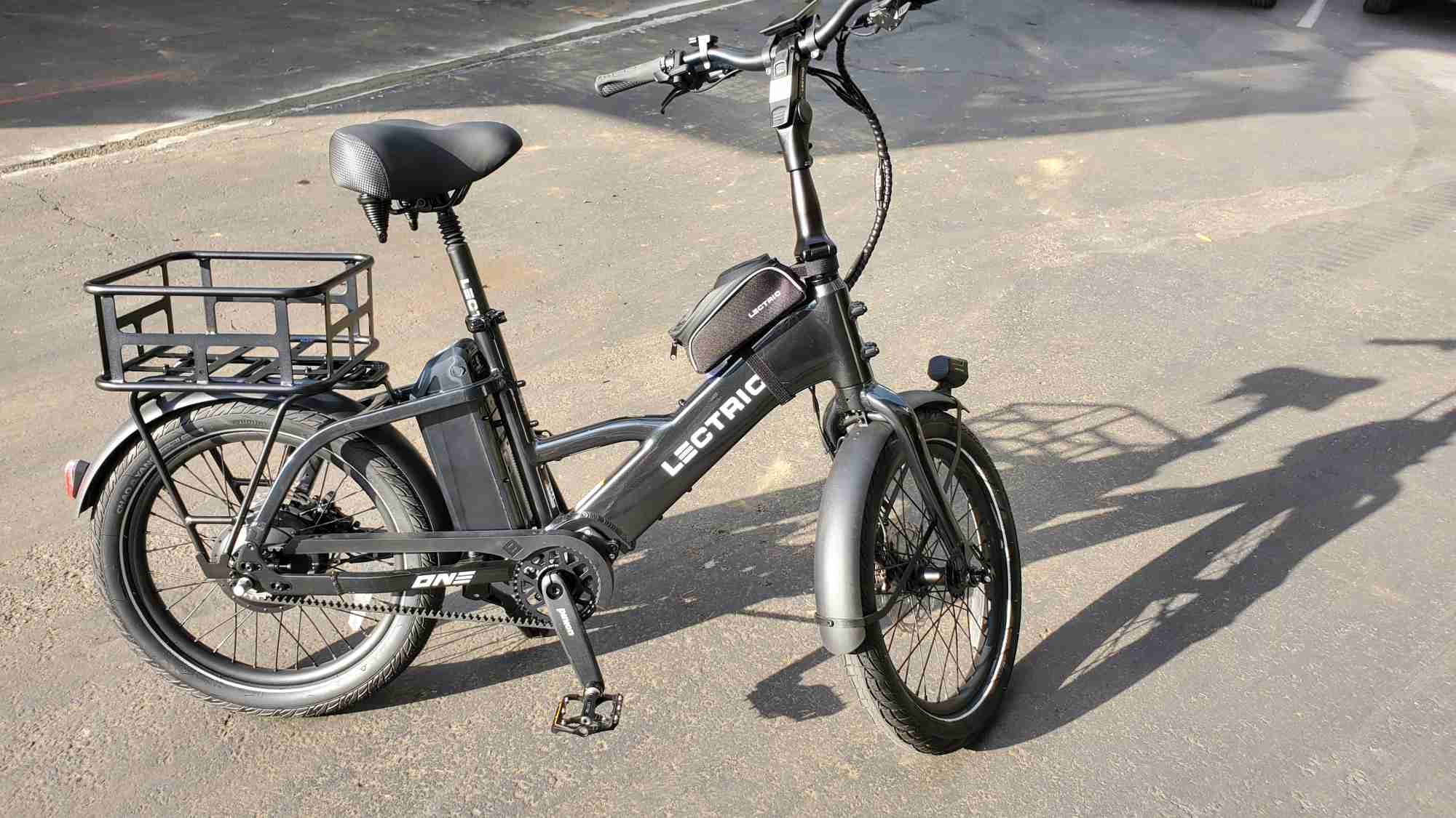

I got mine, It arrived a week ago (July 18). I really like it. Its got a huge amount of power. Its my first e-bike so I cannot compare it to other models but I live on a big hill and on level 5 it zooms up. I like the gear shift, you can shift at any speed, including at a standstill. There are some thing I would change though
There is no gear indicator so its sometimes difficult to know which bear you are in. The shift makes a "rrr" sound as is shifts, and it beeps when trying to shift down form the lowest or up from the highest gear, so you do get some indication.,
The standard seat is uncomfortable. I ordered the comfort seat with the bike, but I used the standard seat for the first couple of days, before switching to the comfort seat is which is much more comfortable.
It drains the battery very fast, I use pedal assist 3 most of the time. I got the long range model and it drains fast, if you are buying one, I would not recommend the standard battery. The manual says 35 miles on PAS 3 which sounds about right.
I bought the small basket to fit on the back rack, Its an ideal size to carry a few groceries. I also got the frame bag, which is handy for the bike lock, spare tube and inflater. The bag is only fixed to the bike with velcro straps, which looks untidy, I wish they used the bottle cage screws instead.,
I hope this does not sound like I dislike the bike, In fact I am having a great time with it, its good quality, handles well and is fun to ride. Please ask any questions you may have.
