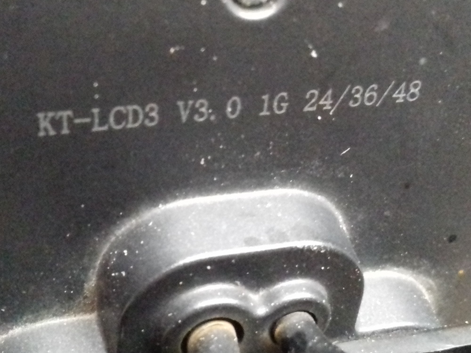

I have the above Screen / Display on my E Bike - the display will not stay turned on - I need to hold the On button for the screen to stay live. The button pad clicks as you would expect it to but the screen does not stay on and consequently I cannot scroll through the settings. I have disconnected and re-connected the waterproof connector - no joy. Any ides what I should do?
I did put a cable tie around it to hold the On button pressed this is the only way to get it to stay on. In riding the bike the other day without the Battery on board - the screen would come on when I was going at a certain speed - obviously getting power from the Motor - but go off again when I slowed down.
