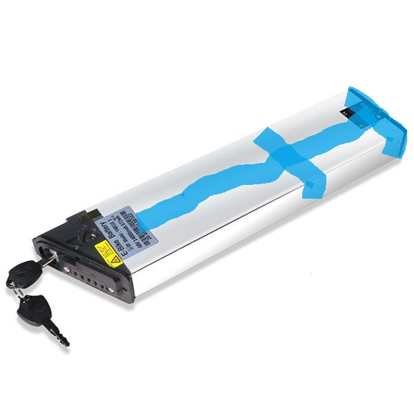

My battery rattles a lot when I hit any bumps, what have you all used to stop / damping the rattling of the battery?
what model x3 do you have?
according to the wallke website, they have since resolved the battery rattle issue and have some youtube videos attesting to that fact.
i wrapped my battery with painters tape.
rolled twice on the vertical and once horizontal
I figured out the rattle was coming from the controller. Trying to figure out what I can use as padding to help prevent the metal of the controller from rattling.

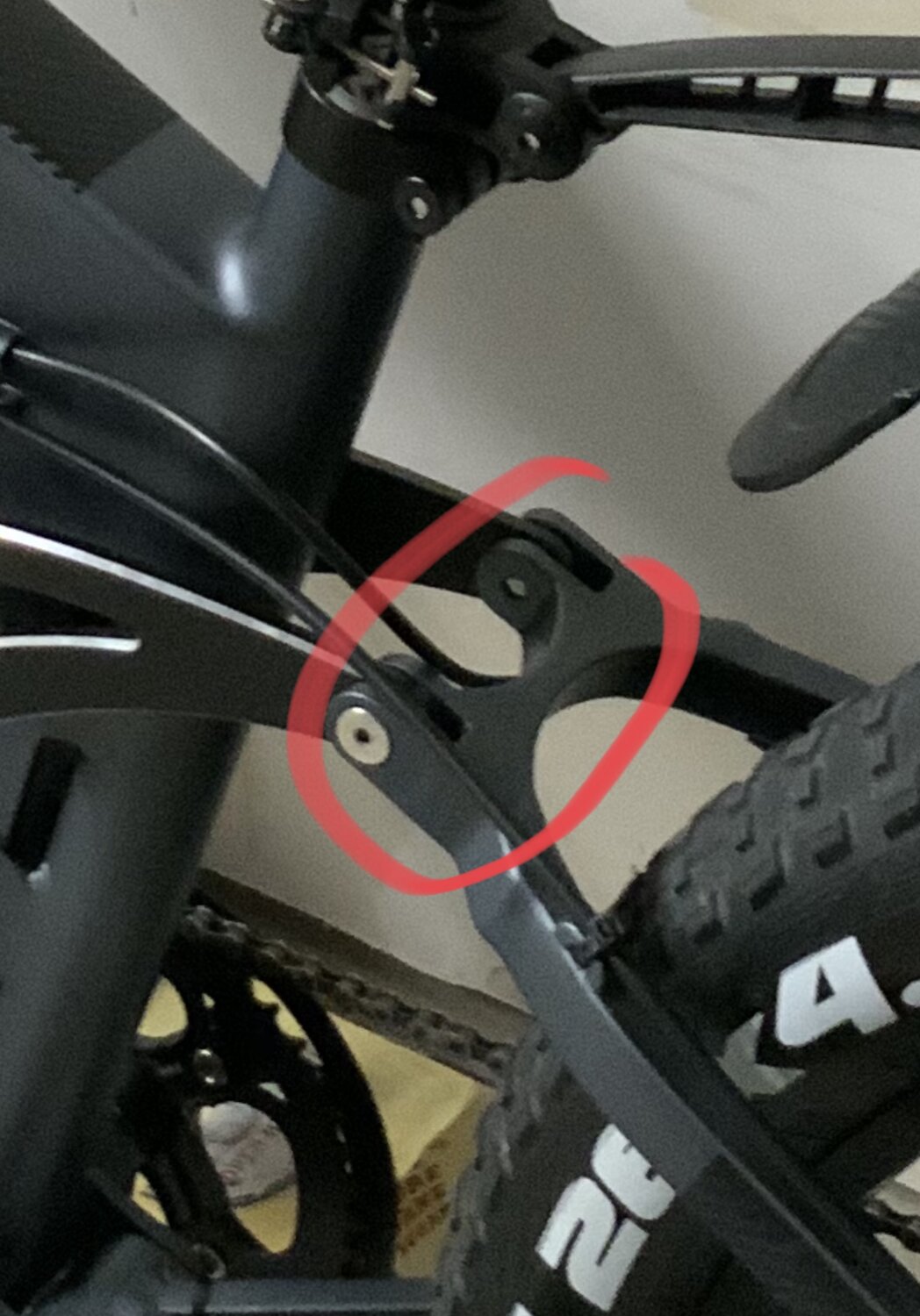

These 2 suspension arm bolts, when you lift the bike, they are moving up and down and rattling .. I ride the bike 90% pavement and 10% bike
I’ve tightened them but it’s still loose
The most frequent cause of loosening is side sliding of the nut or bolt head relative to the joint, resulting in relative motion occurring in the threads. Could you please send us a email about your issue? It is highly recommended that you attach videos to help our representatives quickly understand the details of your issue.
