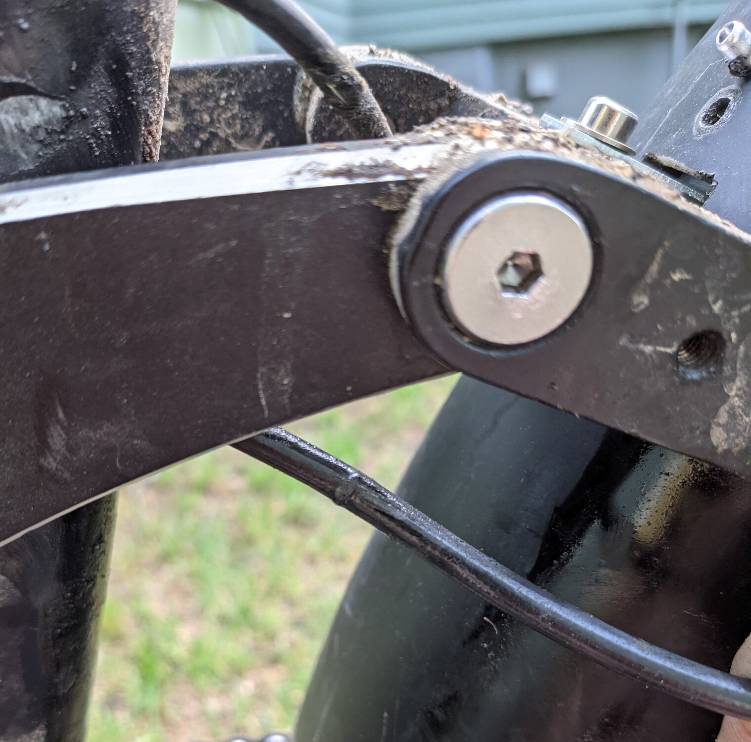

This might be an issue that some owners might not experience but, if your rear brake line runs underneath the rear suspension linkage, watch the line as the suspension pivots. My line developed a leak at a point where the suspension pivots and the line flexed in a wierd way. Wallke is sending me a new brake assembly but I am concerned this might happen again so I am thinking of ways to lessen the flex. You can see the crease in the picture. It seems the newer X3 Pro's run the brake line above the linkage and there is no flex.

can you route the brake lines above the suspension pivot?
Installed new rear brakes (thank you Wallke for sending them quickly - on my shipping dime) and rerouted the rear brake cable over the suspension linkage. Wrapped the cable with plastic tubing to help protect it and prevent the line from kinking. I think it will work. Not as pretty as before but secure.

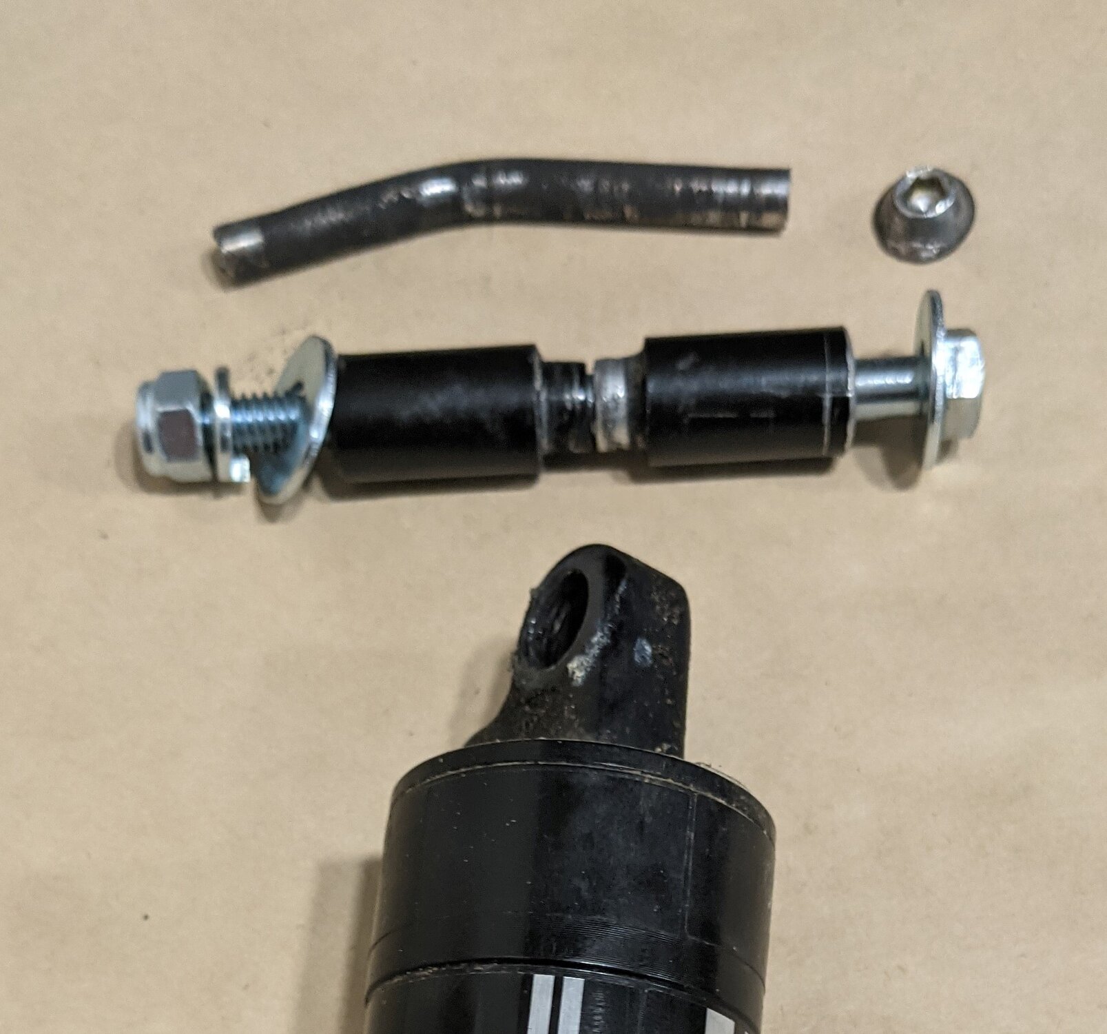

This feels too soon to be posting again... Check those linkage bolts on your rear suspension OFTEN! I hadnt recently and the picture below is the result - bolt fell out and the linkage rod bent and I had to cut it to get it free (top.) I think my hardware Frankenstein fix will work (center) but my bike is looking less and less cool with all these Mickey Mouse fixes. Build quality is really giving me pause or, I need a more durable bike for the type of riding I'm doing (mostly off road on reasonably tough terrain - or... maybe I can lose a little weight to help out...)
I do wonder if the ebike industry needs to look at the motorcycle rear suspension solution (swingarm and shock) and not to the bicycle industry (incredibly over-engineered multiple pivot point linkage systems) These E-bikes are way heavier and they go much faster (at least for me) so the stresses are different than on a pedal bicycle. I worry about all these pivot points and it bore out today and a also few weeks ago when my break line busted because of same crazy pivot points! I have my eye on the Splach Patriot Pro for a number of reasons but especially because the rear suspension is much simpler and more motorcycle than bicycle...
yes. Those bolts get loose after riding. I tighten them up before heading out. also, check your rear hub bolts, they tend to loosen up as well.

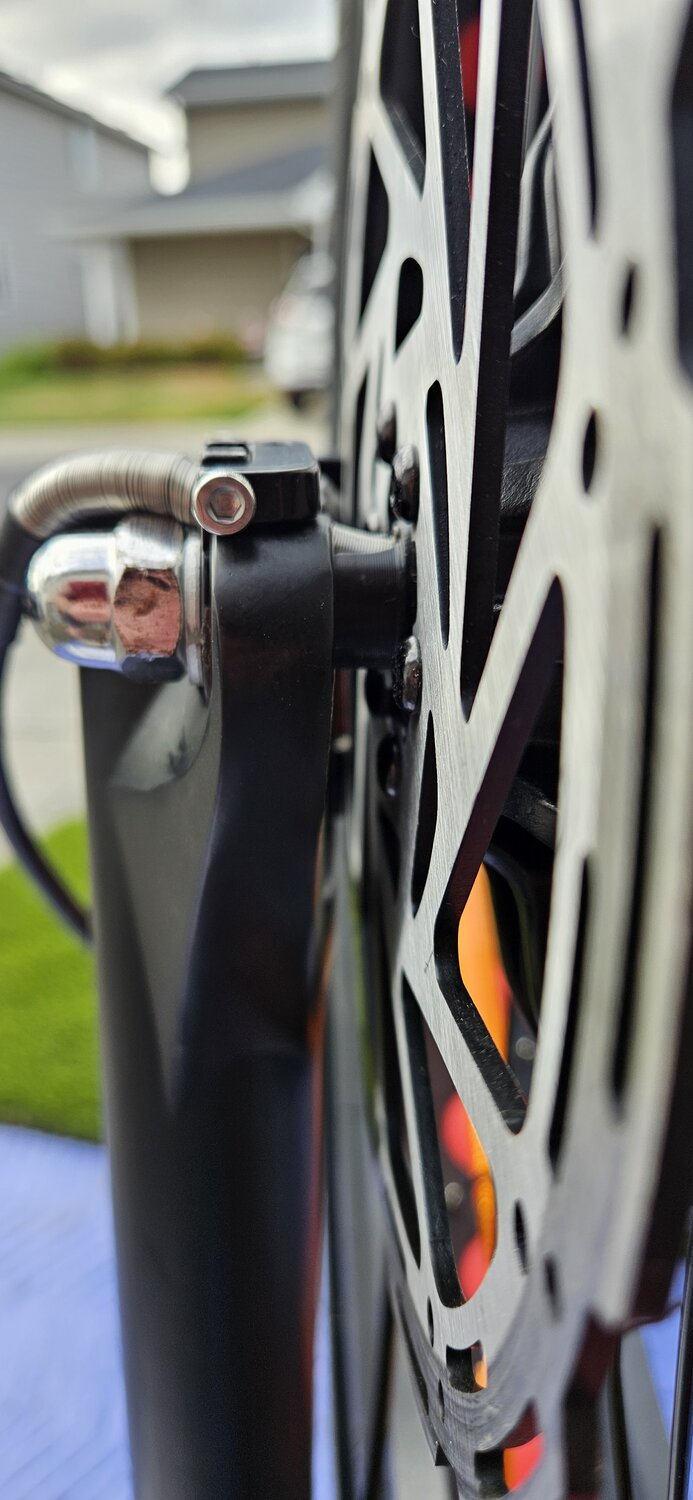

Hello all, Hoping that it is okay for me to revive this thread. I am stalled in assembly of an X3 Max. The front wheel is also powered on this version.
Has anyone here performed this assembly?
I do not have pictures with me right now so I am attempting to write the description. I apologize and appreciate any who are able to follow this.
The instructions in the manual and the video online indicate to use a flat washer inside the forks on both sides of the hub motor. My unit only came with one flat washer on the control wire side. I believe that the center shaft on this hub motor is larger than standard, The instructions say to use a 15mm wrench yet with this a 17mm is required. This is needed because the shaft has been hollowed out part way to be like a pocket screw to allow the wire set to settle into it. The wires from the motor about 1.5 inches out has a tightly coiled spring around it to protect the wires.
If I place the flat washer on the inside of the fork, the wire set ends up smashed onto that washer then trying to lay back down into the manufactured groove for it held down by what Wallke termed the anti-rotation washer. The shaft is not only grooved for the wire set, it is also milled on two sides allowing the "U" shaped anti-rotational washer to hold it into place. The "u" extends past the shaft with an open area where the wire set fits in and then a top cap to keep the wire set in place.
While trying to follow the instructions, I think I would risk damaging the control wire set forcing it over the flat washer then back into the anti-rotation washer. Additionally when I test fitted like this, the rotor seemed to be binding in the caliper.
I placed the washer on the outside of the fork and the whole installation seemed better. The rotor turned properly in the caliper, The control wires routed properly in a way that looked neutral and protected....
Do I ignore the manual and set it up the way that everything in me says is correct? I emailed Wallke with no response as of this time. What do you here think?
After over a week not hearing from Wallke, I re-sent the message adding questions about the serial numbers on my unit. I did get a reply including this about my decision to not have the washer on the inside:
"I then assembled the unit with the flat washer on the outside of the forks which eliminated both problems above. "
Well done! We have streamlined the installment, but the manual failed to get updated.

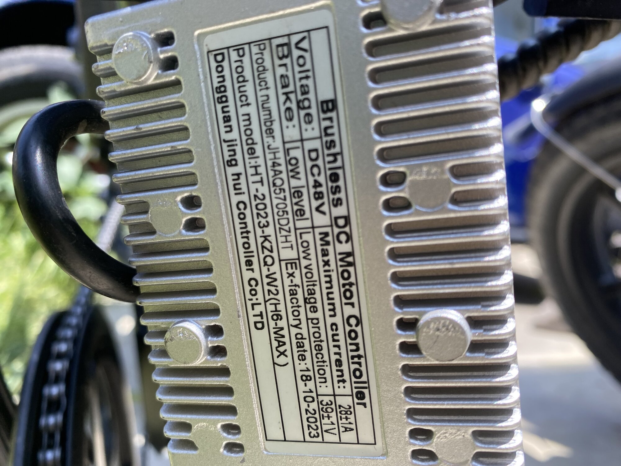

I have the h6 max and have blown two controllers does anyone know of a better brand of controller i can use even if it is an ome the one thing i can think of getting is a mid drive
