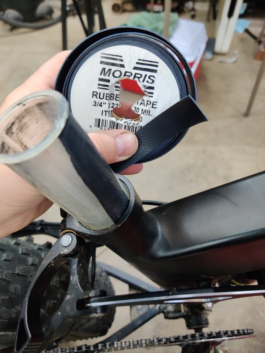

I had to find a thin strip of rubber and place it between the seatpost and plastic shim to get mine to stay.
Hey look on the bright side, at least your seatpost isnt getting scratched...:rolleyes:
Rizzo - how did you attach it? I hadn't thought of that
Correction: its between the shim and frame hole. Just ran out in the garage and snapped you a pic.
Rizzo - Thanks so much! I added 3 strips of rubber tap to the outside of the plastic shim and this finally worked! Now the bike seat stays in place - this has greatly improved the bike. Now I need to get 760mm or 780mm handlebars to open up the cockpit and improve the control over the bike. I rode for 12 miles today and the WPAS system really worked well. Only used 6% of the battery power, mainly stayed in level 1 - 33% power assist for most of the ride.

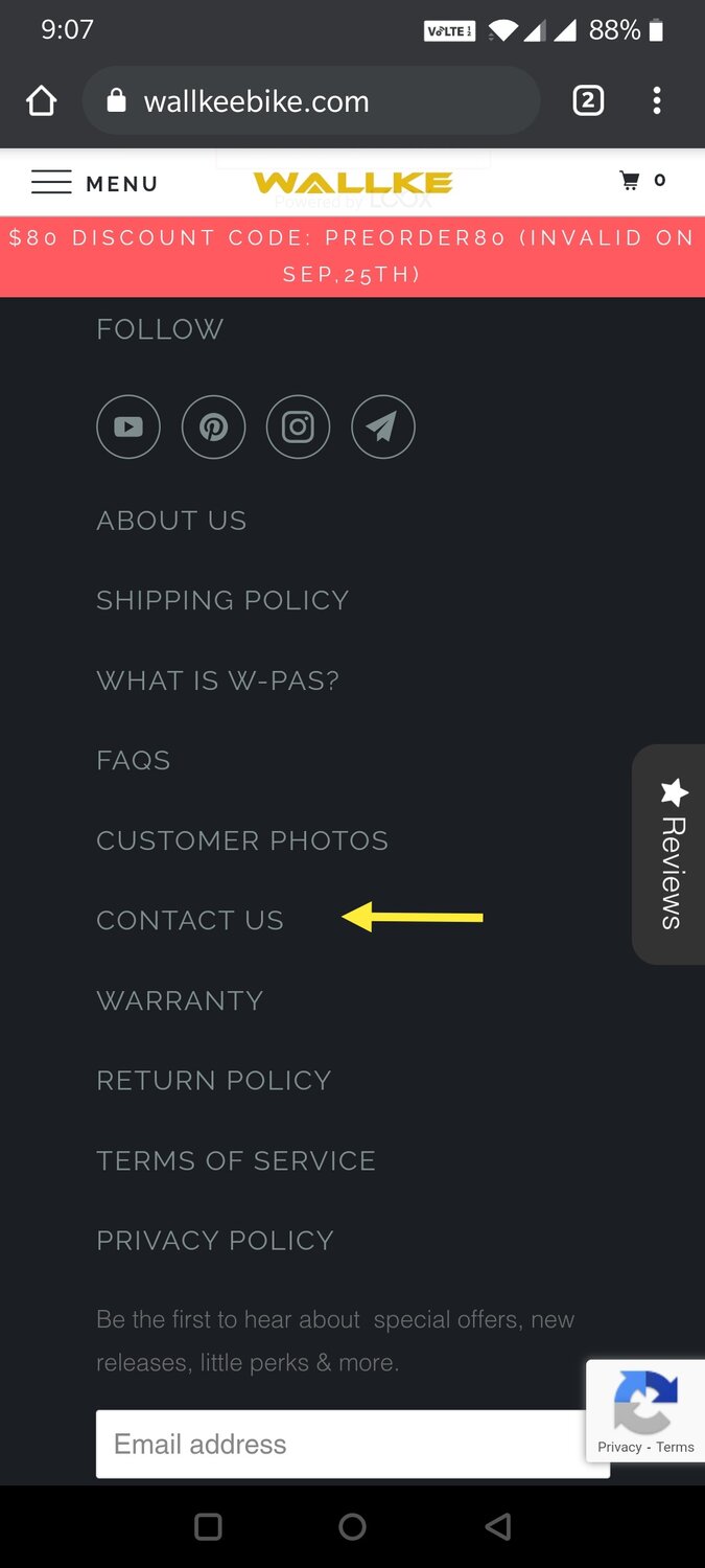

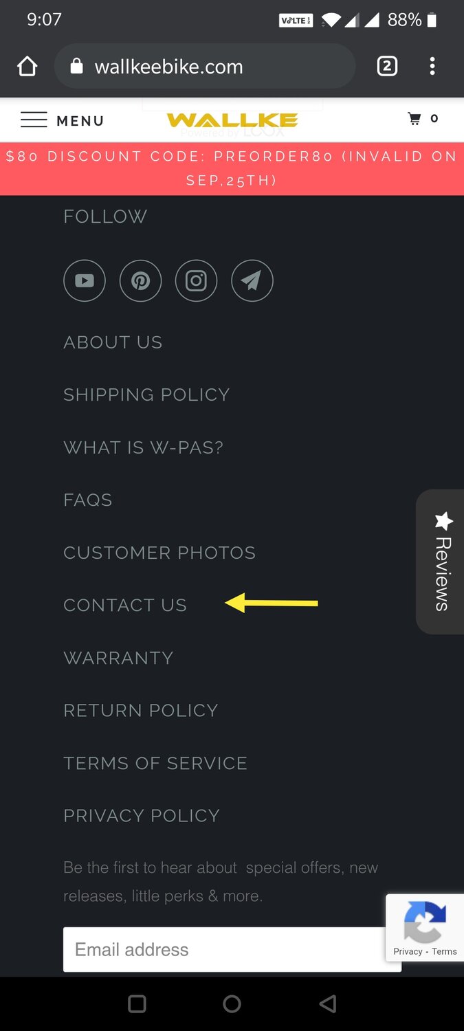

I used the "Contact US" link on the main website.

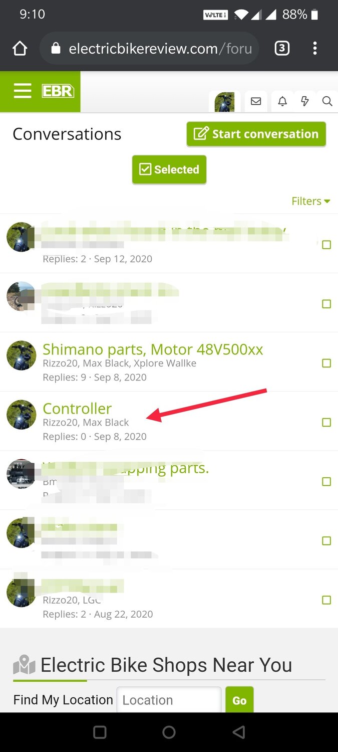

Ive also sent you a message on 9/8 here that you personally have ignored.
**Note** see the message just above it that you and I have conversed with 9 responses and you have sent me the a part I had and issue with. I am assuming since that method of communication worked once, we could rectify this problem as well.
