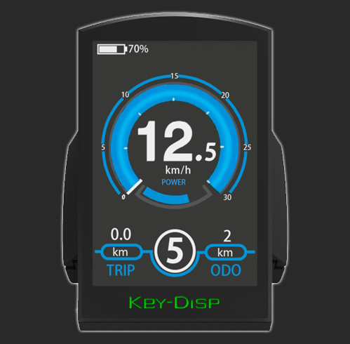

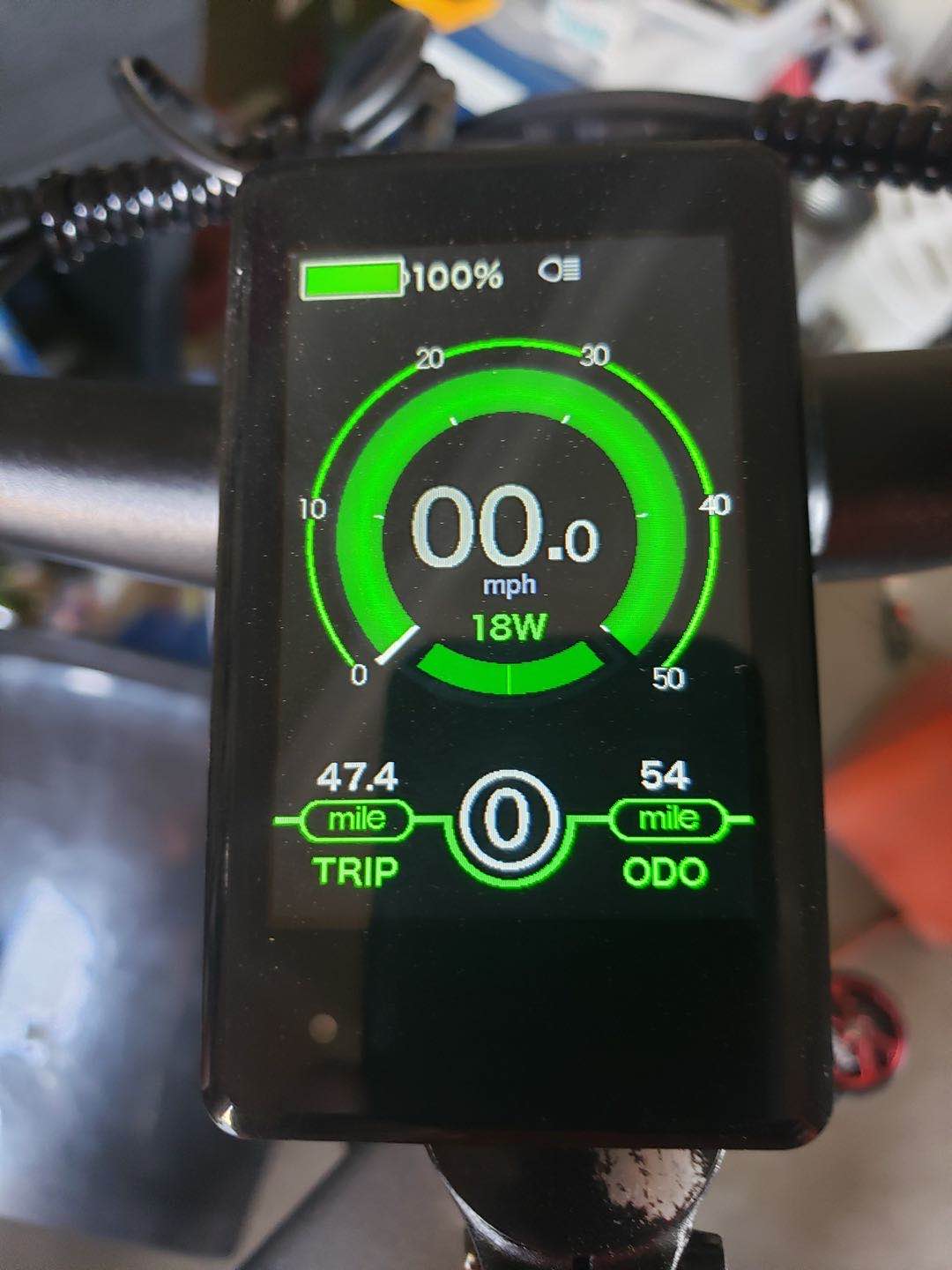

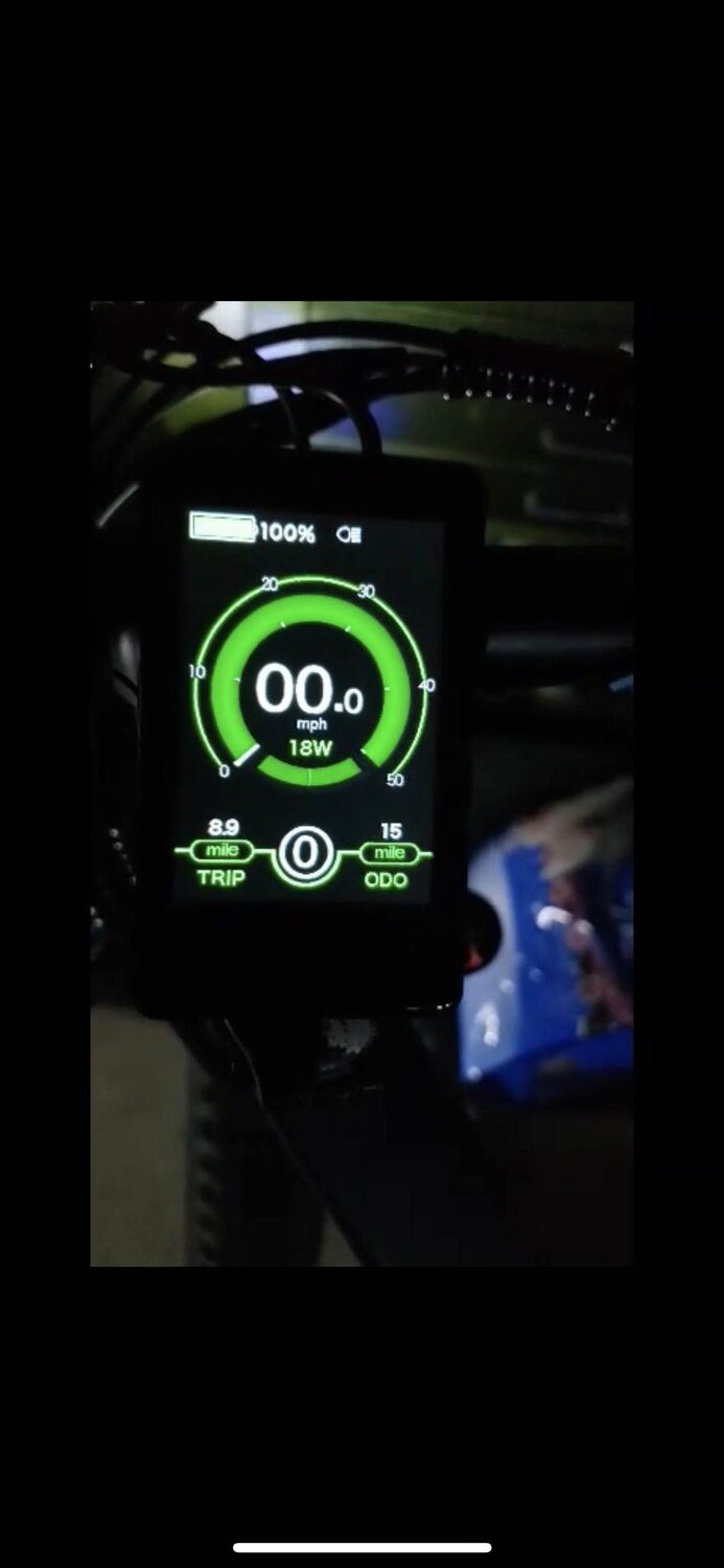

4) I have read the 28 inch setting is closer to the 4 inch fat tire that we have even though it is 26 in. You can compare with another gps mileage reader. It would be nice to adjust the advanced settings like some I have seen on another thread, perhaps an e-mail to the company can shed light on this.
Thanks for the reply. It really helps. I talked to customer service and they said that the setting lockout is by design, they don't want users changing the settings without consulting them first. The settings can be accessed by holding the "+" and "-" buttons while powering it on, you'll see an "ok" in the bottom right corner indicating it's ready to change the settings. Then save the new settings as normal.
