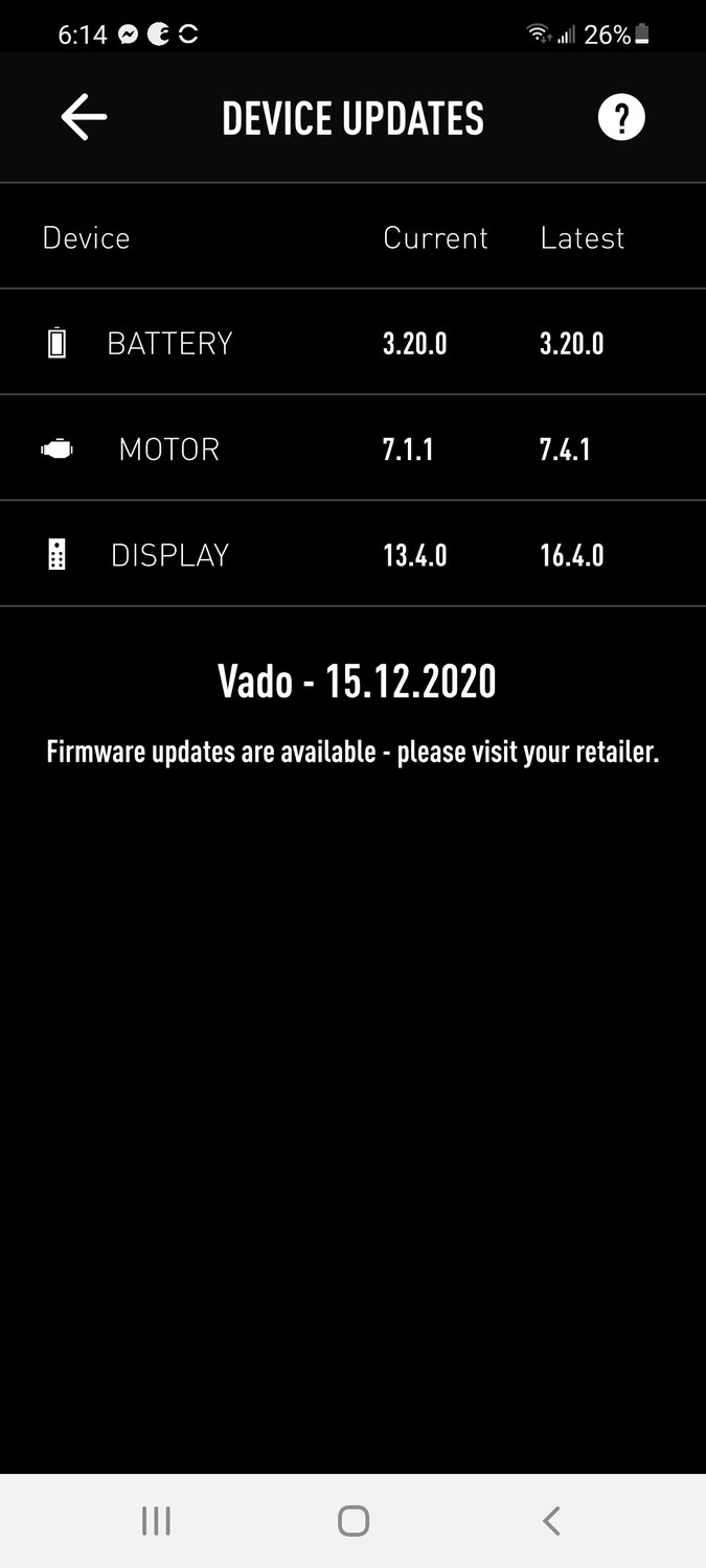

Hello,
I have a Specialized Como 3.0 2021, purchased in September of last year. It was marketed and sold to me by an LBS as class 3 (28mph) bike and it worked as such until that very same LBS performed a firmware upgrade last week which locked it down to 20mph. This is a completely different bike now and I'm supper unhappy. LBS washes their hands off and claims they can't do anything (no firmware downgrades possible). The original motor firmware was 7.1.1 and it was upgraded to 7.4.4. Opened a ticket with Specialized and still waiting on their input, not sure what else to do, I love everything about the bike but Specialized needs to get their act together, local dealers are clueless, feels like a severe lack of training and knowledge of the various product models, parts and capabilities - called a few and half claims 20/21 Comos 3.0 are class 3 bikes not class 1 (assuming, this is because they have them set up on the old firmware). Have I known, this was going to turn up as a class 1 bike down the road i would have gone for the 4.0 version. Anyone else with the similar issue ?
Also, my MC is still showing this as Vado post upgrade - shouldn't it say Como , WTF ??
Got my firmware upgrade at the dealers today, everything works good, can't really tell the difference.

Hello,
My recent Vado 3 firmware update message is 15.12.2020 for my June 6, 2019 purchase. Battery 3.3.4---3.3.4 Motor 5.4.0---7.1.1 Display F.4.0---16.4.0. Now, paranoid to get this update.
